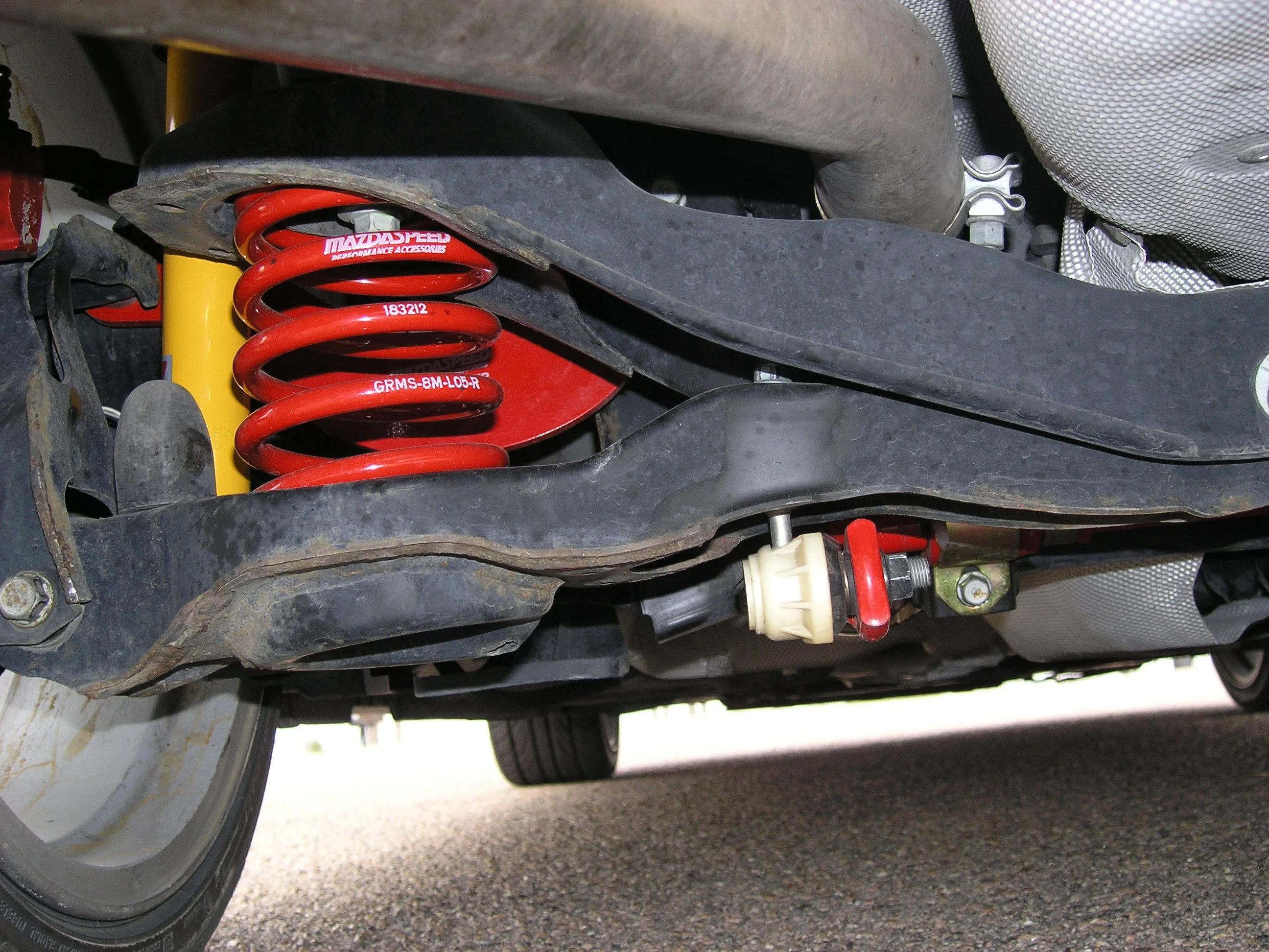

On my 2004 Mazda 3 5-door, I have the Koni Sports with Mazdaspeed lowering springs for the Mazda 3 and have my rears set to the softest setting and the fronts about 3/4 turn firmer and they're still firmer than the stock dampers. But not THAT harsh a ride, though!
FYI, I also have Racing Beat sways on the front and back (RB endlinks on front and OEM MS3 endlinks on back) and they are MUCH, MUCH stiffer than stock (232%)!! If you don't plan on autocrossing your 3 then I'd go with something smaller in diameter like the Eibach sways. Stock is 21mm for the front (I believe) and 20mm for the rear. The RB sways are 27mm each! Them things don't flex! VERY much fun on on-ramps(drive) but when pulling onto the street at an angle out of a parking lot I tend to ride on the very outside edges of my tires and lose traction because the sways won't flex (that and the springs are 30% stiffer too!).(hand) Don't care for that when I'm trying to get out in front of oncoming traffic!
Remember that changing the front sway is a B--I--T--C--H!! You have to disconnect almost the entire subframe under the engine to install it. Not a job for those that are mechanically challenged. Some shops charge a few hundred dollars to install it. In another Mazda 3 forum there is a "how to" thread on installing the front and rear sways. Might want to check that out first. Never fear, though the rear sway is easy!
Also remember to change your endlinks when you get stiffer sways. ESPECIALLY if you get the Racing Beat's. Their unwillingness to flex as easy as the stock sways will put a greater load on your endlinks possibly causing your stock ones to break (check out Ally's photo thread of her white 3 hatch).
Hope this helps you out a little! Good luck!

I replaced my OEM standard Mazda 3 endlinks with OEM MAZDASPEED 3 endlinks knowing that the OEM Mazdaspeed 3 sway was thicker in diameter than the standard 3 (but not as thick as the RB sways) hoping that they would do the trick. I wanted a smoother ride than with heim-jointed endlinks like the AWR adjustables. It's been said that the AWR's transfer more road harshness than an OEM type. So far no problems!
Yes, the second hole that you have to enlarge is on the strut. Don't worry though, the RB front endlinks come with the proper size drill bit and alignment tool. Easy!
I would put the new endlinks in when you install the new sways otherwise there's a very good chance that you'll probably break your stock ones. Especially with the Racing Beat sways.
