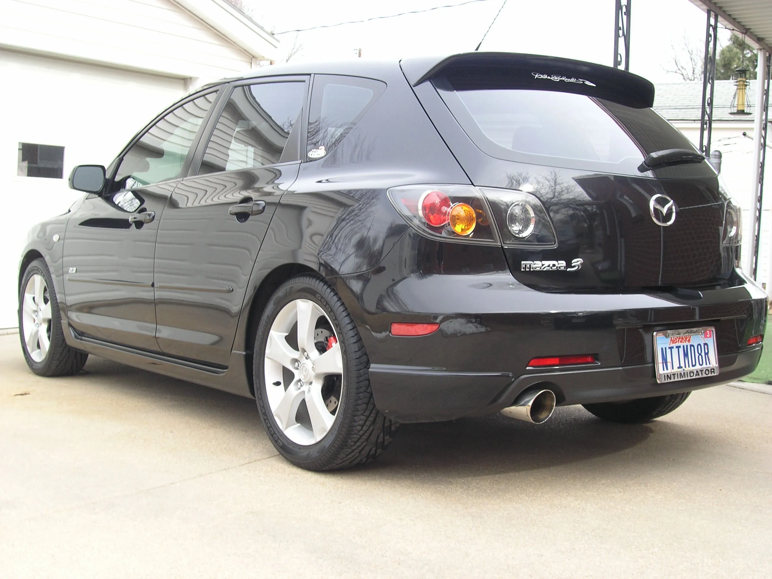

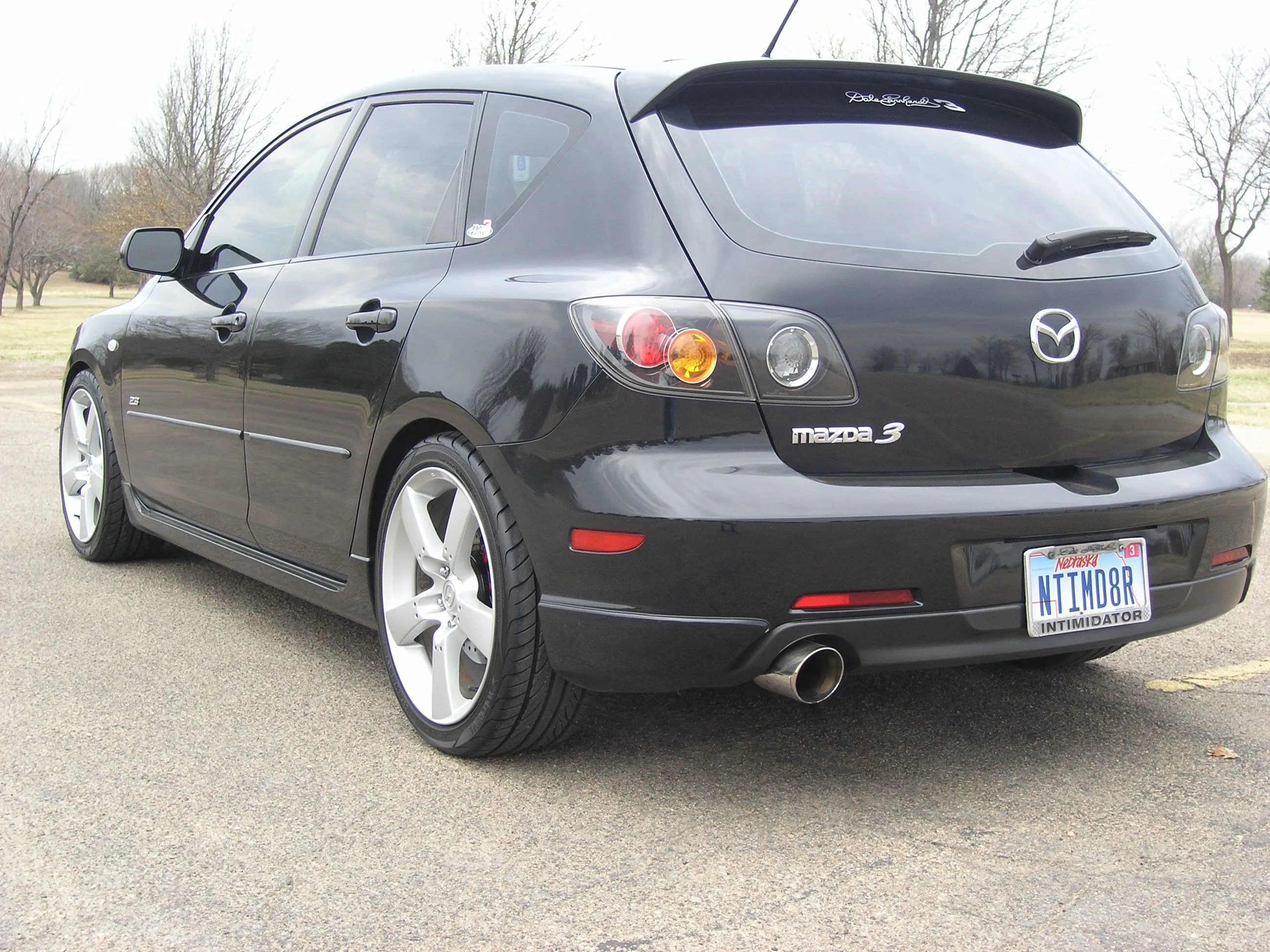

Attached pics: 1st (left)--winter tires and rims (before being lowered--Yeah, I know the rear tires are cupped!) 2nd (right)--summer tires and rims (after being lowered)

NTIMD8R the RX8 wheels look so sexy on a 3, they should have put them on stock. Which tires are cupped? And what caused it? Have you noticed any extra or uneven wear on the tires from the racing beat sways? The car looks great also.
I agree with you that the RX8 wheels should be stock on the 3! It's a pretty popular mod that many 3 owners on this forum have done.
The rear goodyears are cupped from not rotating the fronts to the back and the backs to the front as I should have done at regular intervals. You'll notice the dark and then the light tread on the inside of the rear tires in my first picture (click on the picture--once to bring it up, a second time to enlarge). This happened on stock suspension--before I changed everything. The all-season tires have yet to be installed on the lowered car.

Here's one of my favorite pics of my 3--just to show a better view of the RX-8 rims (not that you haven't seen them on a 3 before...)

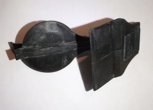

Well I just finished installing the racing beat swaybars tonight (late night, almost 1 in the morning). I have yet to drive with them on so I can't comment on that. Does anyone know where the item in the attached picture goes? It is just some plastic clip type thing, is it important, my dad was helping me with the install and he removed it, but doesn't remember where it came off.
Thanks for the help,
Josh
