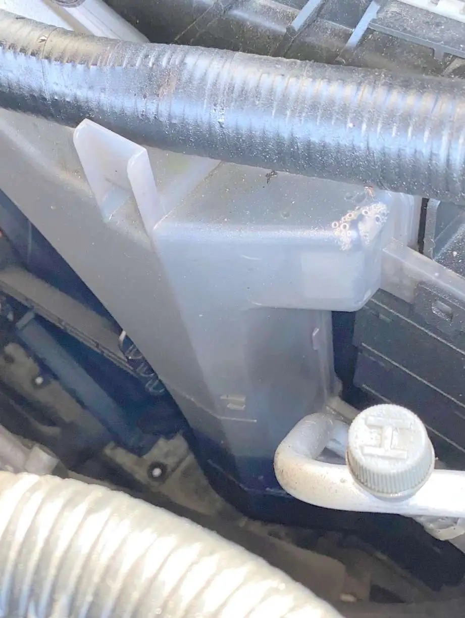

Update regarding coolant level in the reservoir. A week ago I filled it right to F after I discovered it was only an inch above L. Bought the coolant from dealer by the way. The two following days after topping up I checked and it was right at F. Fast forward to today, which is one week after, and it has been driven it 6 out of 7 days (no long drives) and it's already down 2 inches from F. In the pic below you can see an F and the line. The darker colour 2 inches below is the coolant of course.

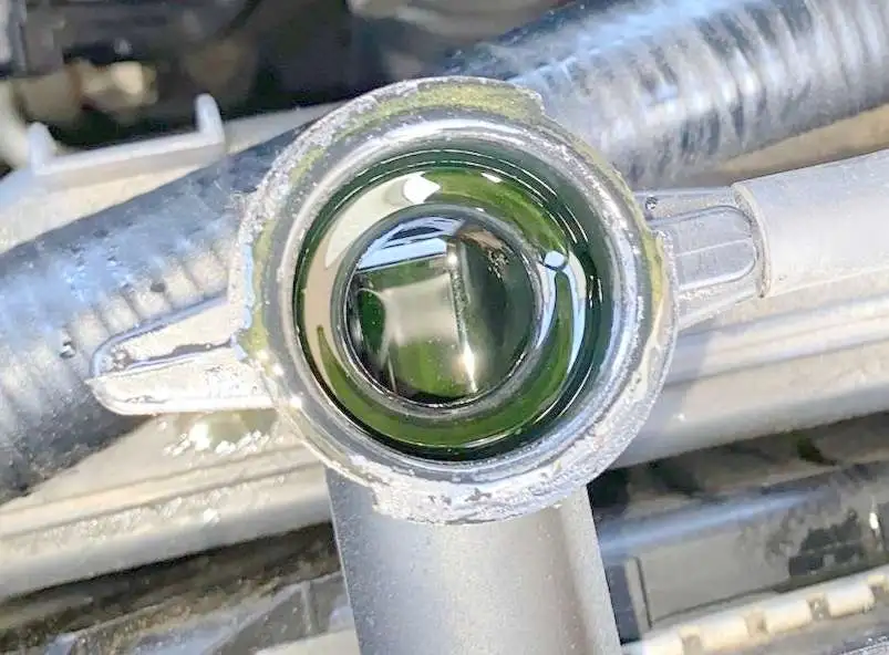

I have opened the radiator cap and coolant looks like a healthy green as it was dripping from the cap and it's right up to the top of the rad itself.
No signs of overheating by the way, since the heating issue started.

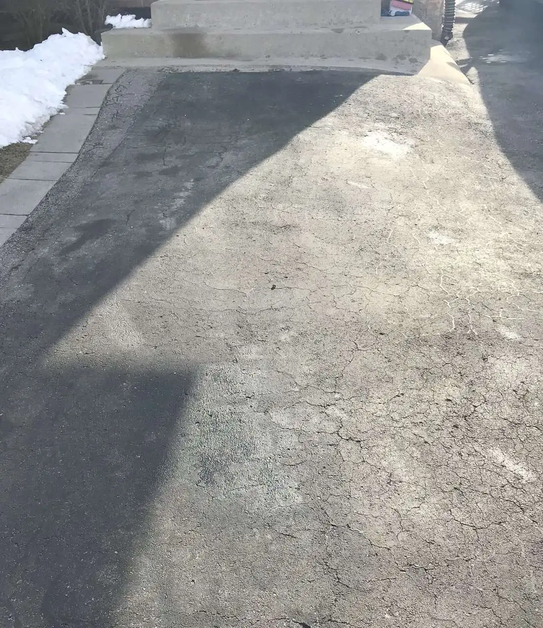

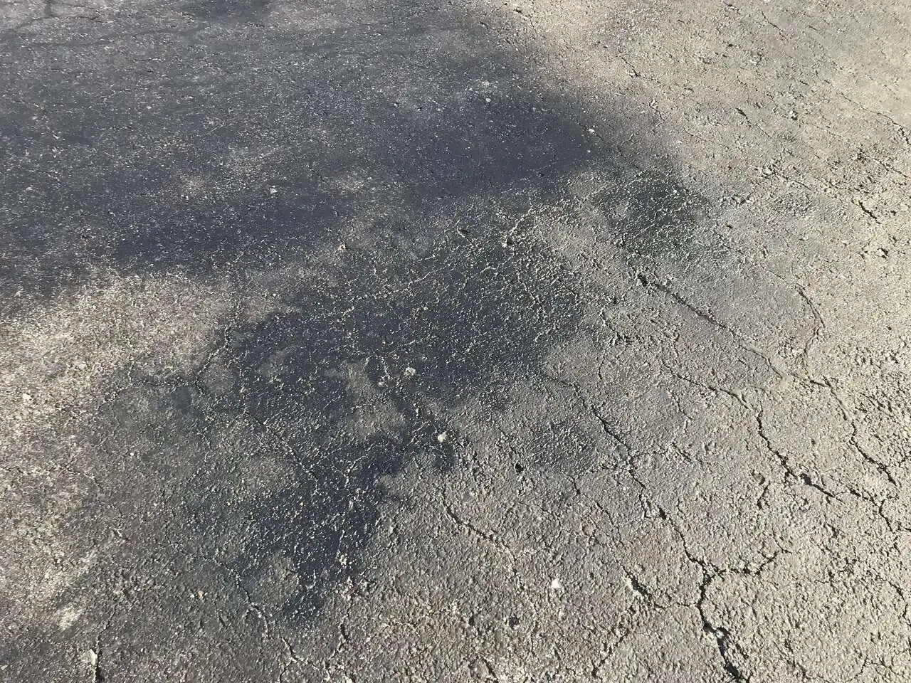

Edit: Just checked for leaks on my driveway and it's hard to tell. I usually reverse the car and park in front of those steps. So that leak spot you see, near the bottom of the pic, is probably where the coolant reservoir would be. And it kind of looks fresher than any other leaks on the driveway. However, shined a flashlight down below the reservoir and I don't see any evidence of leaking onto a tray that then leaks onto the ground.
Last night I parked it on the other side and forward, meaning the engine bay was slightly inclined as opposed to usually being on a decline but I do indeed see what could be a fresh leak. However, I also did have a 15 year old Fusion that had some leaks and that's where I used to park it until May 2021. And the previous house owner parked his work van there so there's all kinds of old leaks in that spot. I think I will drop some carboard underneath now and see if catches any fluid.
As well, I had rust proofing done on both cars early January so it dripped grease everywhere. Plus, after being below freezing for a few days, it's been above since the morning so there's snow melt going on.

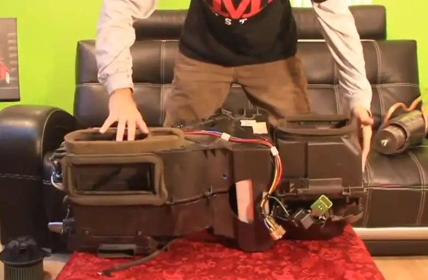

Here's a pic of a heater box pulled out of some car. I get that those three brown things are the doors that open up to direct air to dash or defrost or floor. But is there any way to view those without pulling stuff out?

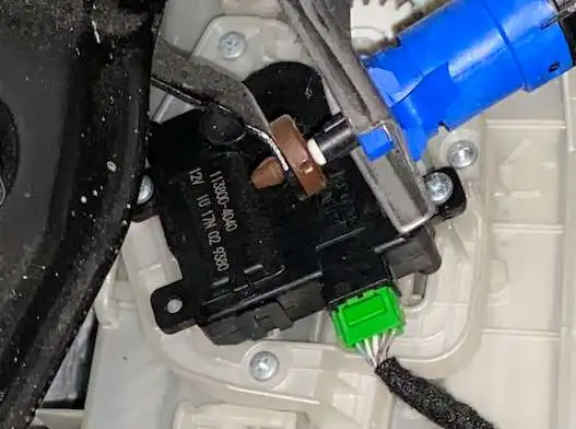

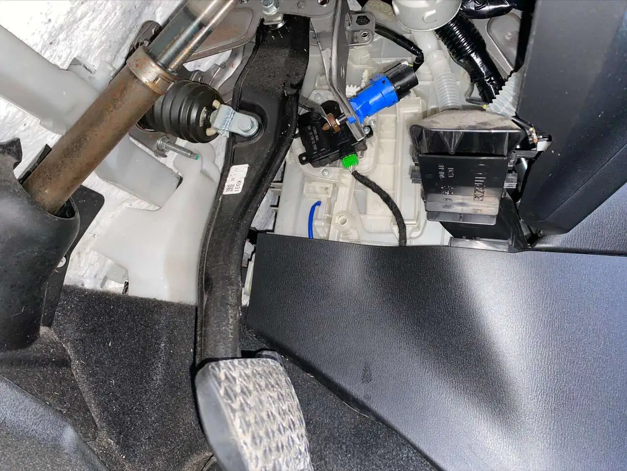

Also put a pic of where the actuator is (with green wire harness) on driver's side.

When the actuators are operating you will see the levers and linkages move. Those parts are external and visible. Keep the fan on low and you may be able to hear them as well.

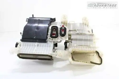

Look at this picture, it's an ebay listing for a Mazda CX9 hvac box. It may not be identical given that it could be from an earlier year but should be similar to yours. You can see two actuators in the middle and one off to the left. I'm not sure exactly which is which but perhaps the one off on it's own to the left regulates the temperature. When changing settings for direction and temperature you should be able to figure out which is which.
I really don't even like to mention this, but there's a well-known, systemic cracking issue with the cylinder head on a number of Skyactiv Turbo model years, including yours. And (again not happy to say) what you described above sounds a lot like the air self-purging process that these vehicles automatically do. Of course, I certainly hope that's not the issue with your vehicle, and that it actually turns out to be a much less severe and less costly repair!

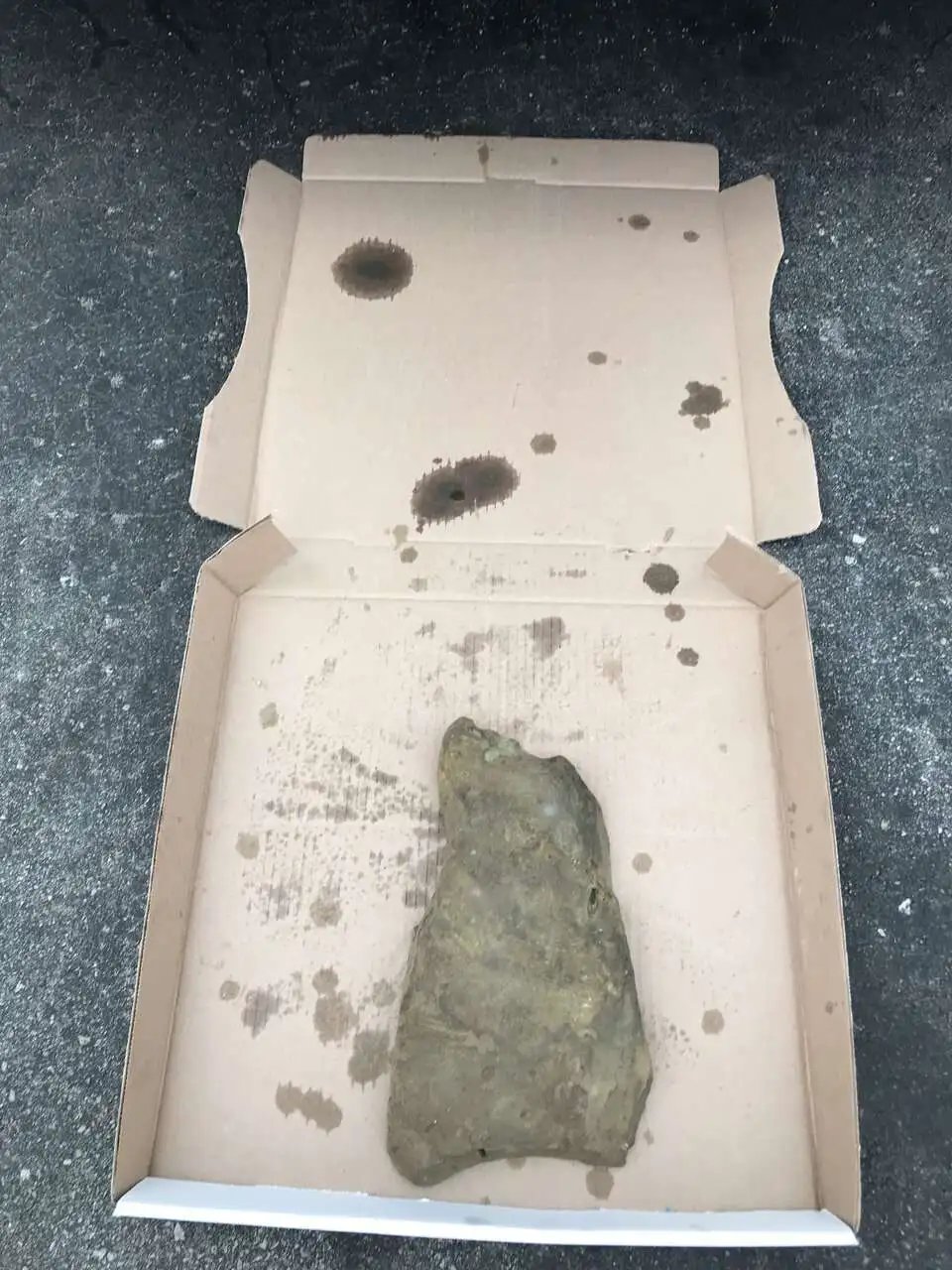

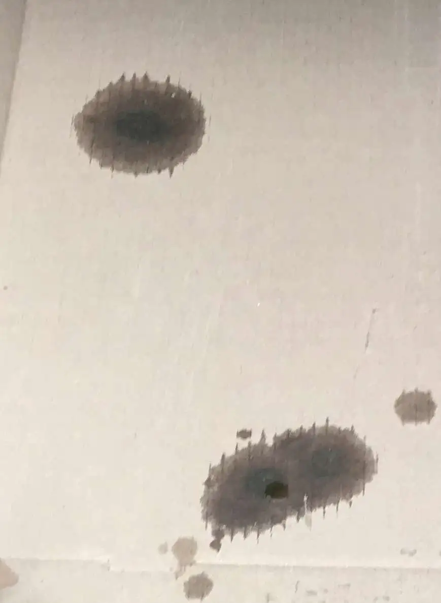

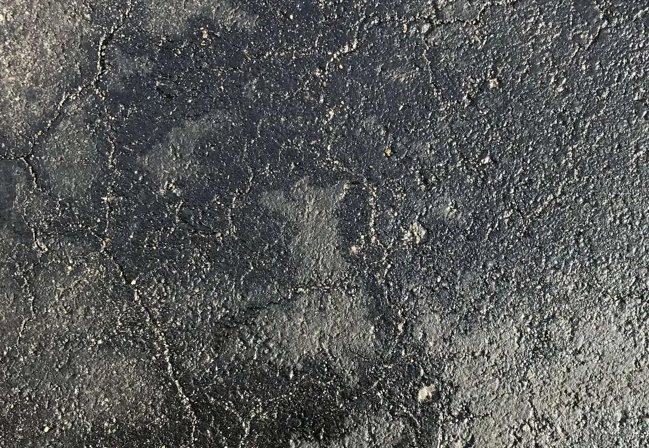

In regard to the coolant leak, I left a pizza box under the car for 36 hours (didn't drive during that time) and the dark spots are new. The lighter spots are just pizza grease. So basically the top half of the box.
Didn't overfill the coolant last weekend when we did the top up. The only dripping that occurred was when I took the rad cap off and then put back. Just a couple tiny drops. Those could have settled on a tray underneath and then when I moved the car to reverse it into my driveway and put the box under, they could have dripped down onto the box but this seems like more than that.
And it's not the rust proofing that was done first week of January. You can see this is green.
So looks like a leak is confirmed. Losing two inches from the reservoir after a week from topping up seems like a lot. Those drips in the pic are from the car sitting there for 36 hours. If I were driving it, would there be more leaking while I'm driving it, because the radiator would be in use?
