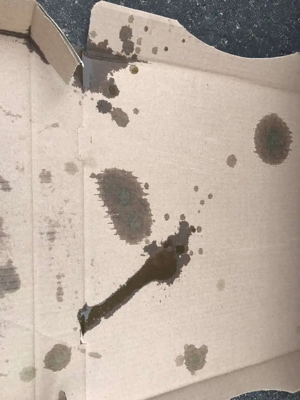

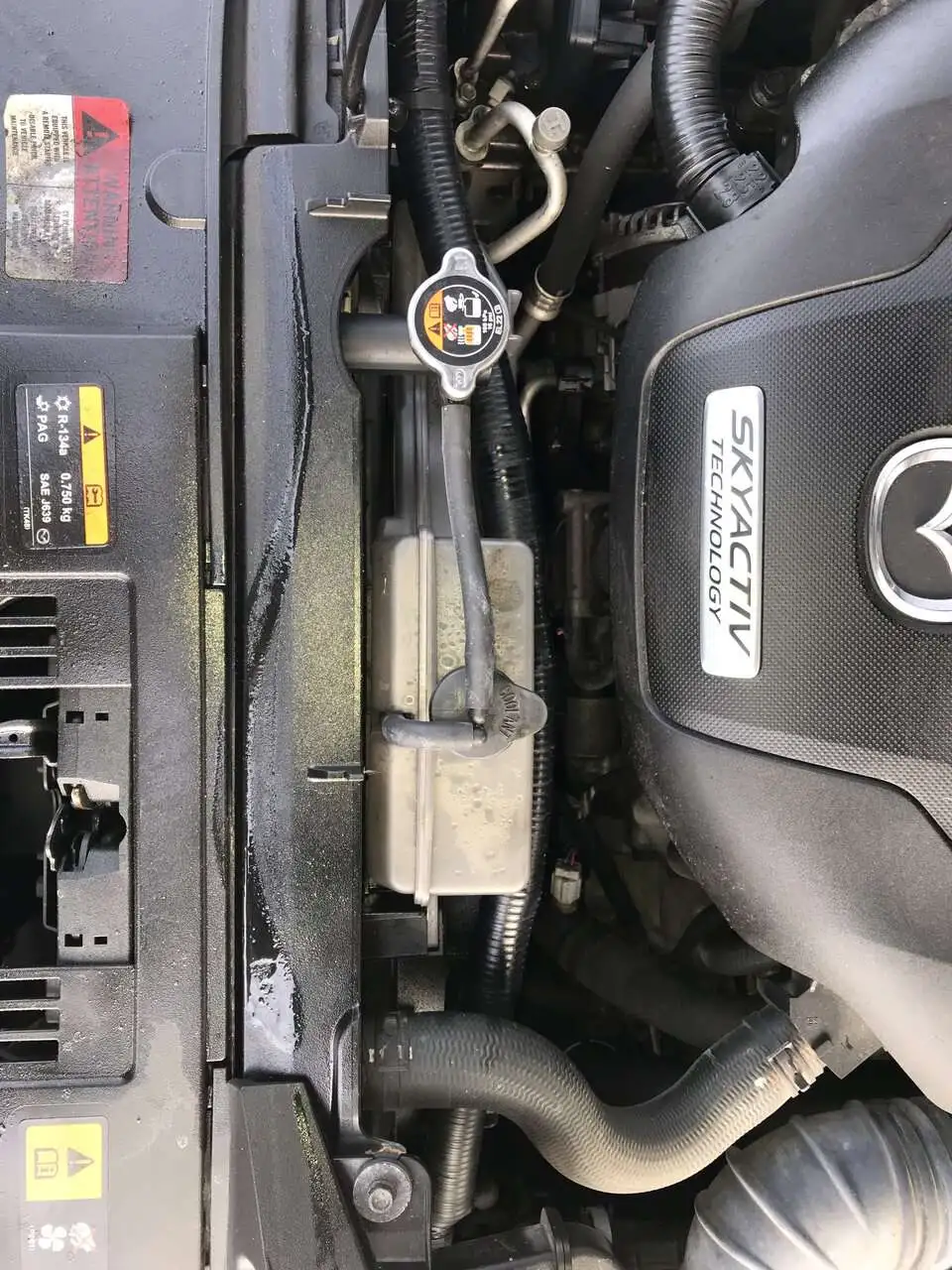

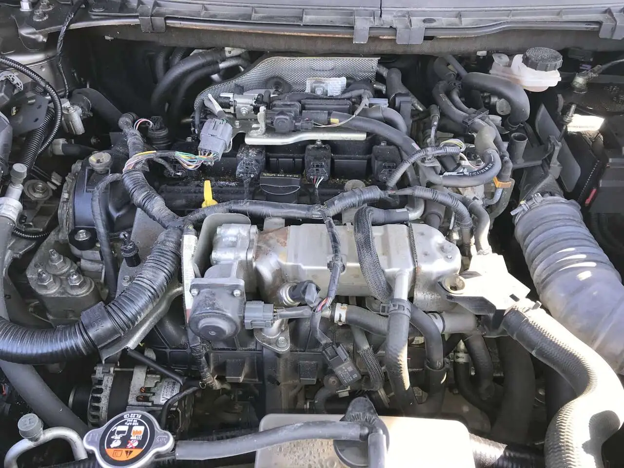

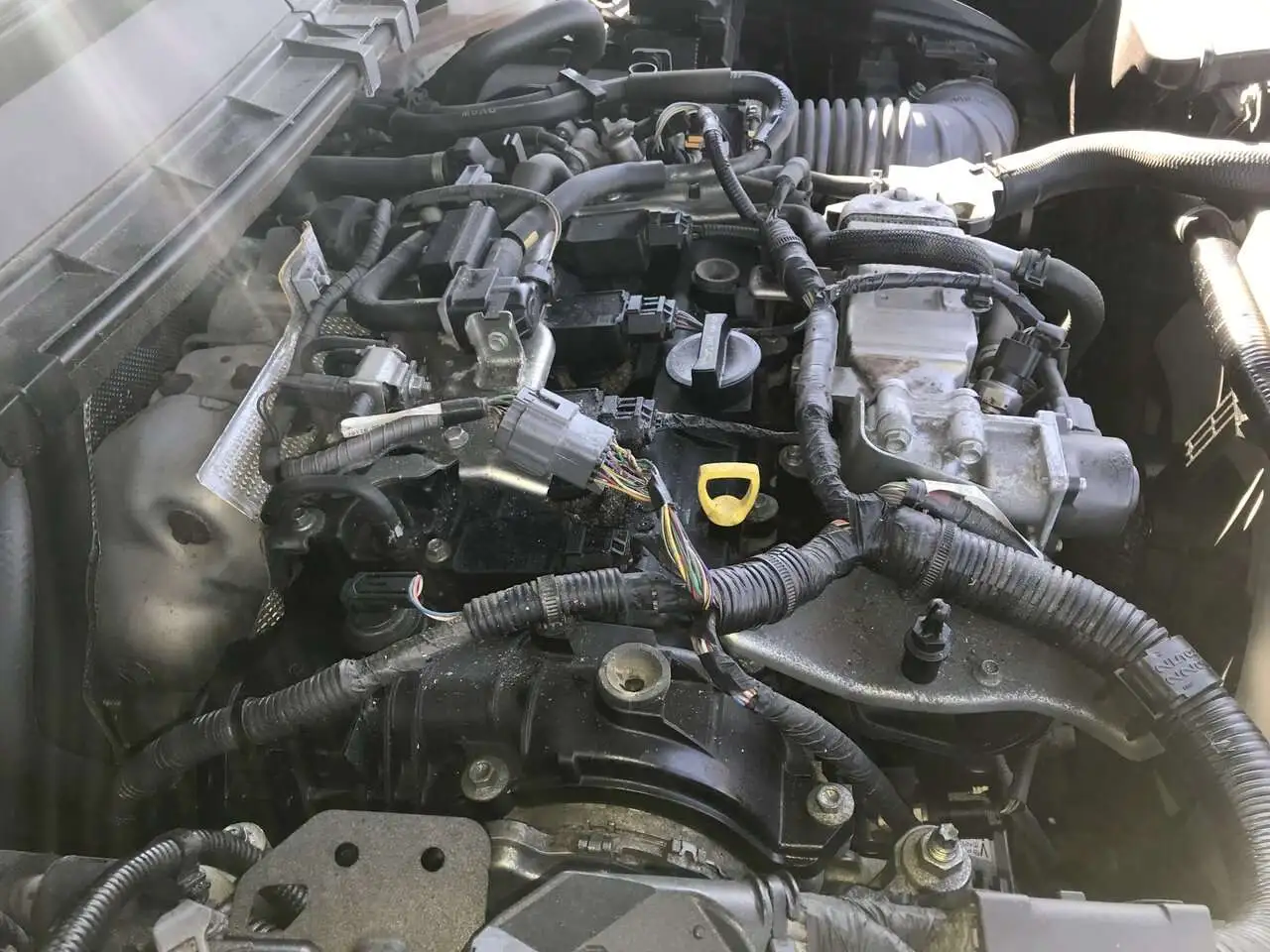

Update: I made sure heat was off, remoted started and left it, which is 10 or 15 minutes. Checked the hoses ands temps were 40 C (104 F) for inlet and 37.7 C (100 F) for outlet. Takes a little bit of time for my meat thermometer to climb up to the temp so I have to leave it for about 90 seconds on each hose. When I re-did the inlet after doing the outlet, it came in at 37.9 C. So based on that diagnosis, seems like the heater core is not plugged.
But, as you can see in the pic, more coolant just dropped out after letting the car run. So that means it's defnitely dumping more coolant when car is running. Just don't know where it's coming from. There's no fresh fluid seen on the tray under the rad. I'd guess it's further up towards the cabin by 6-12 inches.

Very sorry to say, but that looks bad. No warranty left I presume?
1st thing to do is make sure its not also getting into your engine. Do an oil change, check the oil and also send a sample in for UOA analysis. Hopefully it's just an external leak. Then try to locate the leak. If you cant find it, just get it into your mechanic at this point.

But, did you check the coolant level before starting it? At this point and leaking the fluid your leaking, you really should be in/near the vehicle and watching the thermostat until you get it to the mechanic.
It might be the battery.
Yeah, I checked the coolant level after remote starting this morning. Basically the same as on Sunday, two inches below F. The last pic I took of that cardboard is after that remote start. So a little bit more came out then. And I did check it like 3 hours after that and it was the same. It leaks basically when the car is running. I just checked the cardboard now, after running the heat (without starting car) a few times in the past hour while looking at the actuators and there's no new drops of coolant.
And yeah, definitely going to mechanic due to that leak. I'm wondering if it's leaking at the thermostat housing. Don't know where it is on this vehicle but I saw that on a YT video from some other car.

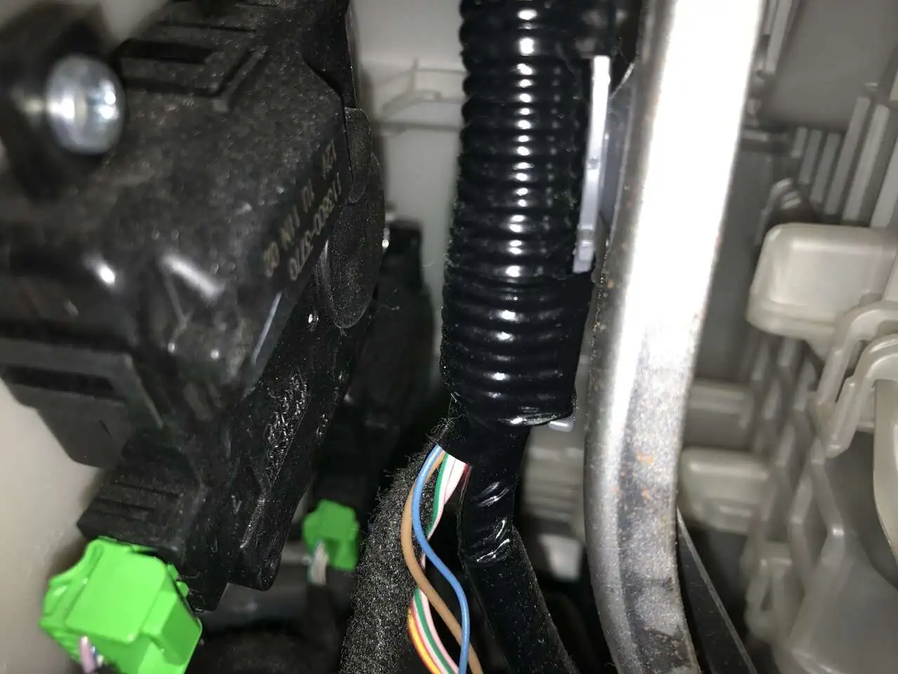

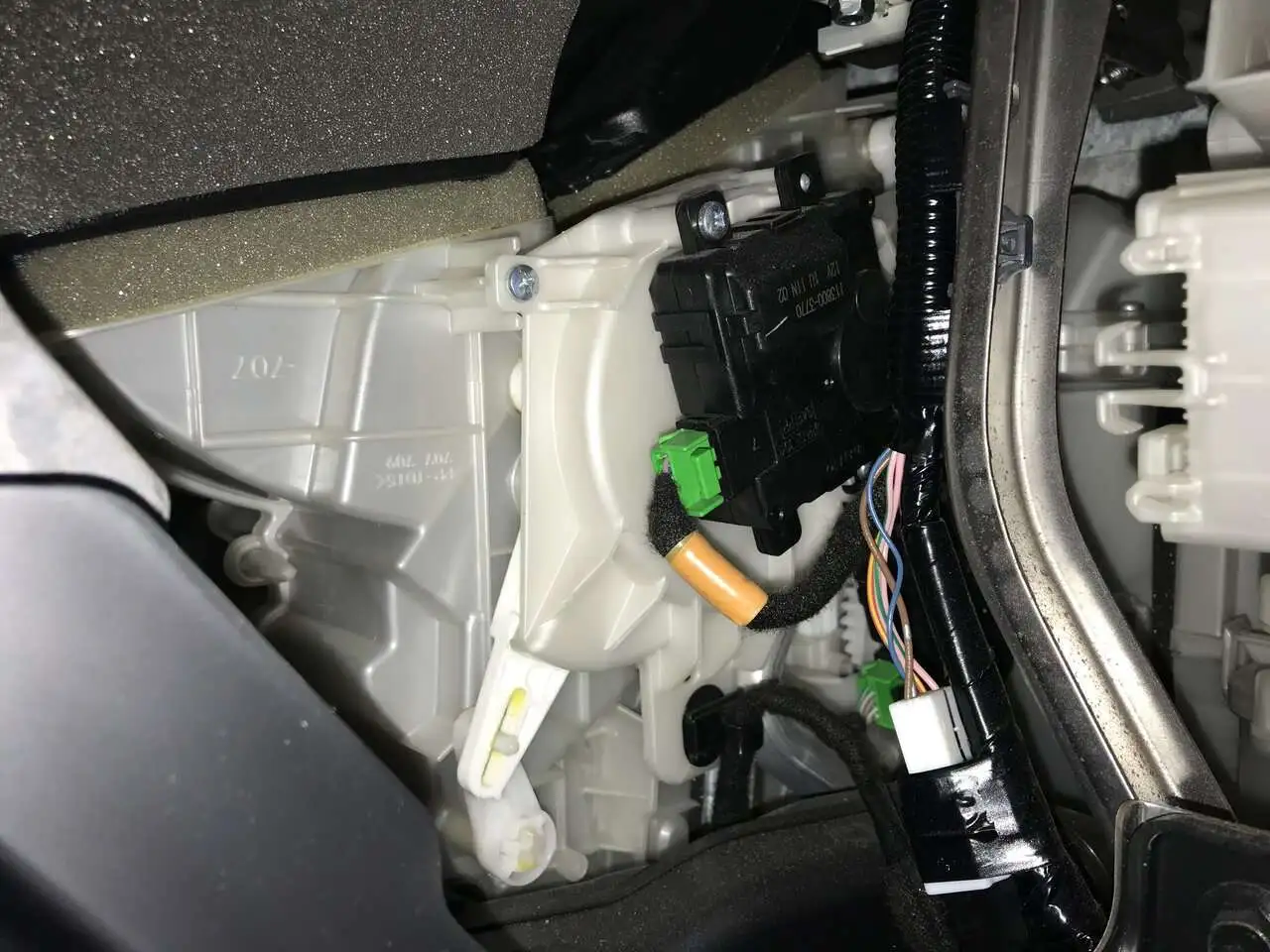

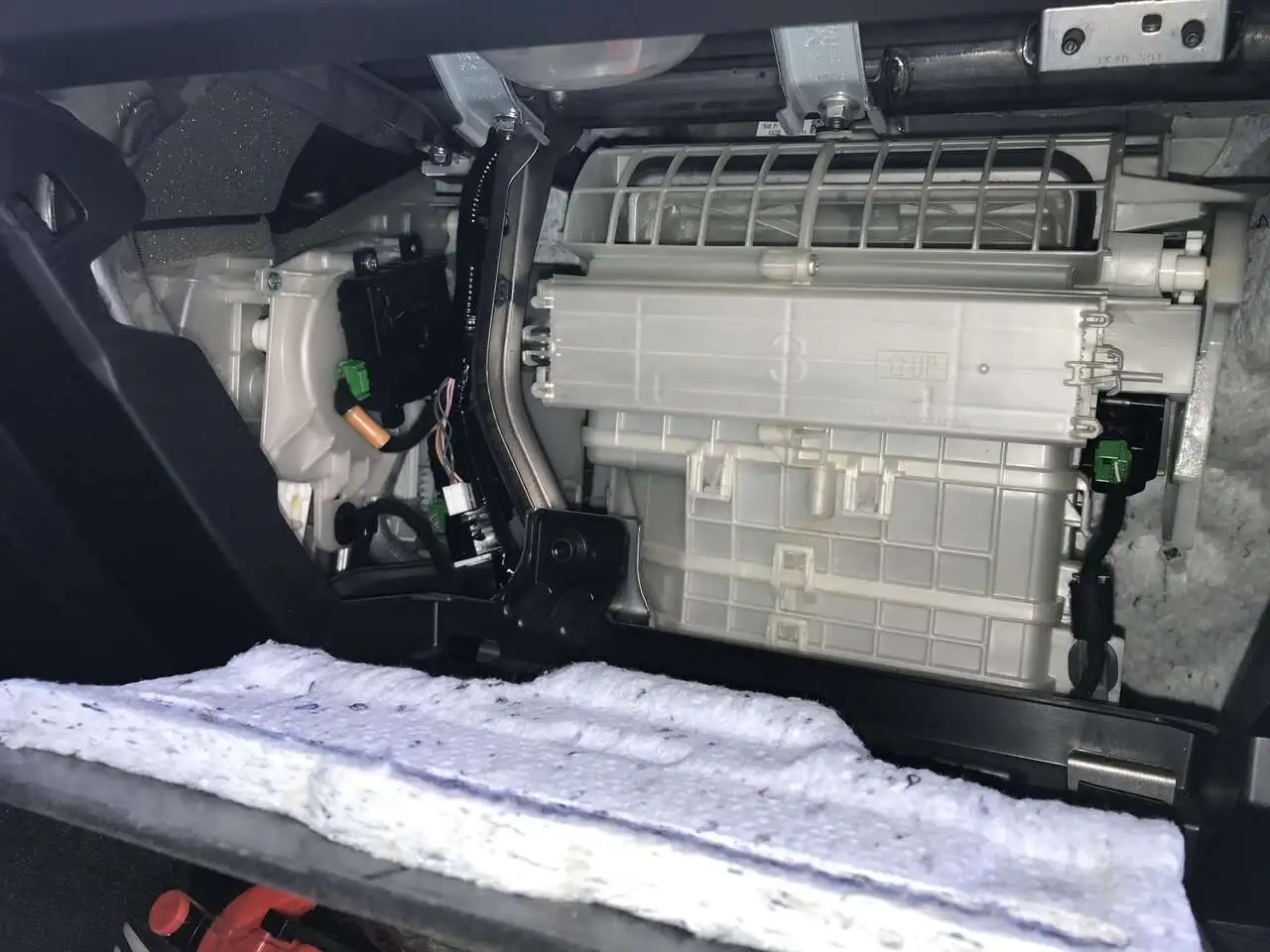

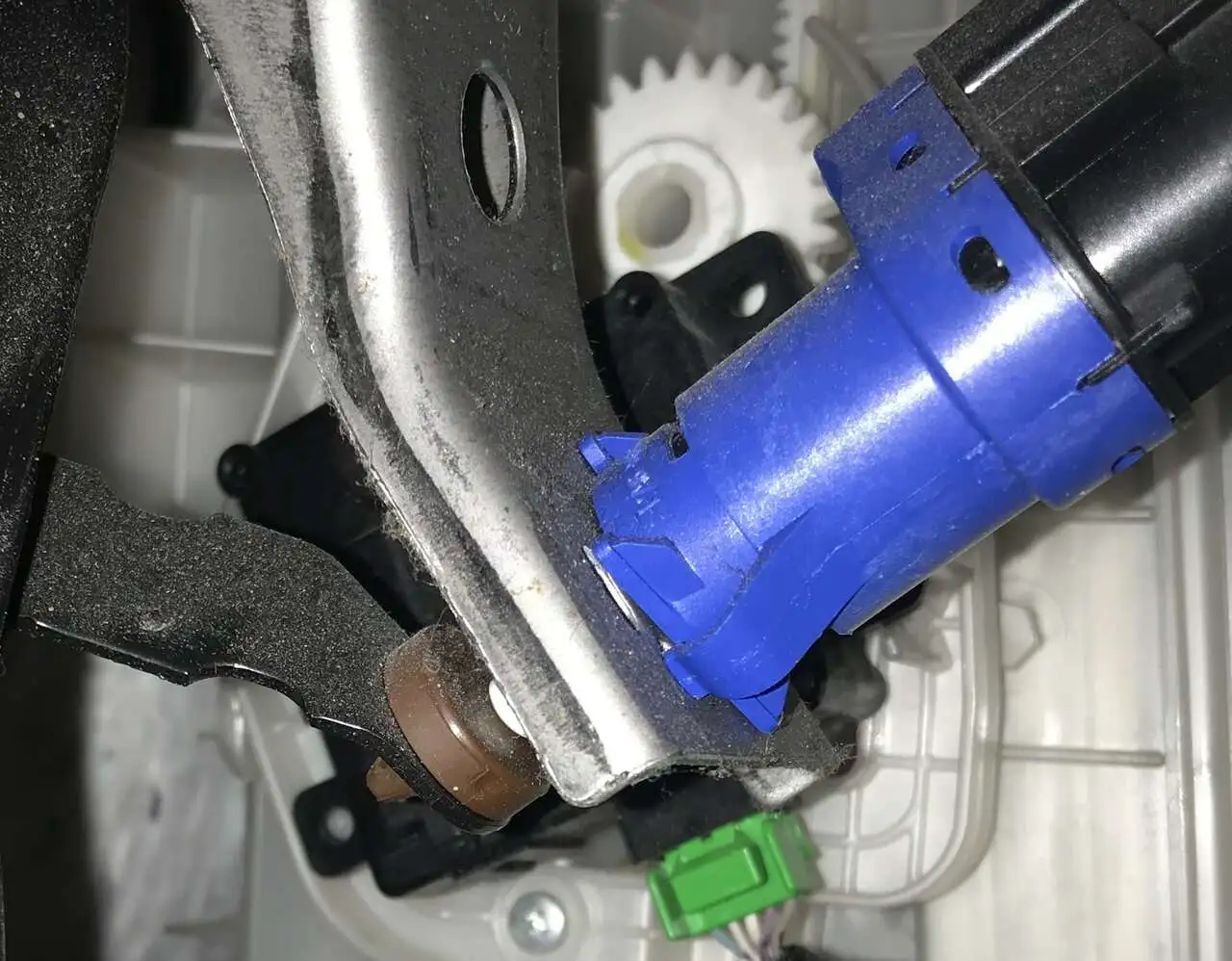

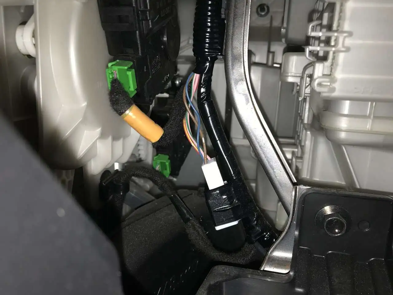

When the actuators are operating you will see the levers and linkages move. Those parts are external and visible. Keep the fan on low and you may be able to hear them as well.
Look at this picture, it's an ebay listing for a Mazda CX9 hvac box. It may not be identical given that it could be from an earlier year but should be similar to yours. You can see two actuators in the middle and one off to the left. I'm not sure exactly which is which but perhaps the one off on it's own to the left regulates the temperature. When changing settings for direction and temperature you should be able to figure out which is which.
I see what you're saying now. I popped open the glove box and I see two actuators there on the left. The top one uses that white lever to the bottom left. That moves around when I change fan directions. For the one below it, I can't see it moving anything.
Above the cabin air filter (number 3) is the blend door for the air circulation setting. That door opens and shuts.
The gears that are visible close to the actuators don't move. But I have no idea if they are related to the actuators. That's the case for the one beside the actuator by the glove box and the case for the one close to the gas pedal, which is the last pic.

I really don't even like to mention this, but there's a well-known, systemic cracking issue with the cylinder head on a number of Skyactiv Turbo model years, including yours. And (again not happy to say) what you described above sounds a lot like the air self-purging process that these vehicles automatically do. Of course, I certainly hope that's not the issue with your vehicle, and that it actually turns out to be a much less severe and less costly repair!

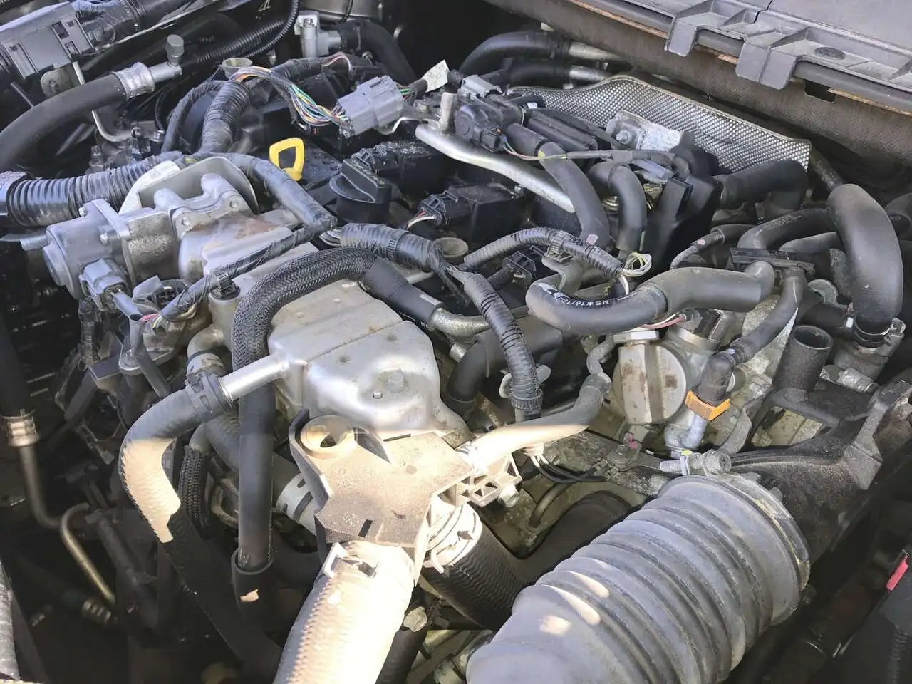

Based on what you've written so far, it sounds to me that you're handy and capable enough to try examining the area that's typically where the damage to the cylinder head occurs. The common place for heads cracking and leaking coolant on the Turbo, is where the exhaust manifold is attached, down low where the head meets the block.
If you're able to examine the exhaust manifold area from the sides, perhaps you'll see some sign of wetness from coolant leaking. Or another possibility would be to have your indy shop hoist it up, and take a look up at that area from underneath the vehicle.

Well, can't find any cracks where the cynlinder head meets the engine or around the exhaust manifold or wherever. And I used a mirror to look on the backside but only a small spot in accessible. And no fresh leaks on any hoses that I can see though I've not driven it for 72 hours now. I suppose if I jacked it up myself it might help to get a better idea of where it's dropping down from. Things are just so compact.
I pulled the dipstick and oil looks normal to me and not milky but can't say for sure some coolant didn't mix in there without getting analysis done.
