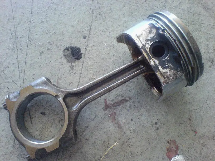

This is what the msp is working with rod/piston wise. I've seen them let go at less than 10psi from the stock turbo, however that is not always the case. Good luck to you.

thx man, thats y keeping the boost at like 5 for daily driving and 9 for when i go to the track.
