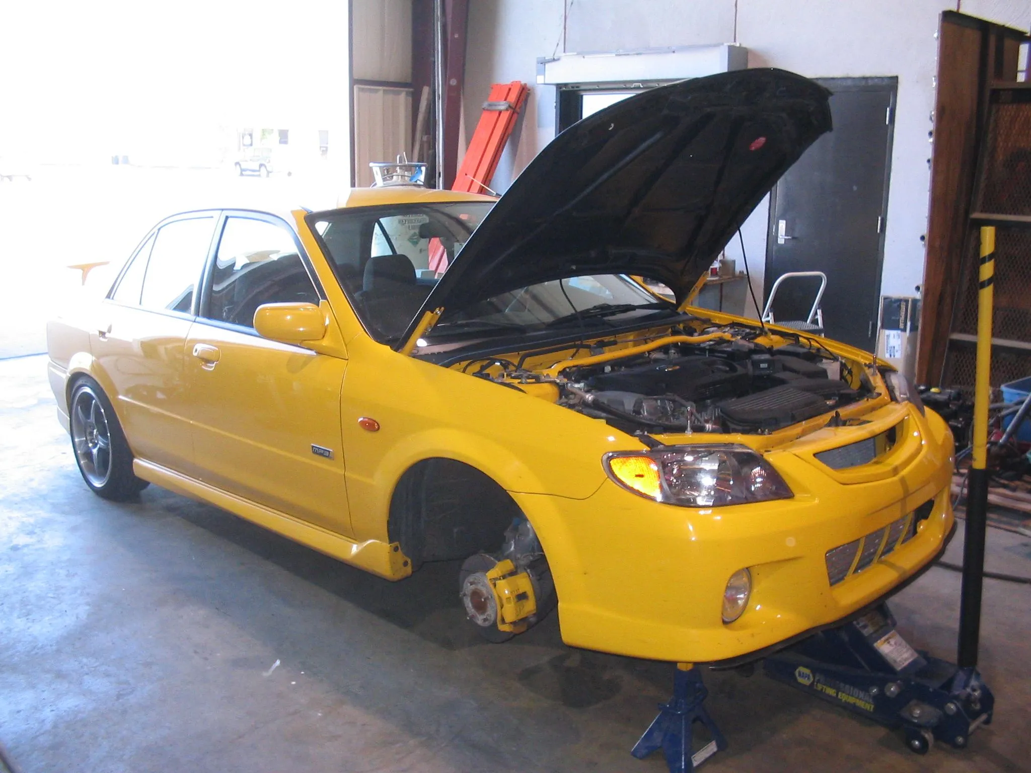

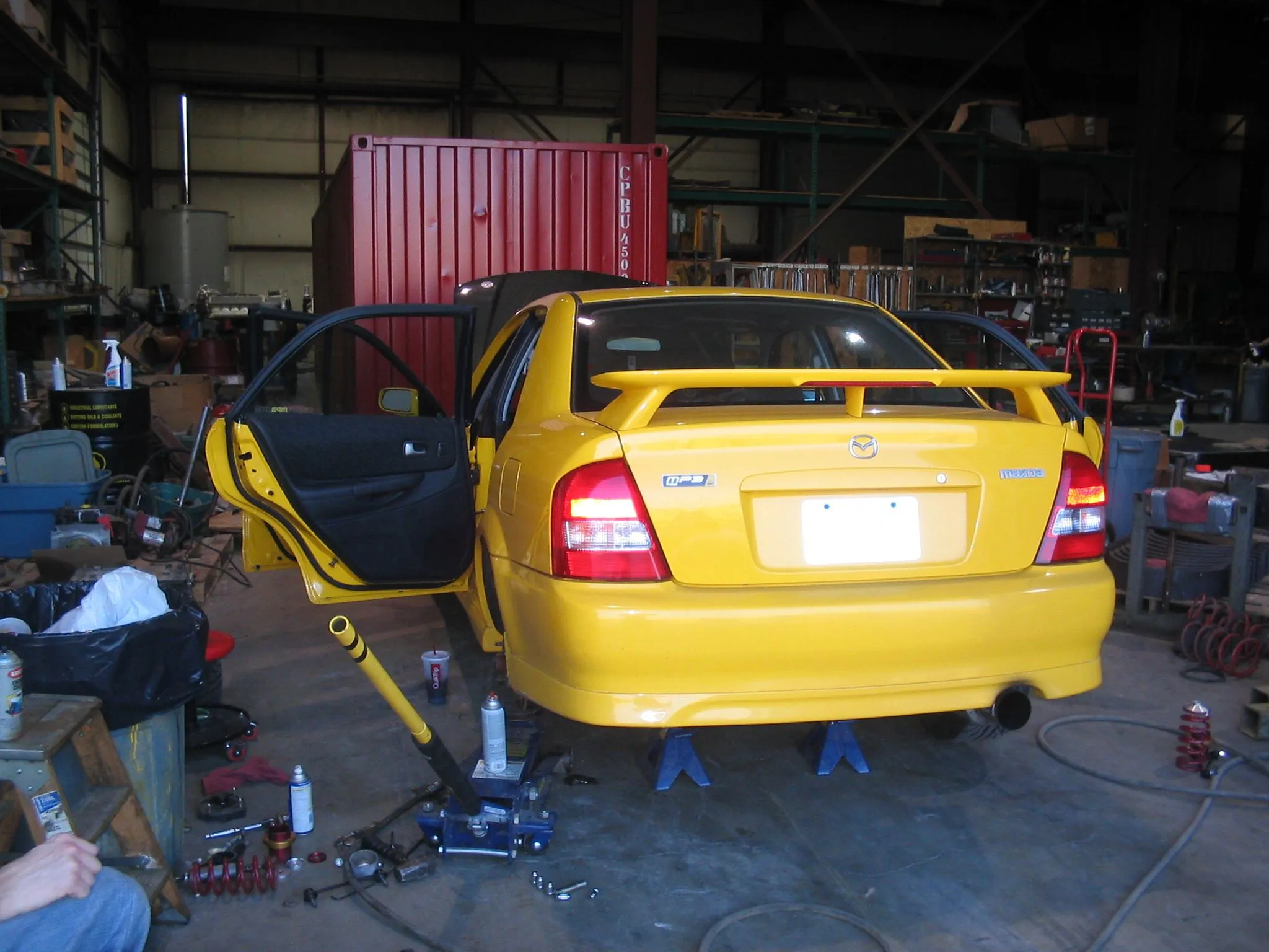

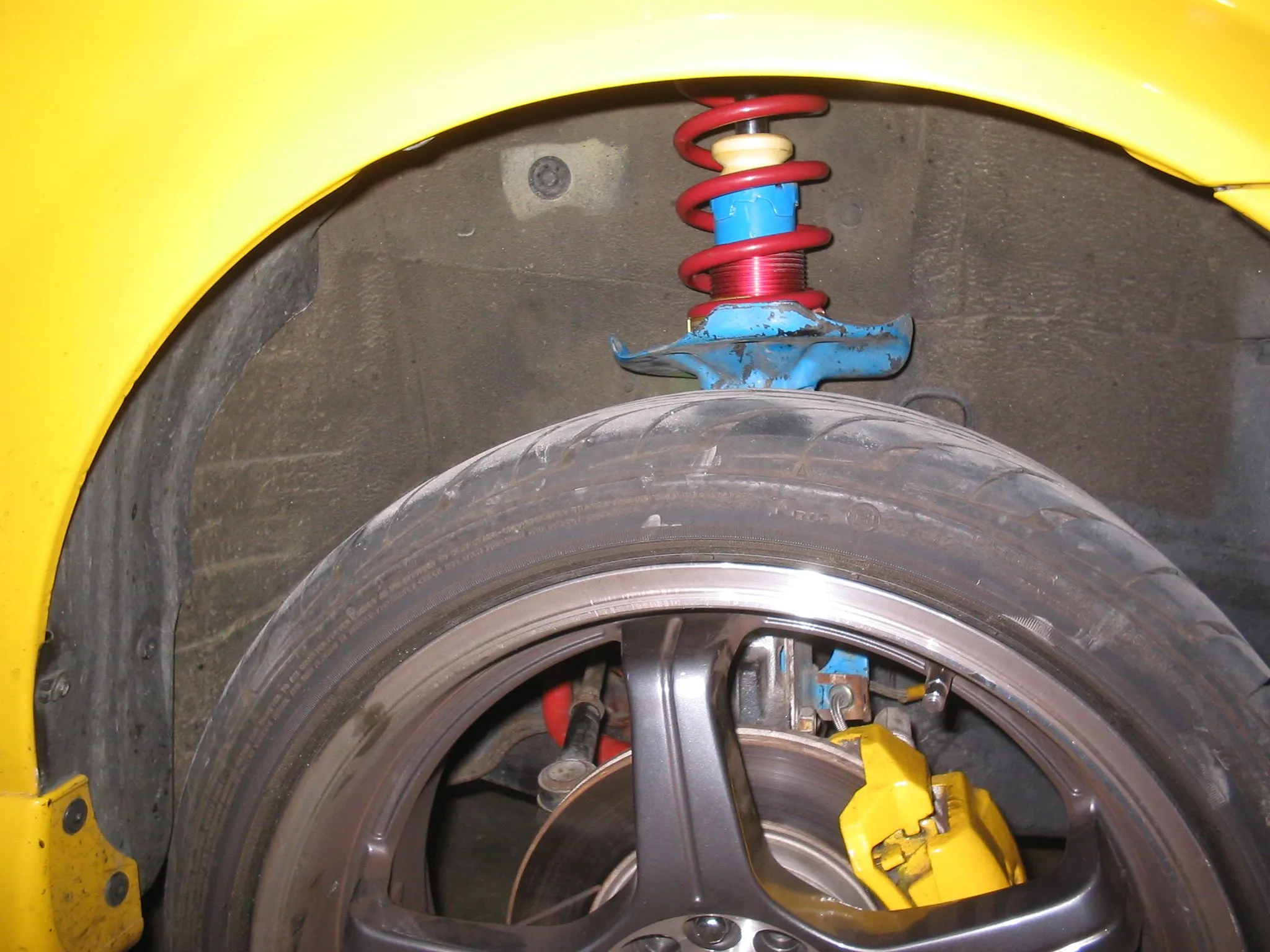

yep, thanks to Ryan and James (RyanJayG and AODfan) we installed them last night. Took about 3.5hrs from pulling in (had to wait for some items to cool) to finish. Its so awesome. So much stiffer! :D Also its gonna be hard to remember the implications- not getting close to curb, etc.

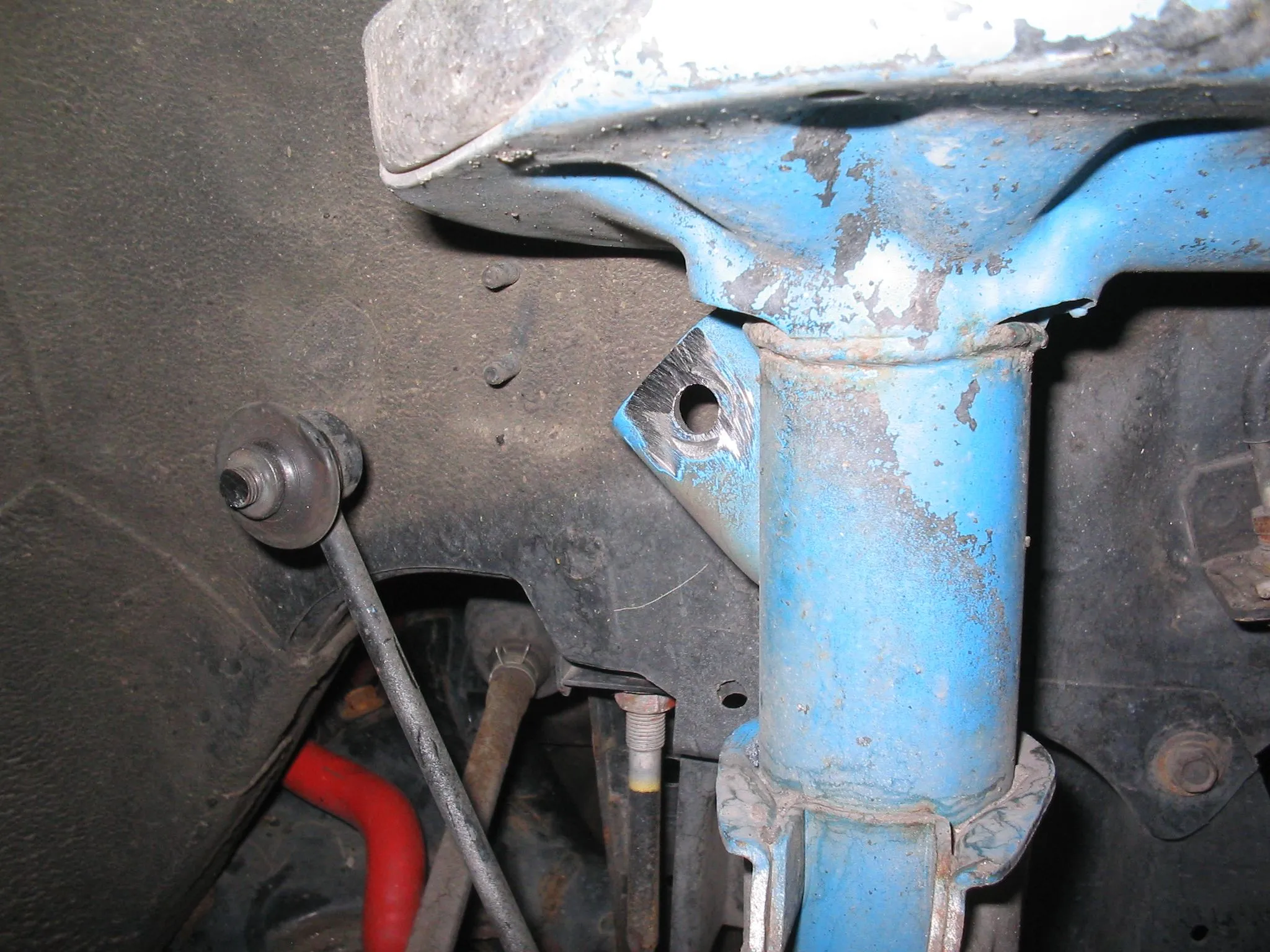

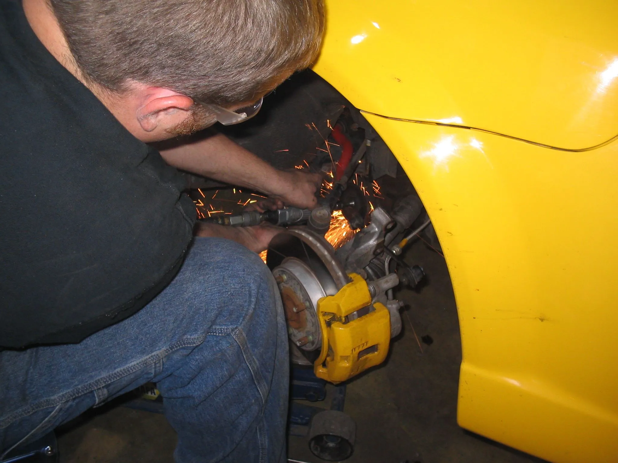

BTW, ALL four endlinks ended up having to be SAWED off. (I knew they'd be a b****, so three months ago when I first tried installing them, I went out and bought all new ones) This time they are coated with anti-sieze.
ANYWAY- onto the pics!
this post- install pics
next post- this morning, lowered!!!

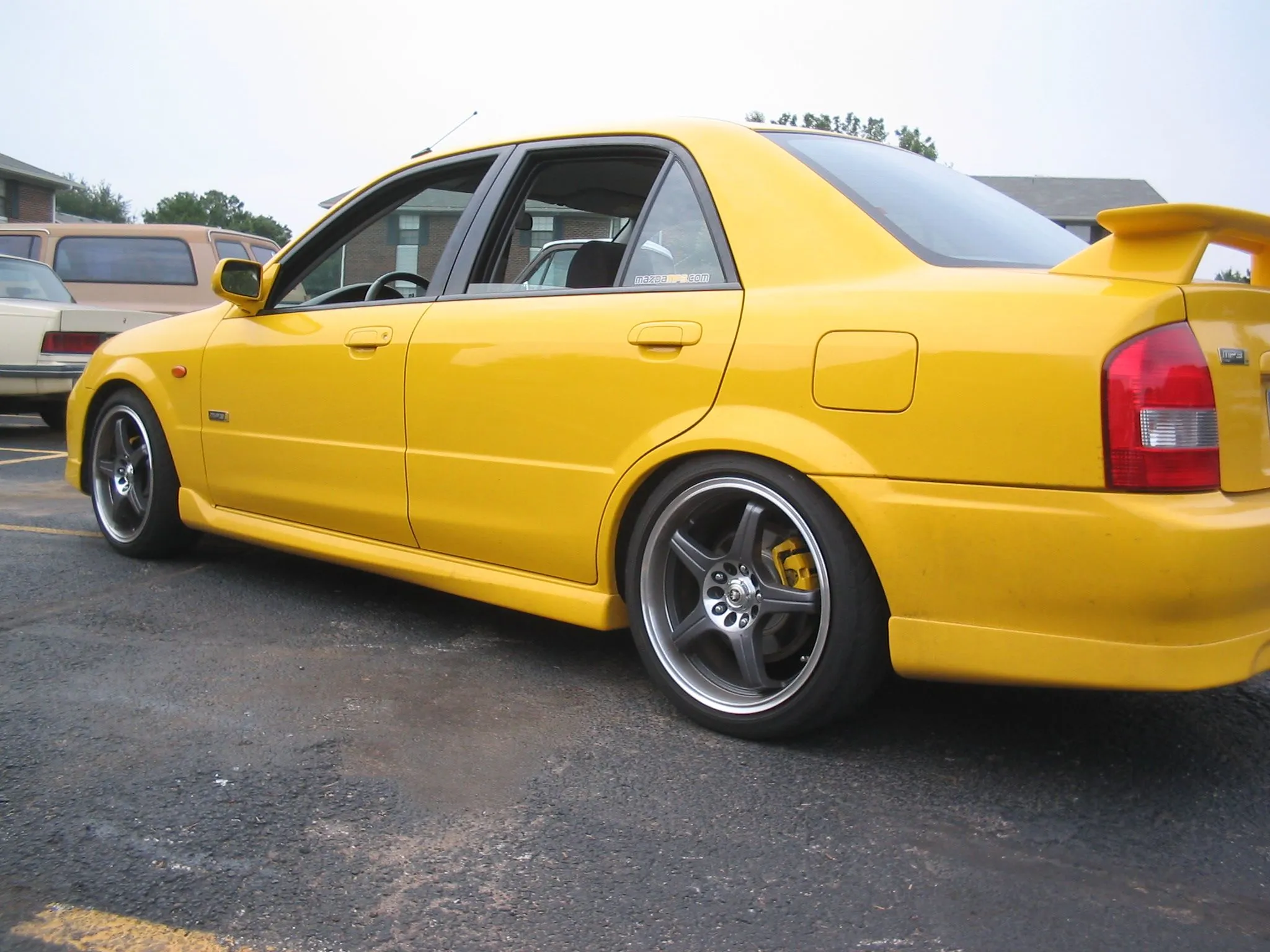

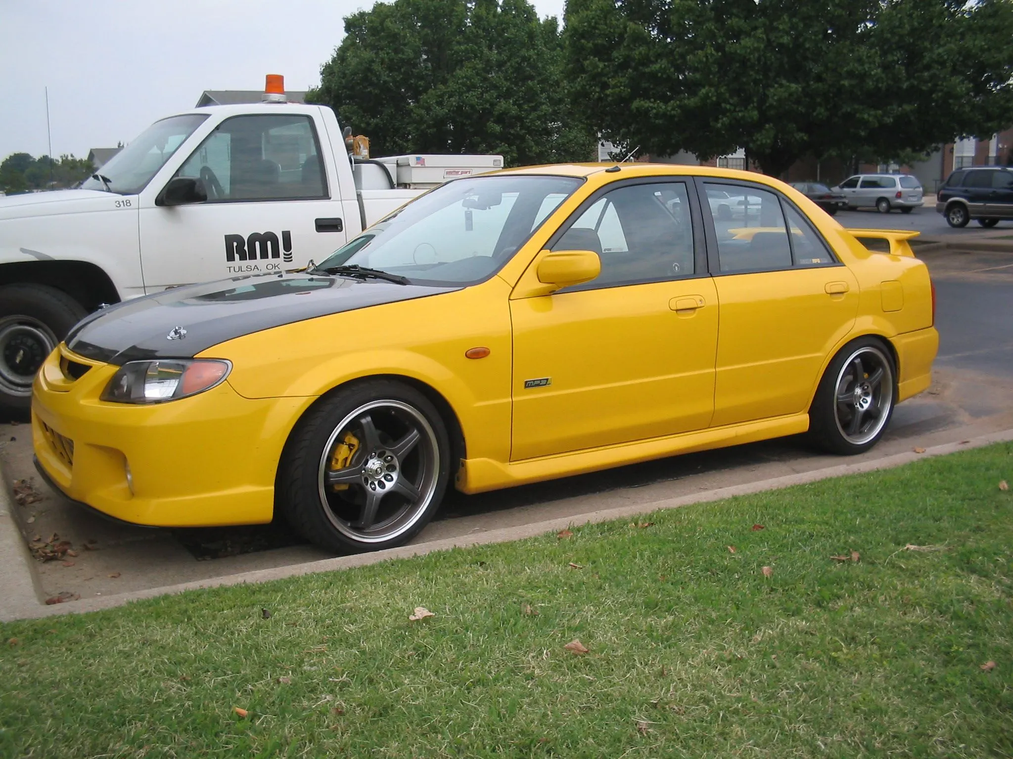

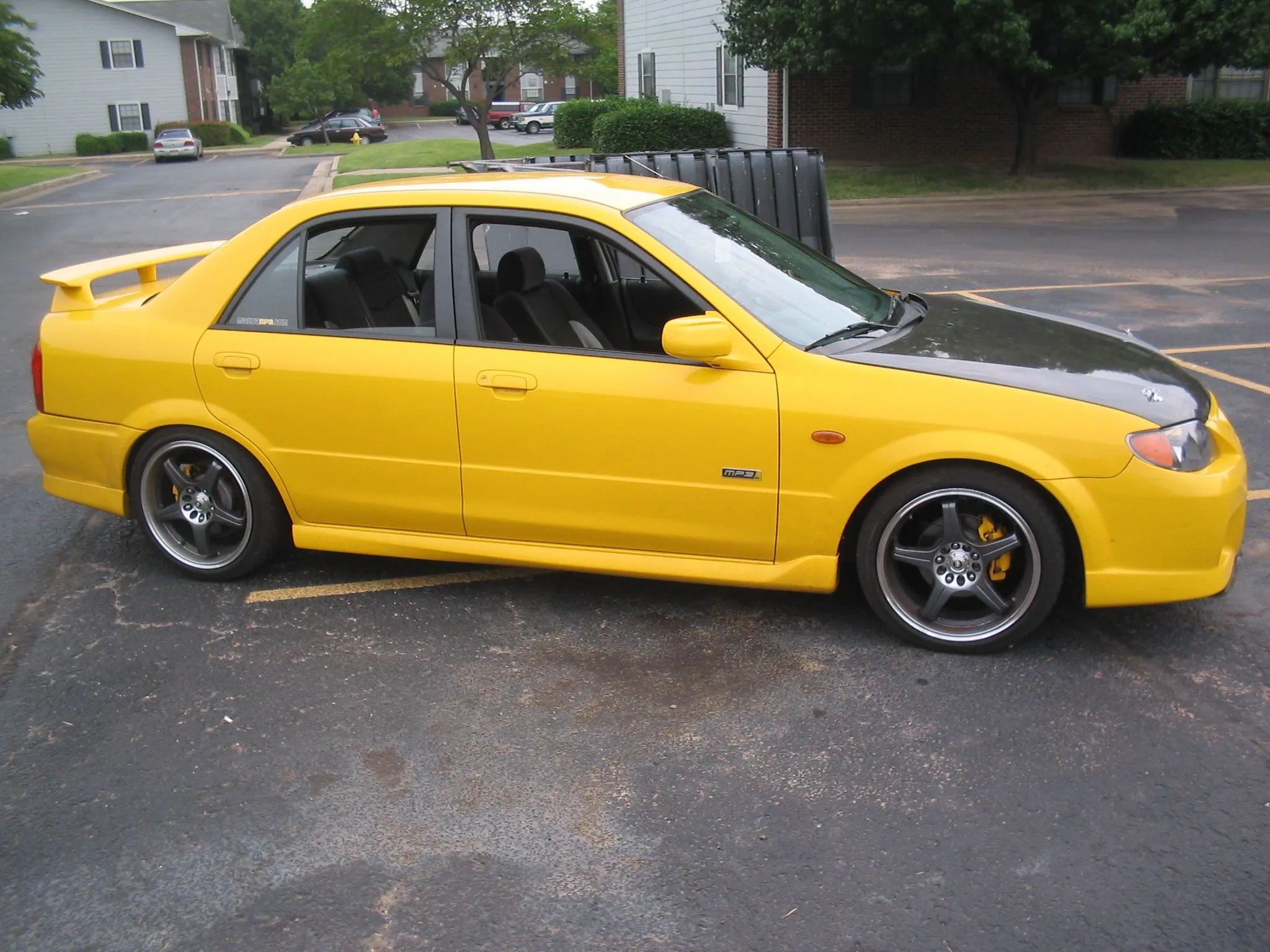

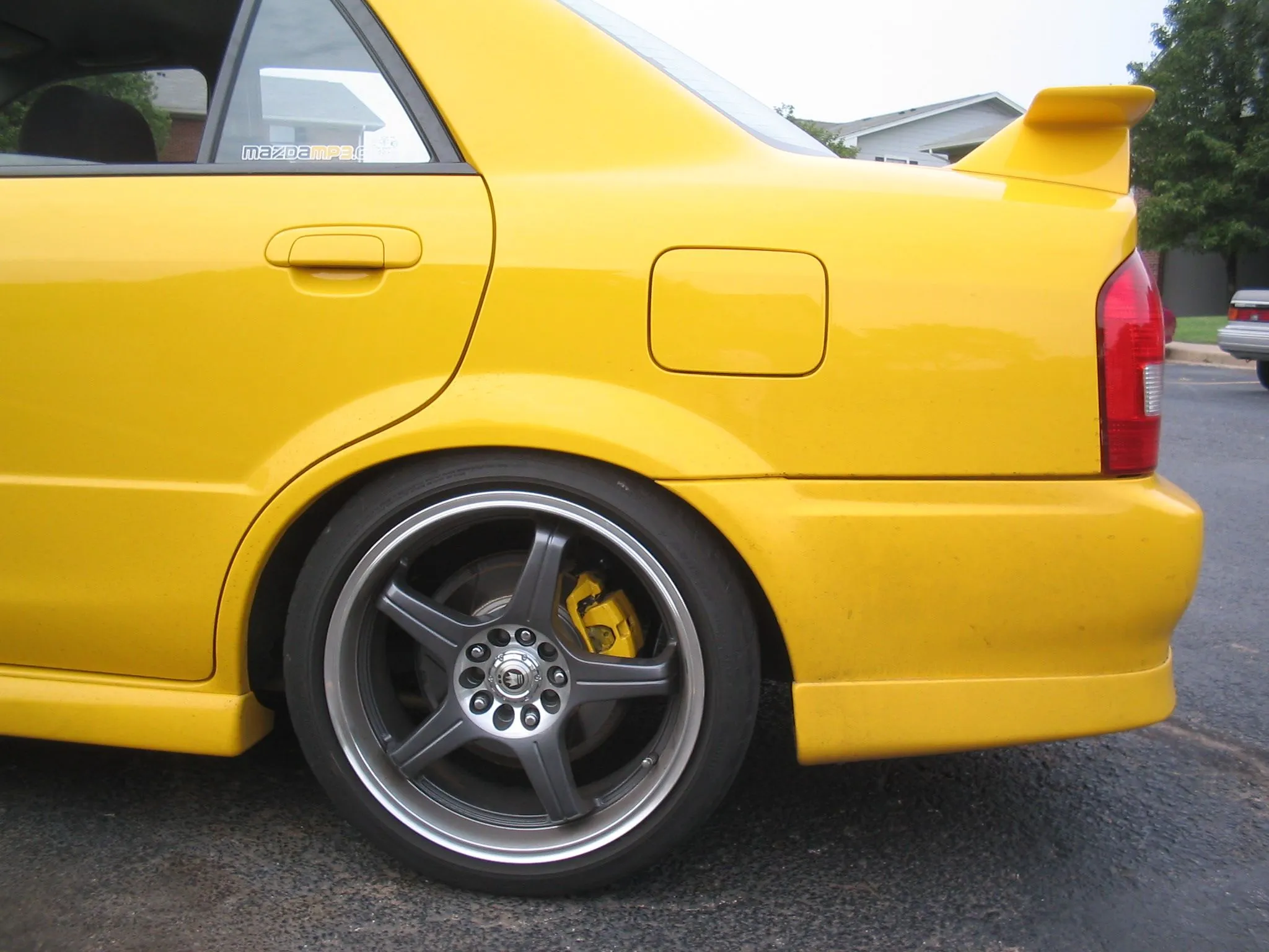

lowered picz!!

If you wrap the strut body with something like duct tape, you will virtually elminate the noises that are the result of using the single rubber o-ring supplied with the kit.

......did u lower the car to its fullest first time out? I know u got curious (lol2) Car looks great now bro.
protegeV said:
looks like ya need to bring the front end down a little bit...looks like she's sagging ;)
You mean lower like in my sig? The car rides a little rough when its lowered like that.....especially when u still have stock suspension. The ride feels better when the front is up just a little.

One question though, what kind of support are you getting by putting your jackstand there?! (first pic)
