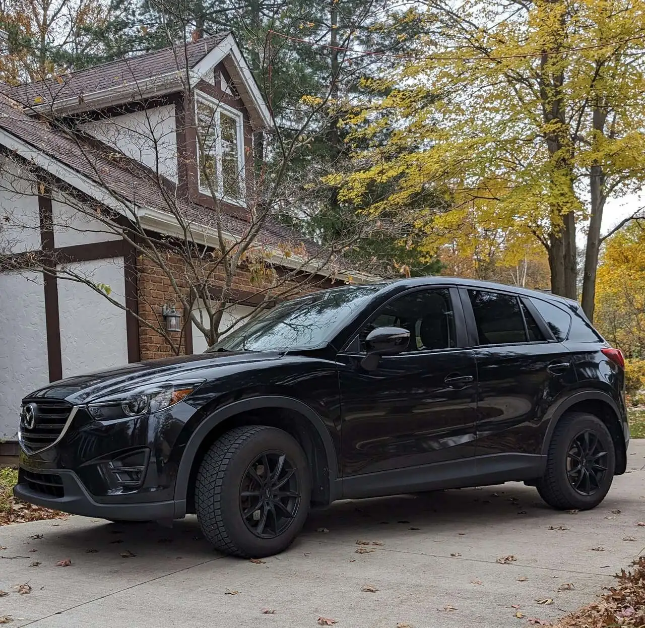

Got my 75,000 mile service done (2016.5 CX-5)
7eregrine
2016 CX5 GT
Land of Cleve
2016 CX5
Basically Spark Plugs. $300. OUCH. Never paying them to do that again. Got the oil changed. They wanted to do an "Induction Service". That was disappointing. Come on guys...Used to love this dealership, but they've gone downhill. Literally not a single issue. I might be willing to do that if there was any weirdness when accelerating, but no. It's perfect. Drives as good today as it did November 2016 when I drove off the lot. I am shocked at how rusted the calipers are but apparently they still work perfectly.
I do like this little video they made for me. 07953
That's cool. Passed on the filter, just bought one on Amazon when I got home.
So total repairs since I bought it: $0.
Total maintenance since Nov 16:
Pads and rotors replaced, brake fluid flushed. Oil changes religiously. Battery replaced. Rear Fiff Fluid changed once. Also had them "Lube the Slides" on the brakes at my first service. Based on a recommendation from a guy I know that is the District Manager of a western Ohio region. And now spark plugs.
72,500 miles.

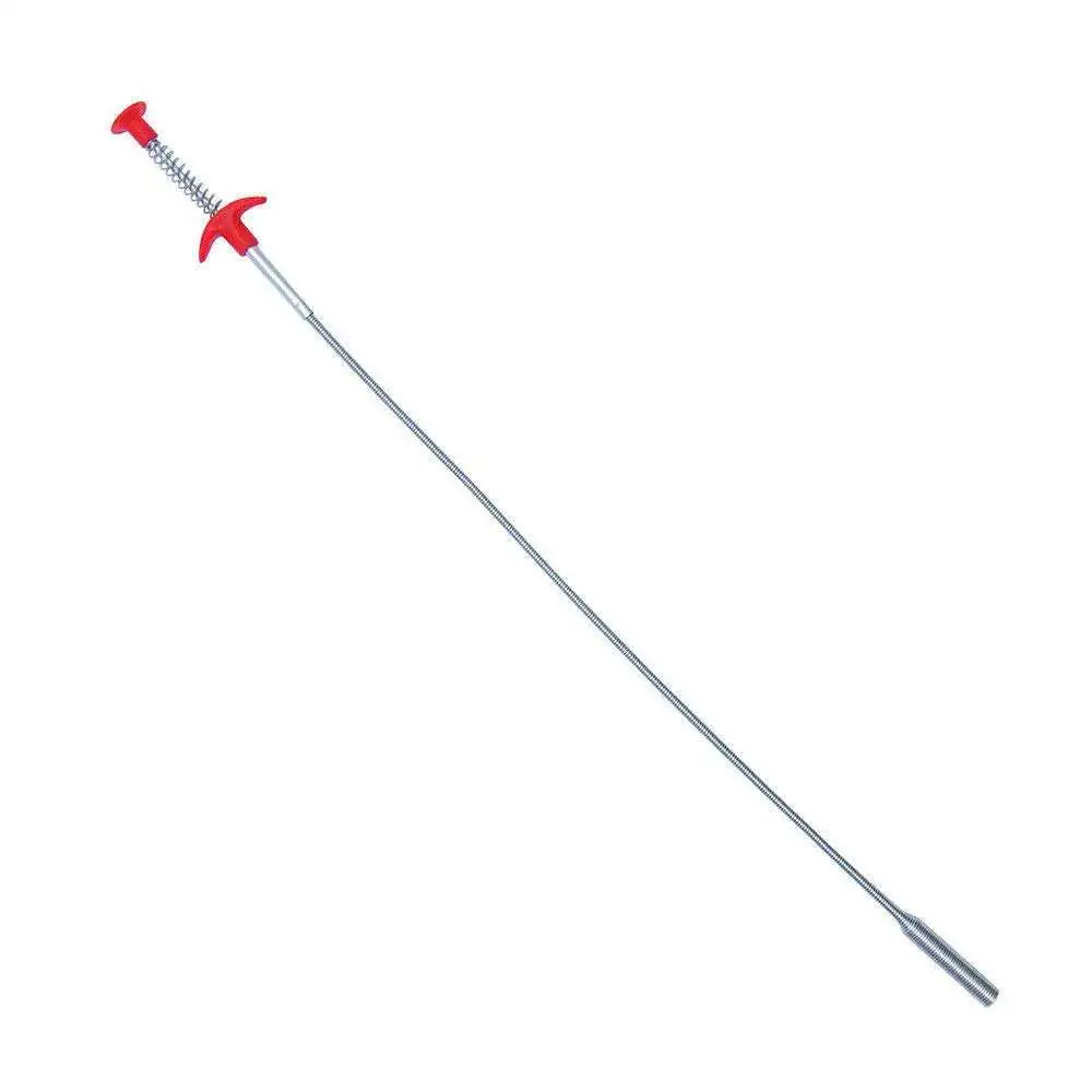

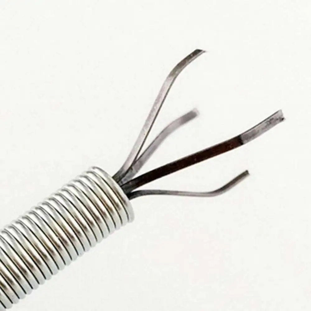

For the spark plugs, I have (probably) a less used more unique approach ...
I use a regular deep socket with an extension just to break loose each plug. For actual removal and installation, I use one of those https://www.amazon.com (commissions earned) (just an example).
Here are the reasons why:
Using the grabber tool gives me great visibility, feel and control to what I am doing because the flexible shaft is so thin and the "grabber" part is attached to the tip of the plug. I can hold a flashlight in my off had, lean directly over the spark plug well (holding my mouth just right of course lol 😆 ) and watch exactly what is going on. It's very quick to spin the thin flexible shaft of the grabber making it like a speed wrench. Same with installation, the grabber gives me more visibility, feel and control gently guiding the sparkplug threads into the head. I can see that I'm exactly lined up because I don't have a socket taking up all the space blocking my view. The grabber holds enough tension on the tip of the sparkplug that I can rotate the threads in but not enough tension that I could possibly strip any threads or cross thread it because I feel it instantly and I can feel precisely when the plug gasket is seated in.
I finish up with the deep socket and a torque wrench. (I've found that the "quarter turn past gasket seating" or whatever they print on the sparkplug box matches pretty well with a proper torque spec.
One final note ... I only change sparkplugs on cold engines. Most heads these days are aluminum and aluminum is soft. Your risk of bad things happening goes up on warm heads.
Happy DIY'ing 😁
