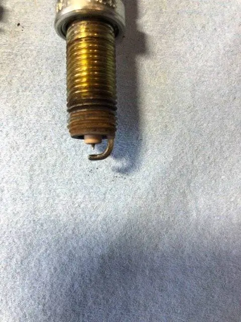

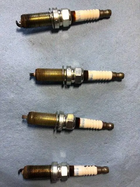

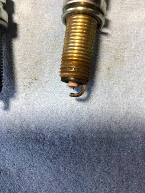

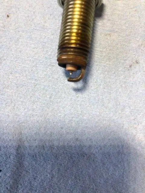

I went with the NGK OEM replacements at about 77k miles and couldn't tell any difference. But Mazda uses the plugs to measure ionization in the cylinder predicting pressure and that can predict spark knock and cylinder pressure at various crank angles. Since these engines emulate Atkinson Cycle, knowing the pressure is valuable. How much info Mazda uses is known only to Mazda, but clean plugs should give better info. Mine were certainly clean enough to have run to 100k miles in most other engines.

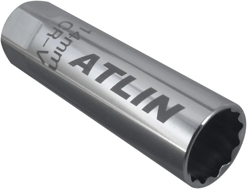

This 14mm thin wall socket I used on my '07 G35x holds these plugs nicely.

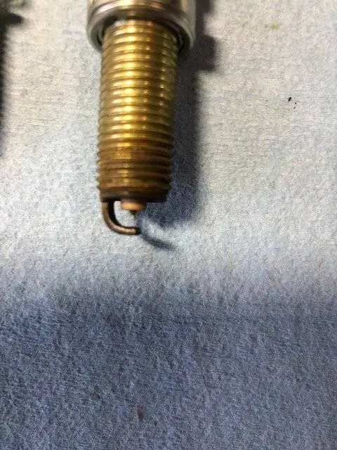

Just a quick glance they looked exactly the same. I'm just shy of 68k miles. So an early swap but it will probably be another 8 or so years before replaced again as it appears I am only doing about 8-9k miles a years.
