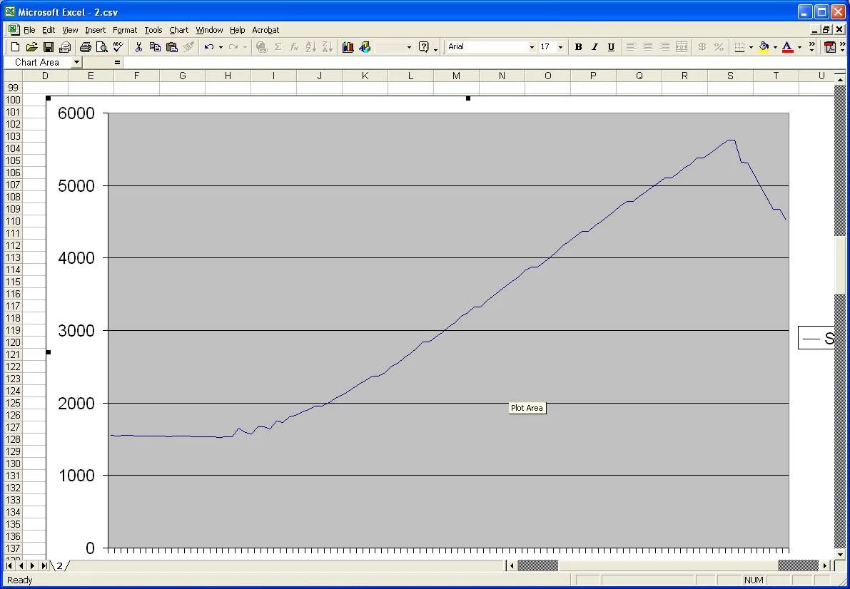

I can tell you that the OBDII RPM display is not perfect. If you do an acceleration run and log the RPM, then graph it, you can see that it has regular flat spots. I believe this is some kind of arithmetic artifact that allows round-off errors to effect the data. It drives the inertial "dyno" calculation of packages like Auterra Dyno-scan banannas.
