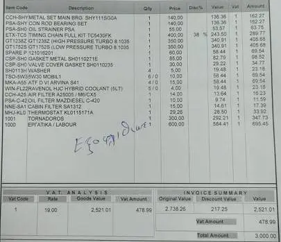

The strategy was to disassemble the complete engine,also needed to replace the head gasket, and see what has failed and replace only those components
Unfortunately this guy changed everything(list follows) because he didnt want to be blamed if the car failed from a different component in the future
things to be changed from MAZDA faulty engines
  • My overhead camshaft was already replaced, and also a cooling tube originally plastic and changed to metallic.
  • oil strainer (output of oil pump has a strainer that fails, this gives amber/red oil pressure).also this problem goes away with oil change due to contamination
  • two turbos if they fail due to oil contamination.Oil gets diluted due to diesel intrusion in oil resulting in not good lubrication of the engine in general but specifically the turbos. Lower oil intervals recommended. The only thing that was aftermarket were the two turbos costing 750 euro because mazda quoted 4500 euro
  • head gasket which is the component that created all the problems
  • IF you didn't attend this problem from the beginning, that means you engine block has been overheated resulting in distortion and even cracks at some point and it would require replacement. If you are lucky like me you will take the engine body to the machinist to straighten your cylinder head via removal of metal
Thats it for now.If I remember anything else I will post it later
The total cost was 3000euros

Looking through the parts list of what was changed in your engine, I believe your mechanic did a very good job for you. Seems like a reasonable cost for what was done.

1. I like the car very much, upgrading from a Honda Jazz 2005 makes me feel like commandeering a space ship with all these extras. Also JUST after spending 3000 euros I am not going to sell it
2 . I live in Cyprus,Europe and neither the dealership and ESPECIALLY the government in not going to back me up in this situation
3.As I mentioned already in the original post, the mechanic used the upgraded version of ALL the parts that MAZDA supplies. Mazda(Japan) at a point acknowledged(without admitting) the fact of the design failure and came up with the upgraded parts. ARE these parts going to solve the problem? WHO knows???
The mechanic told me that through the years he requested several parts from Mazda to replace the failed ones he found in different engines he worked on. The parts he got finally were different in part numbers and materials thus leading him to the conclusion that these were the upgraded ones
4. The mechanic insists that with this kind of repair the problem no longer exists
5. The mechanic has offered me a written warranty or guarantee (don't know the difference) for 1 year .Anyway in the country I am I doubt it if this thing means anything
