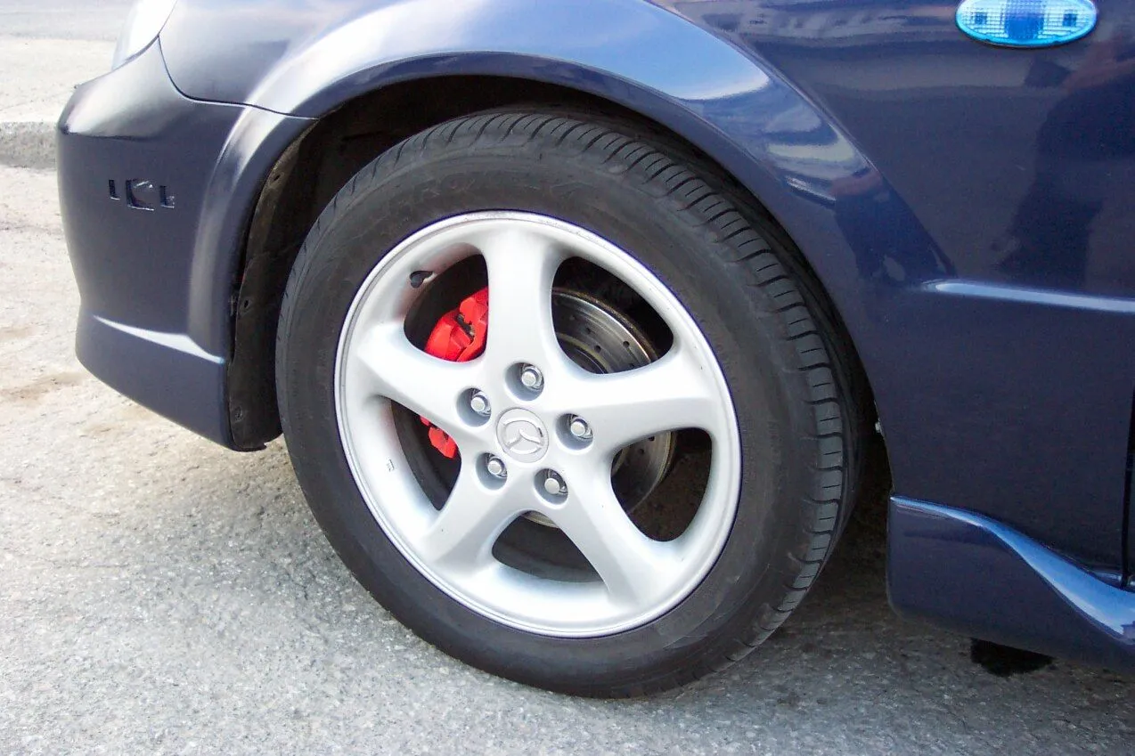

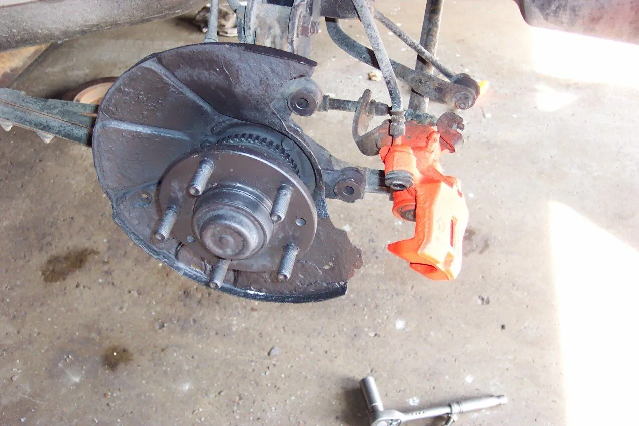

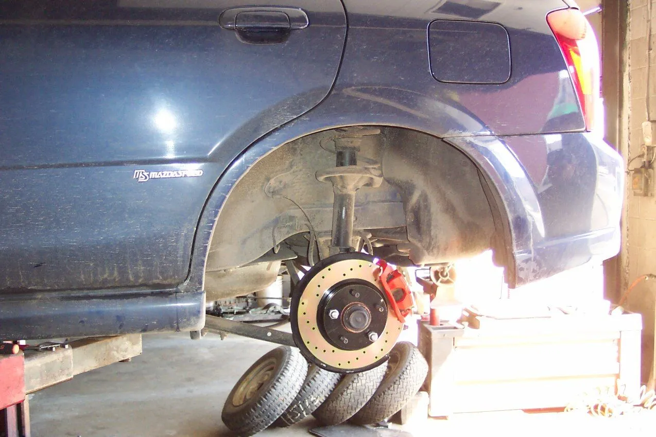

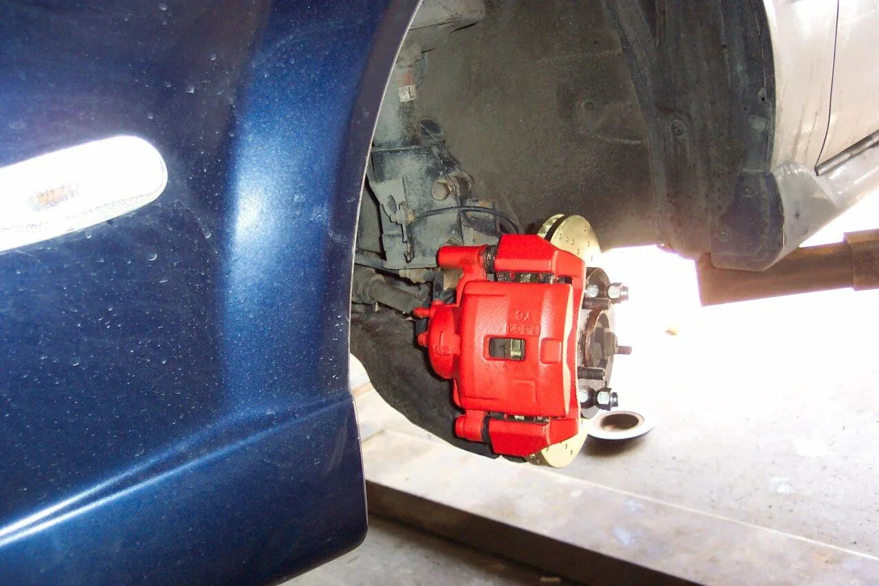

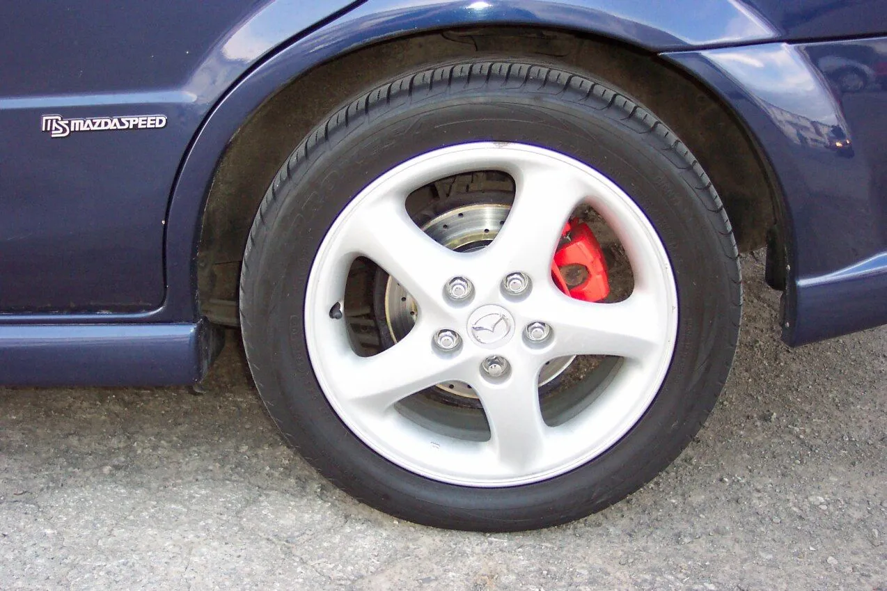

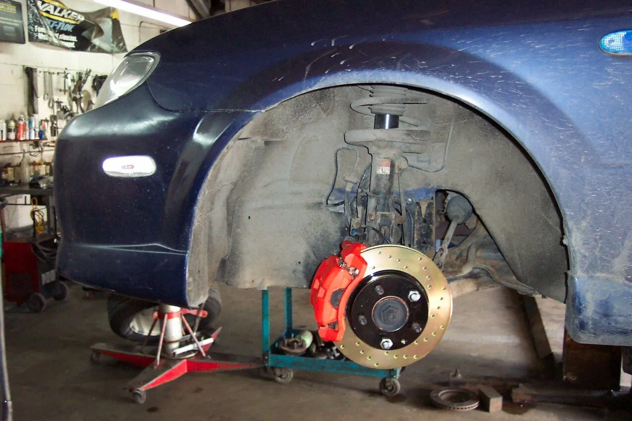

Hey there again. My brother-in-law was kind enough to hoist my car at his garage and let me do my thing. I had the rotors replaced and painted my calipers a-la-iLisa (orange, although they look very red in these pics). I'll post some other shots in a few days of the whole car.... See ya!

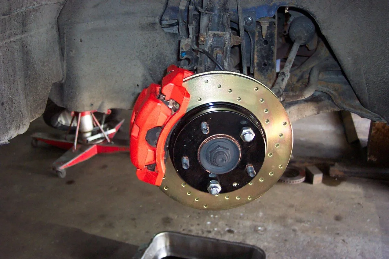

Thank you all for the great comments! I wouldn't have even attempted this without all your input, advice, and how-to's. So THANKS! My brother-in-law was hesitant to disconnect the brakeline and bleed the brakes and I was already grateful for the time on the lift, so I had to paint them dangling as shown in the pics. The front ones where easier as they dangle lower than the rear. I just used some tape to mask the rubber parts and the brakelines. Here's a few more pics I just took. They're fresh! Man, I hope this doesn't look ricey! I just really didn't wanna see anymore rust.
PS: I'm repainting part of my bumper, hence the missing corner lights...

i wish mine looked that good lol. but i half assed mine :\
im gonna strip the paint off mine and re do them when i have nothing else to do (which is the reason why they got painted, i was bored)
They came out nice. I would have never thought to paint them orange but it goes well with the midnight blue.

Sure.... I would (and DID):
- spray them with brake cleaner to get most of the gunk off
- brush the calipers on a grinding wheel with a metal bristles wheel of it if possible (or sand them with coarse sand paper)
-use a rust converter on the calipers. rust converters help a LOT in my experience
-mask
-paint
Hope this helps........
