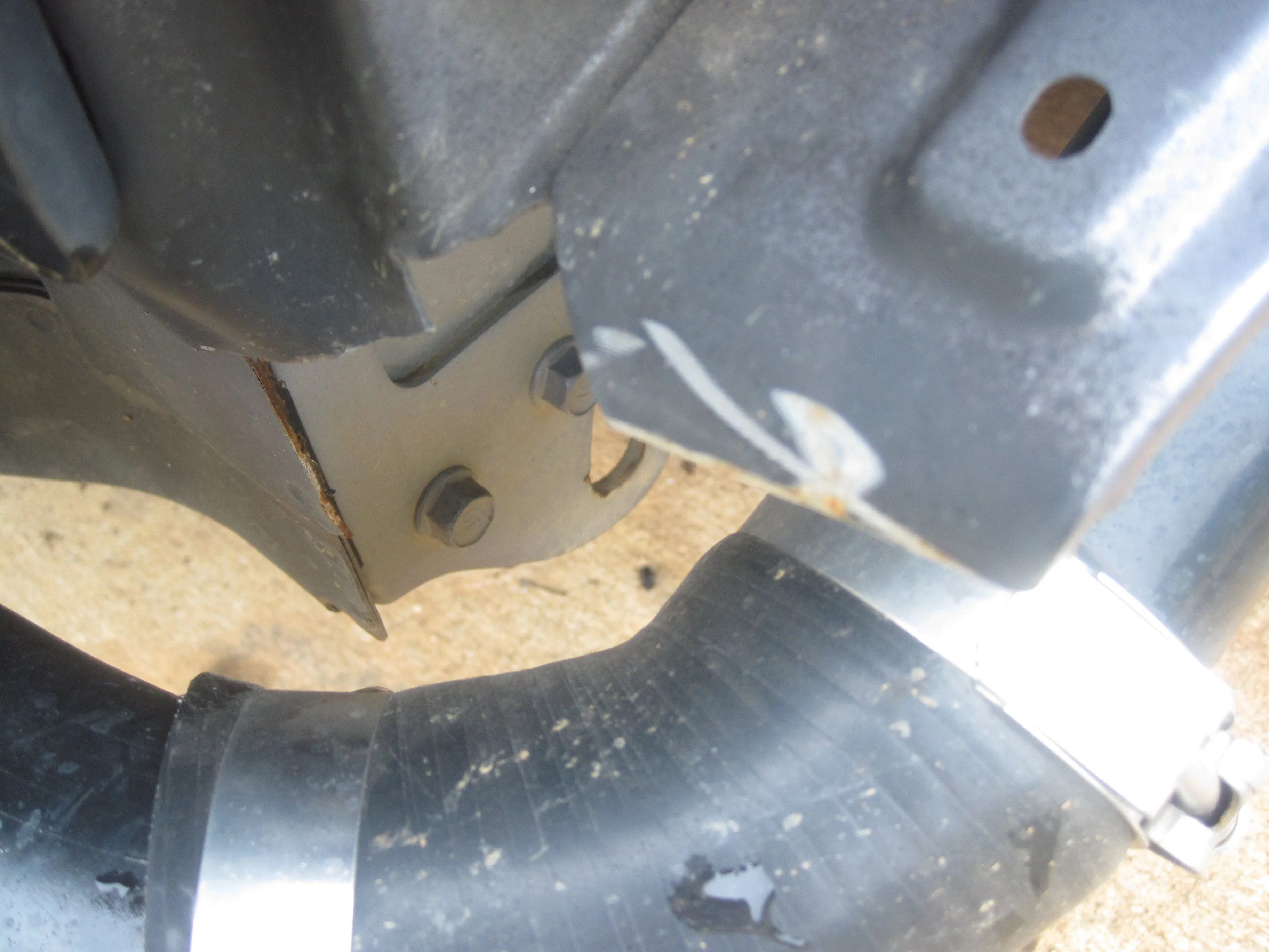

With my kits, there is minimal cutting on the lower edges of the frame to allow for the piping, and a couple of the pipes will need cut. With my kit, you leave the crash bar in place as it already is. The intercooler mounts to the bottom of the crash bar and the design allows for quite a few choices for the intercooler size. If you want one that isn't going to hang below the MSP lip on the bumper, you will want to look at the ones that are 5.5" and 6" high. My website is www.alteredcustoms.net and I also supply instructions along with any help you need from me answering questions you might have. I took some quick photos (still trying to get the other one to upload) just now since my front bumper is off, you can see the areas that would need cut. My car was originally cut for the MAM kit, but as you can see in the photo, you really wouldn't have to cut as much as mine on that side.

I can show you how to do a custom kit using whatever core you prefer, and ebay piping as well. I did no cutting other than bending back a piece of metal off the end of the frame on the driver's side.
