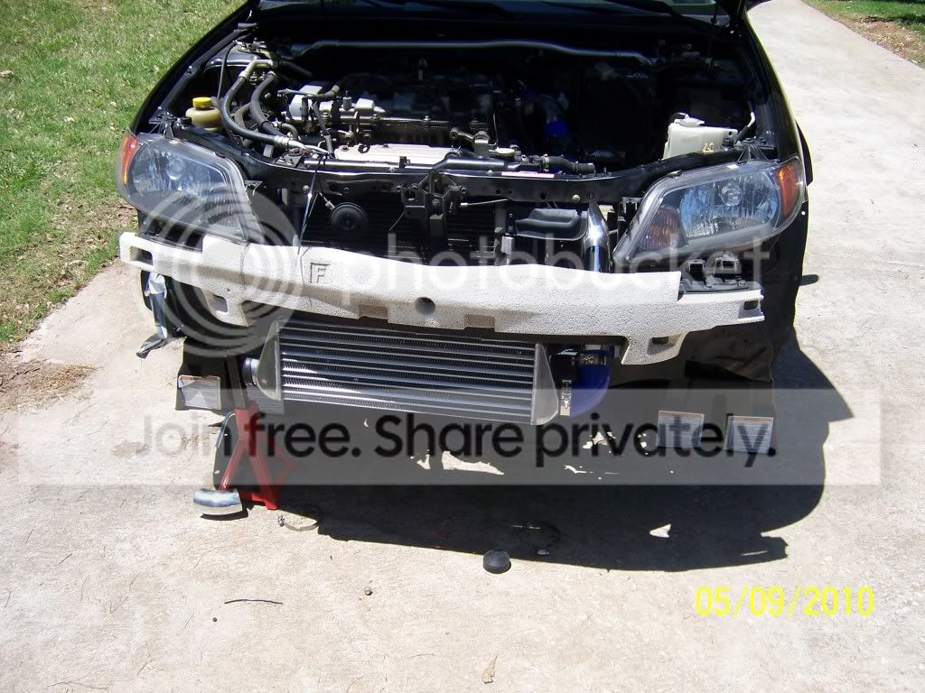

Thats as far as I got. I don't think the FMIC will be even with the bumper so I may have toi just center it and run the piping through the CAI hole and move that fan over some. I hate this job though.
