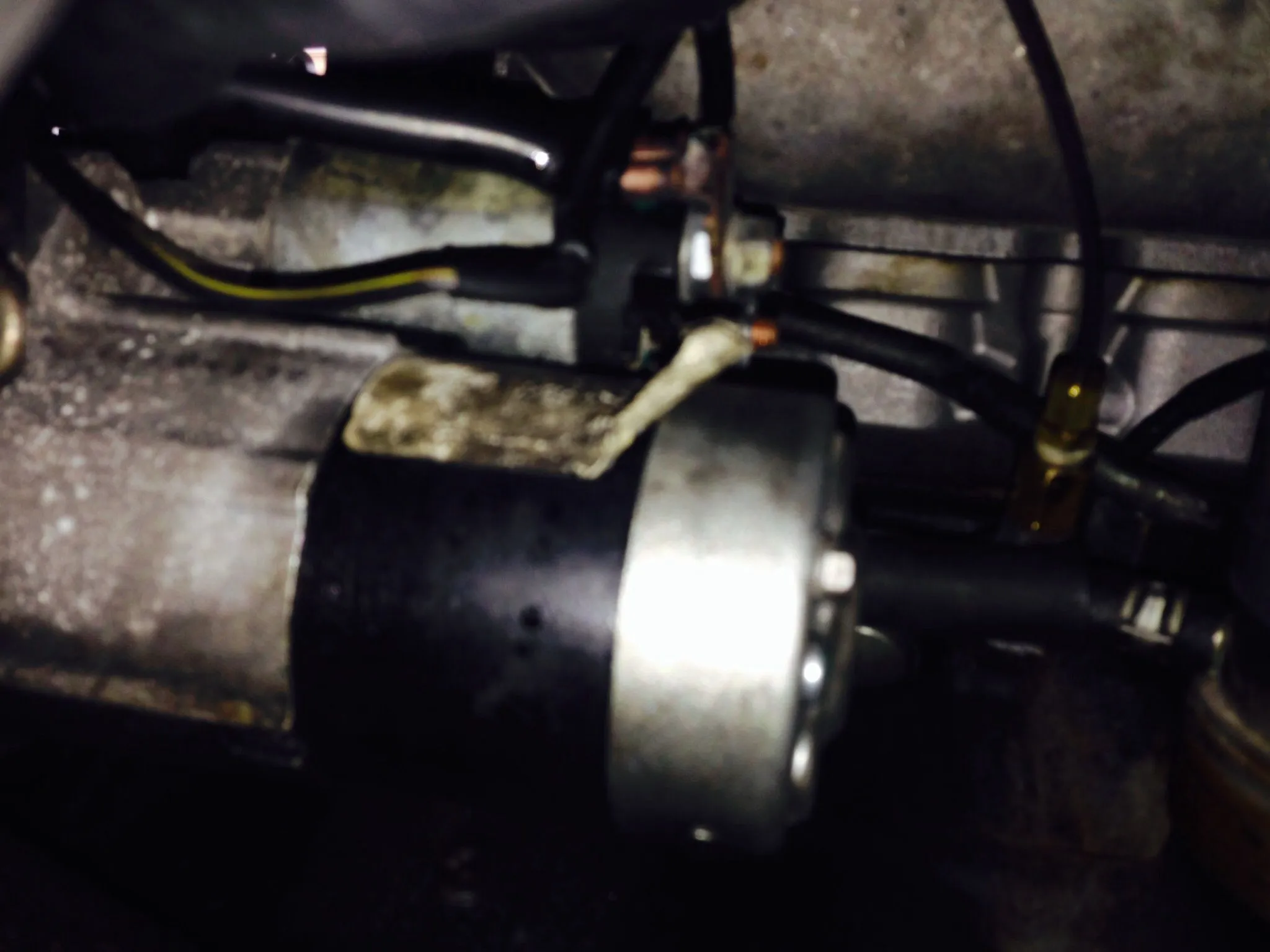

I installed new mechanical gauges and a afr gauge. While removing the old electric oil pressure sender i hit my wrench on this black cylinder part (attached picture bc i dont know what it is called), then sparks and smoke flew (i didnt disconnect my negative battery terminal). Got everything installed...

That would be the starter. That's not good. The ECU may be fried but you have to have it tested, maybe in another MSP? If it's fried it can't be fixed.
