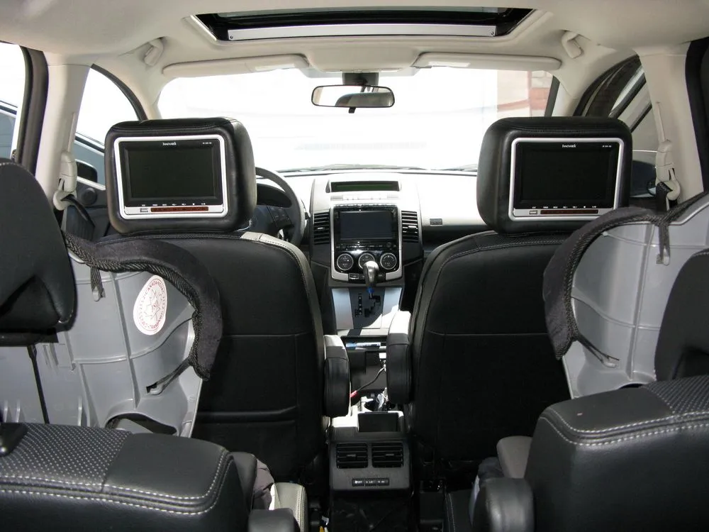

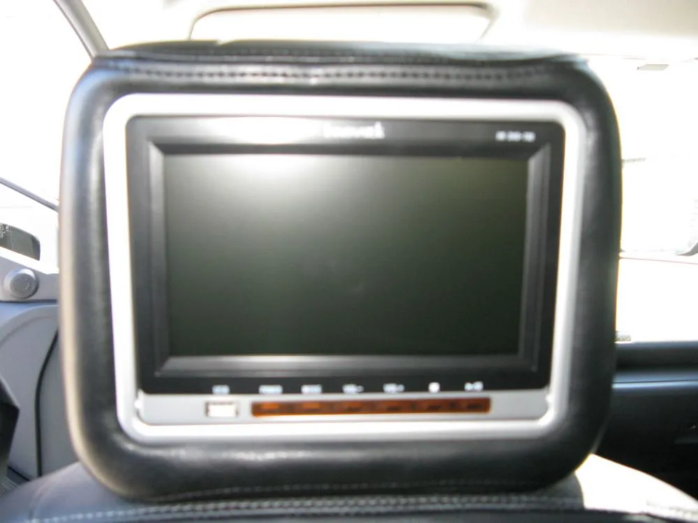

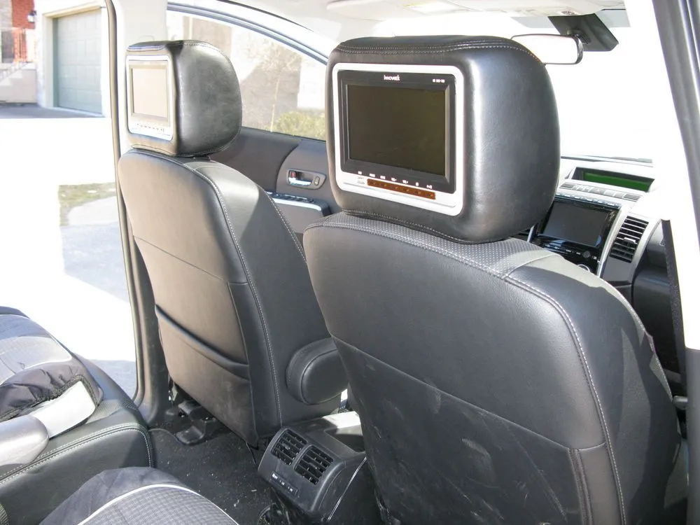

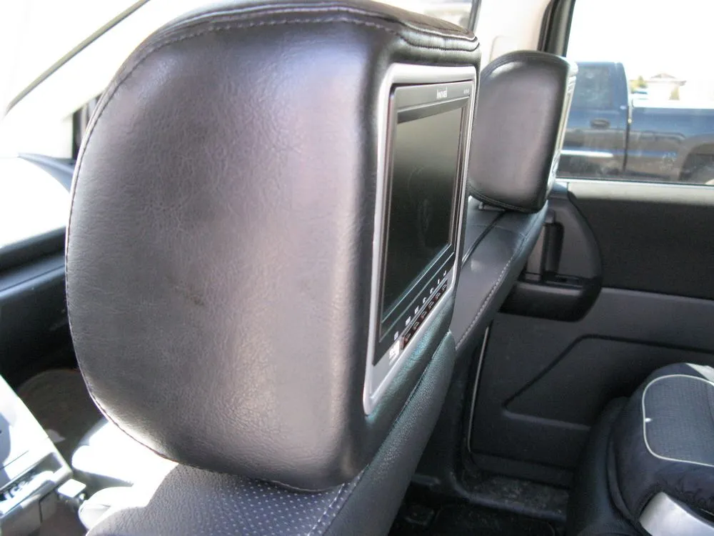

Here are some pictures of mine in our Mazda 5. Here is my web site I got mine from for $350.00 shipped. I hope its ok to post web sites, www.hsystems.ca

The install looks great!
I assume you ran the wires inside the seats since you can't see them. Did you use a gromet and cut a hole through the top?
Also, I see they list DIVX but have you tried to play any XVID off of a disk or usb stick?
Thanks for sharing!
Very easy to install, it has a special one peice cable that goes down one of the two poles down into the same hole as the pole then into the back of the seat where you get the wire from below. This wire supplies the power, audio and video together. There is a plug that ataches to the first cord that splits everything up to their proper leads ie power, audio and video. I have only have tried AVI on it so far. I use a SD card where I have 5 movies on a 4GB card, great no switching dvd's anymore. I tried the USB too and it works great. I'm very happy with these units.

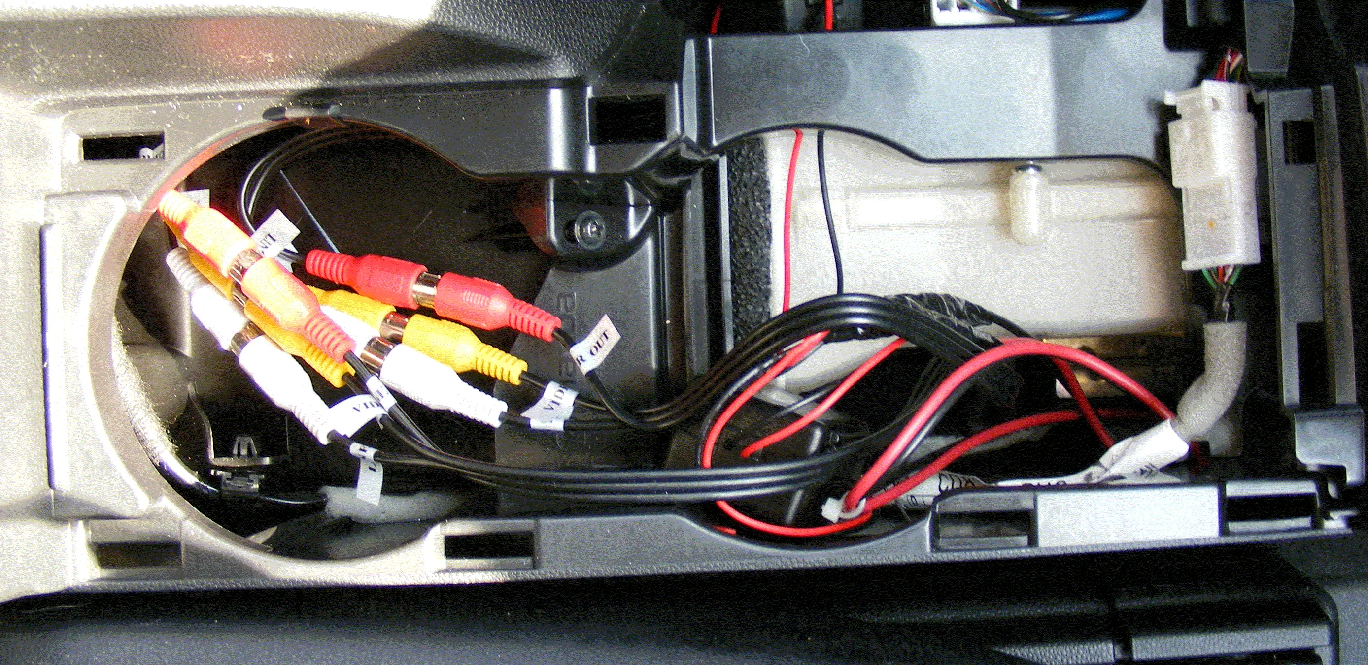

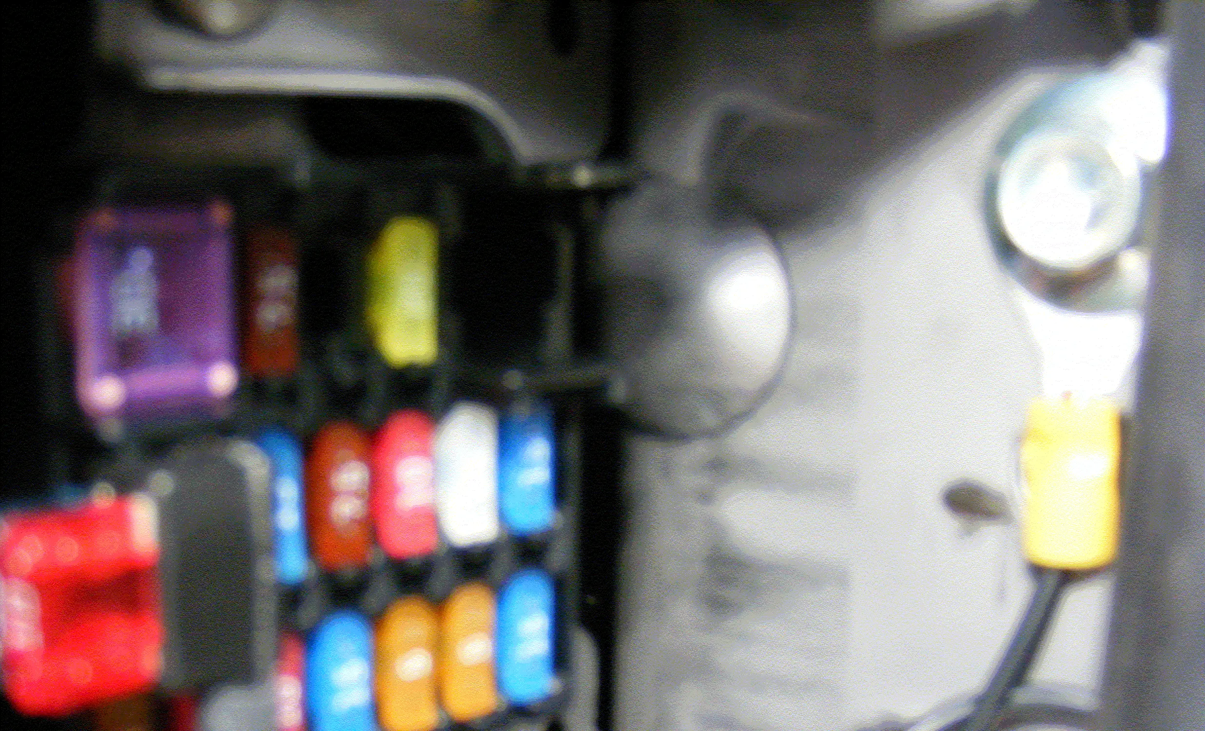

I installed my headrests today. This was much easier than I expected! For reference, my past car install expierence consists of adding lighting under the dash and adding an amp to an existing radio system, so I am NOT an expert at this type of thing!
The entire project including clean up took about 1.5 hours.

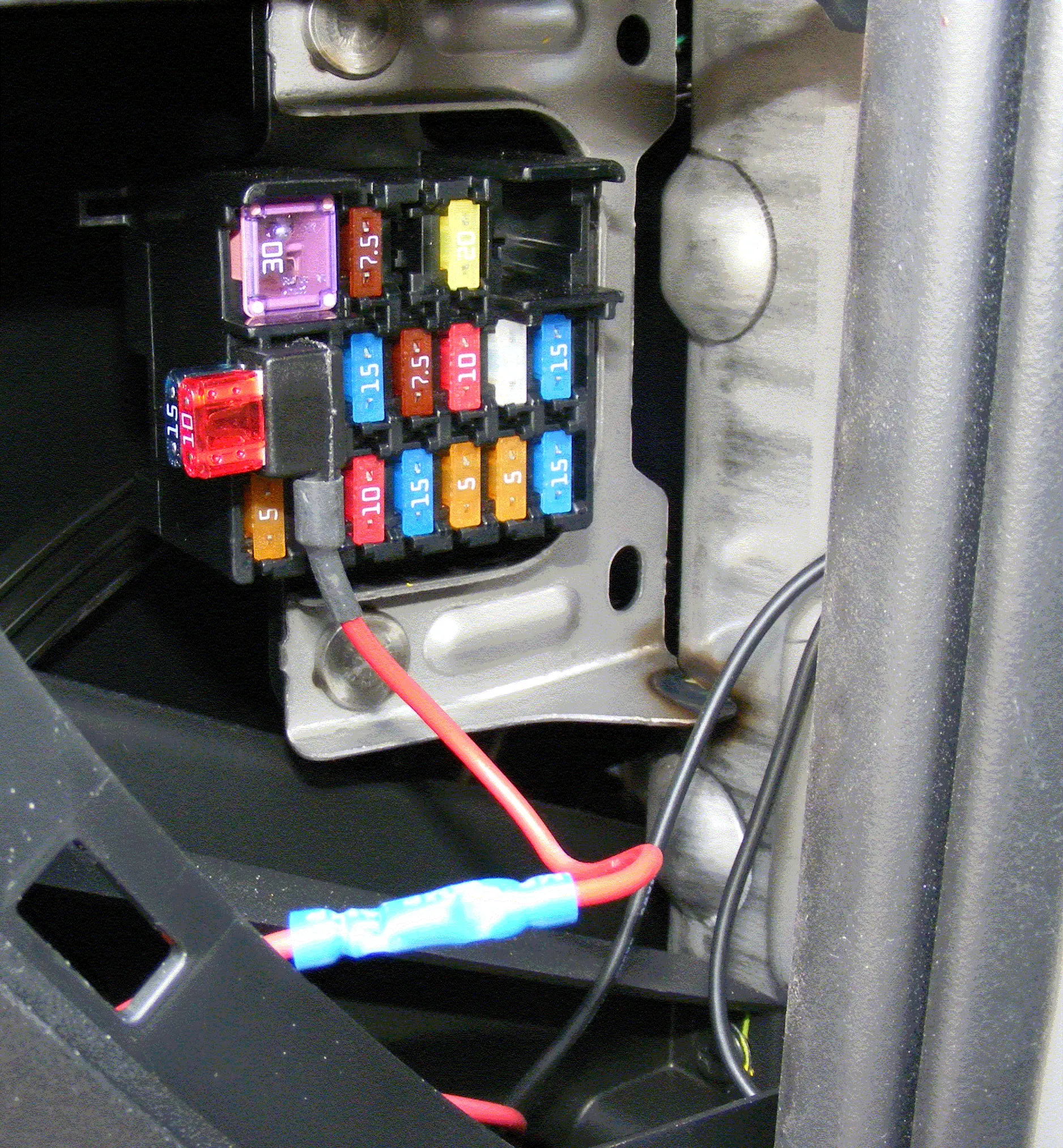

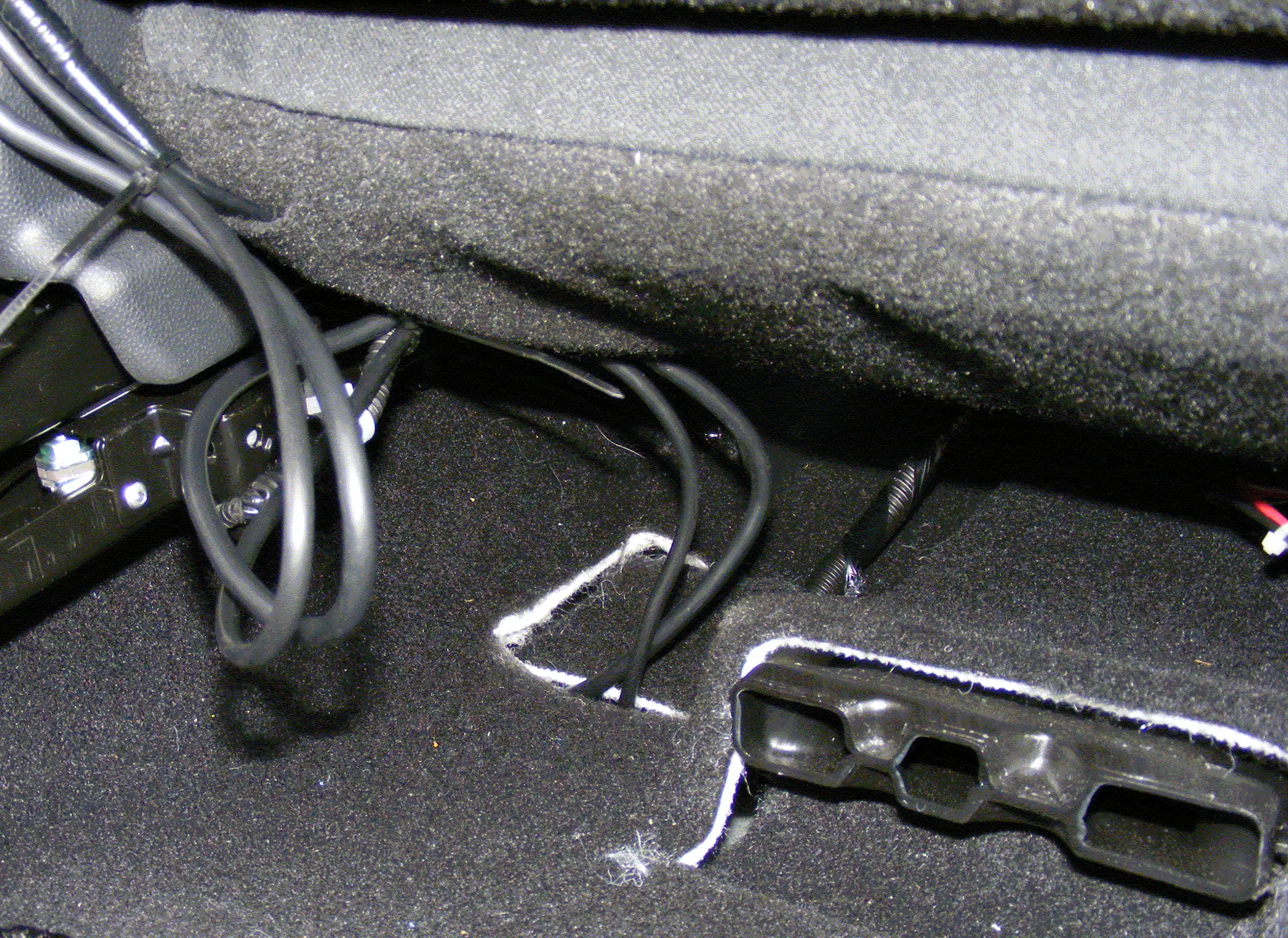

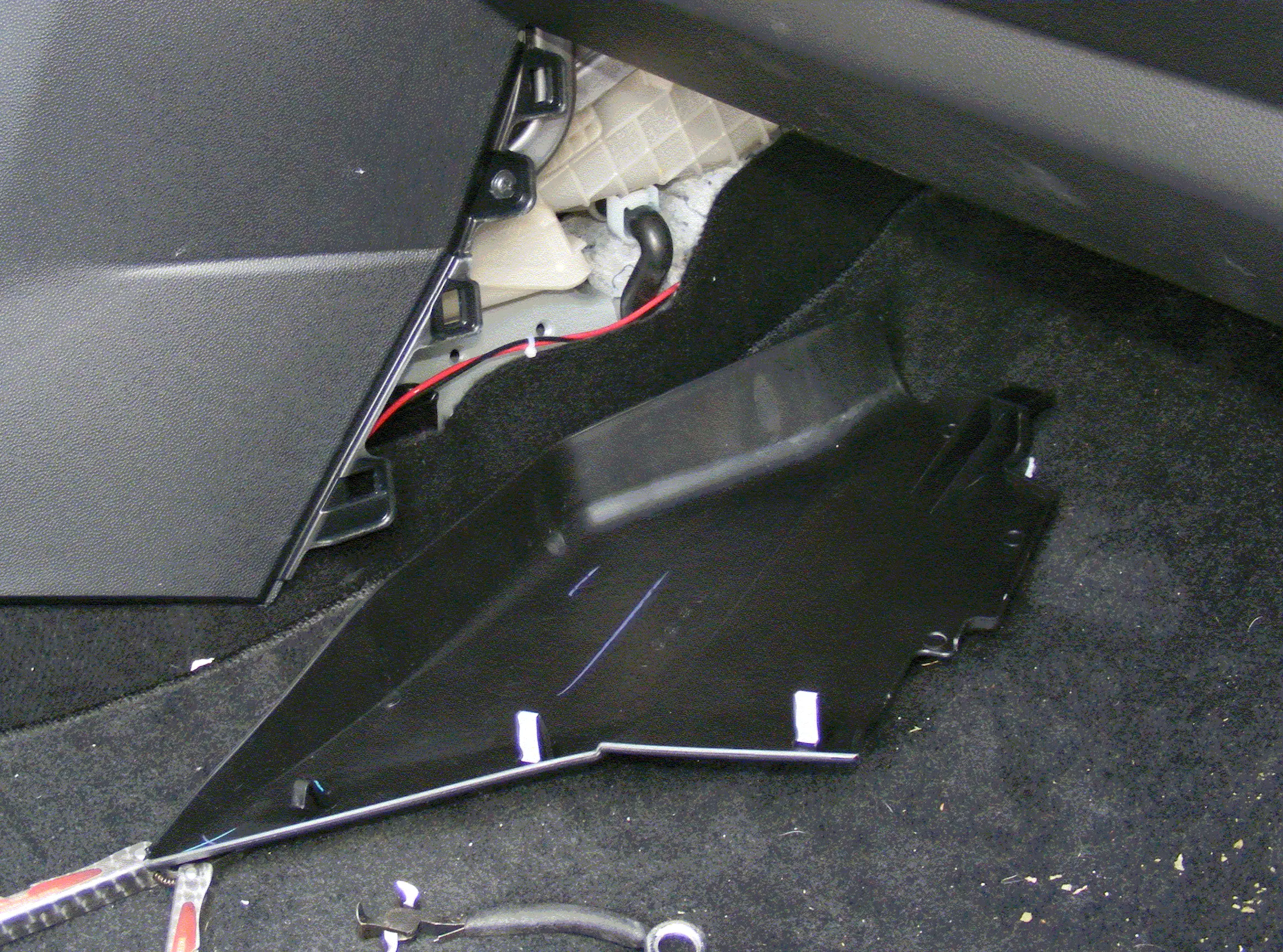

To connect to power I used an Add-A-Circuit https://www.amazon.com (commissions earned) This is a link to them on Amazon. I found mine at Autozone for $5.99. I grounded the units to the bolt inside the fuse box area on the passenger side of the car. The cable was ran under the carpet against the firewall and into the area under the cupholder. The cupholder just pops out if you wiggle it. There is room under the cupholder for all the electrical/video connections. The cables to the headrests I ran through holes already in the carpet under the cupholder to some holes I found in the carpet undet the seats. The cables then just ran up into the seat and connected to the DVD player.
Where is the closest/easiest point to tap into power for these?
I used an "add-a-circuit" at the fuse panel next to the passenger door hinge. There's also a conveninet bolt to attach your ground wire. The door sill cover just pops off so you can easily (and safely) hide your wires.
