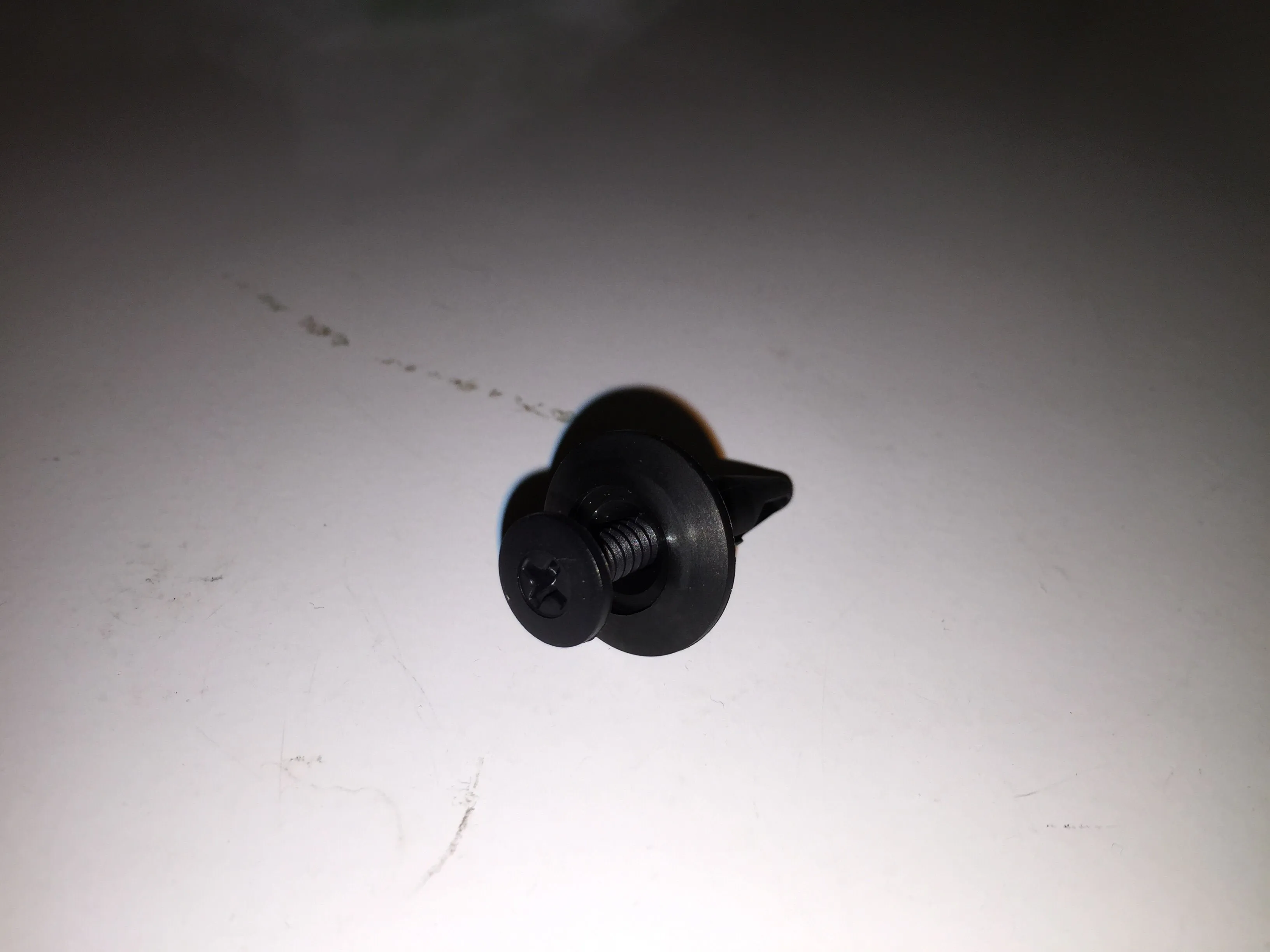

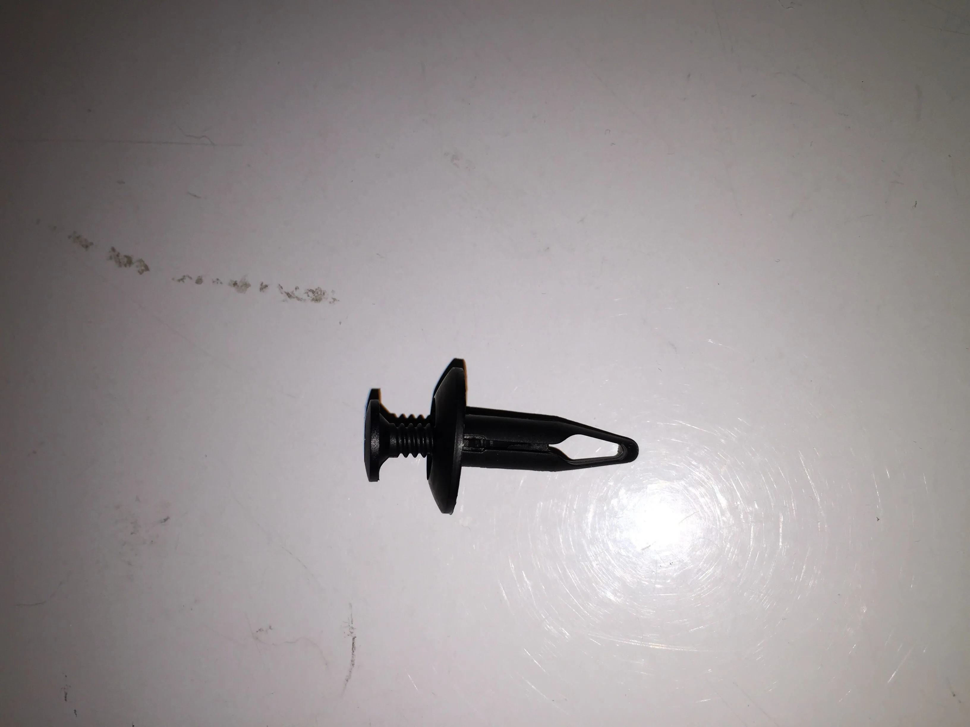

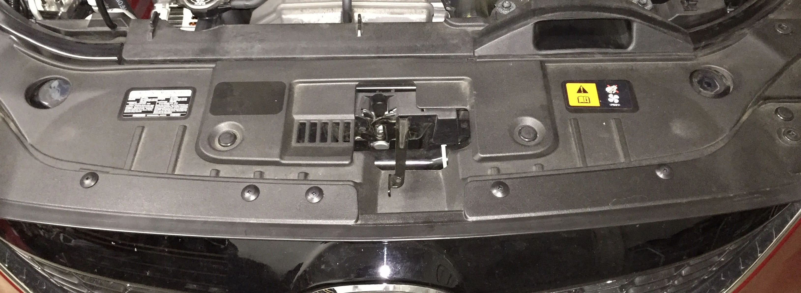

2015 cx5 has a modified top plate where a metal bar is attached to the bottom of the plastic plate. This makes removing it impossible without damaging other stuff. I drilled out the rivets only to find out I could not remove he top plate. Frustrated, I explored other possibilities and I was able to lift the top plate just enough to reach in and install a second high note horn (from Mazda 6). All could have been done without drilling out the rivets.
I also a found an alternative solution to reinstalling rivets. 50 cents solution from ace hardware, just need to enlarge the hole a tiny bit.

Finish look of rivet substitute.

Because I compared mine 2015 with pictures from the 2013 CX5, there are differences. The addition of a u-shaped metal bar on the bottom of the top plate, there is no way you can remove the top plate without removing the bumper. You are in no position to challenge me without looking at the 2015 model.
There are five rivets in 2015 compare to the 2013 there are only three. There are differences, I am just trying to point out that there is an easy way without drilling and without removing the top plate. If you feel offended because you did the hard way, that's too bad.
Can you elaborate a bit on this? Did you pull the other (non-rivet) connectors and then just pry it up? Lift from the back? Haven't tried this yet, but always looking for simpler!

I just did this mod and I drilled the rivets and lifted the top. I wasn't that hard.

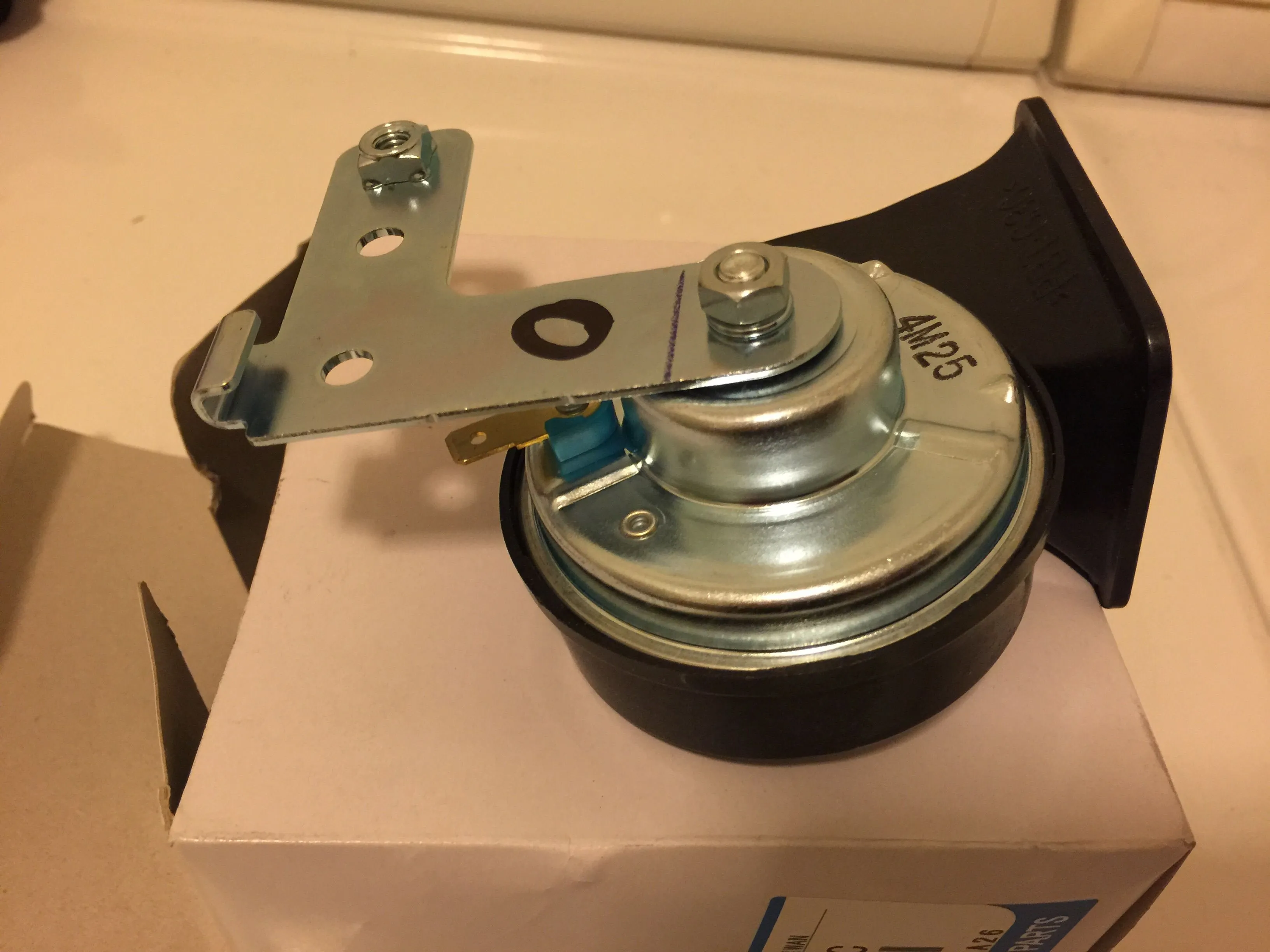

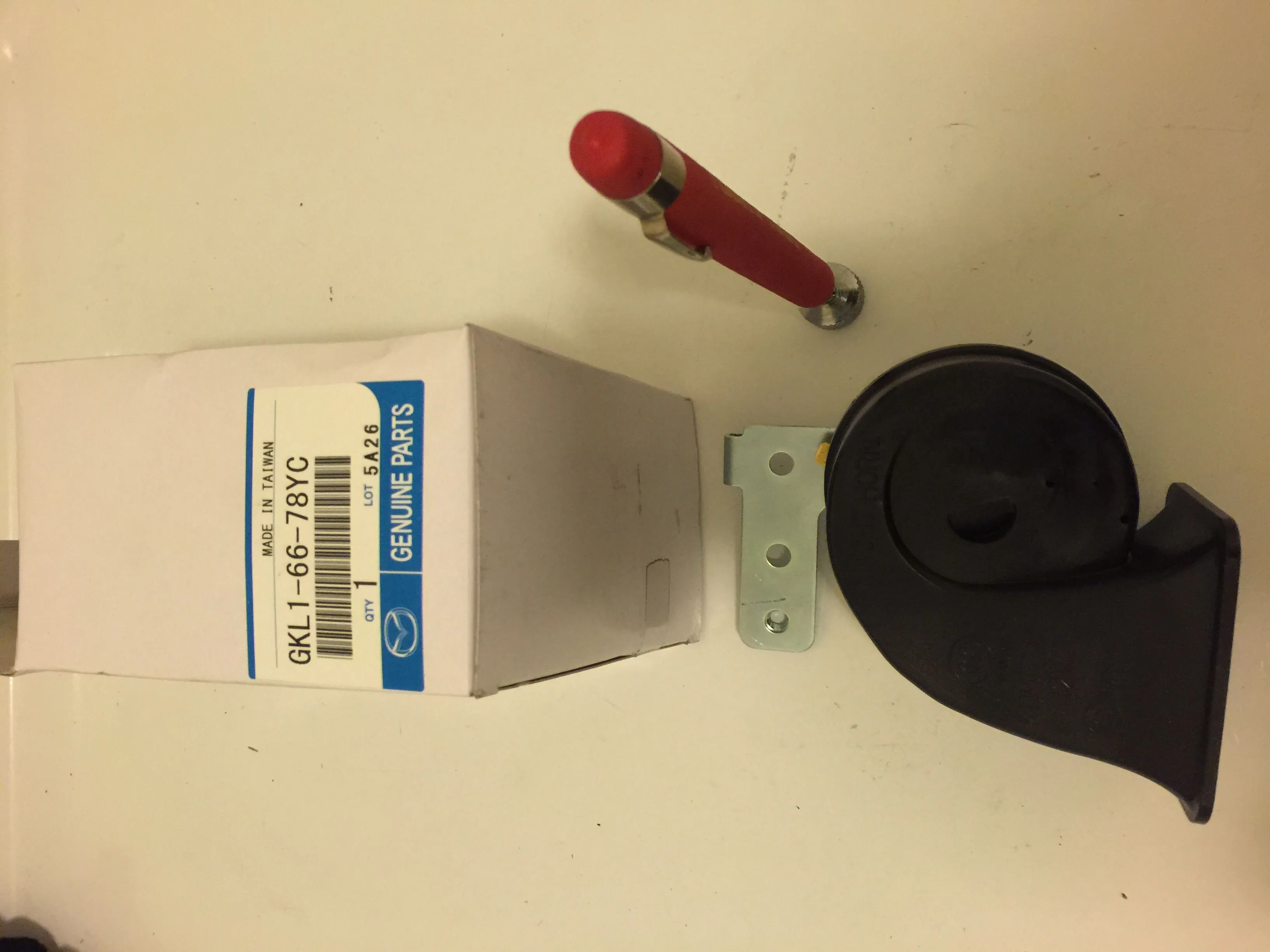

I'm picking up a Mazda OEM High Note horn tomorrow (gkl16678yc or d). I just want to clarify the wiring. The horn self grounds through the mounting bolt, right? Then all I need to do is run a wire from the existing low note (left side) to the new high note, right?
Thanks in advance.
C.

Basically the things that I need are:
high-note horn
16 gauge wire
loop connector
spade terminal
do I still need a wire tap connector?
In this image, the wire encircled in red is the wire going to the vehicle's power line? How will you connect this to the power wire? if possible would you be able to post a pic of your installed horn showing the wires? Sorry to ask so many questions. :)
