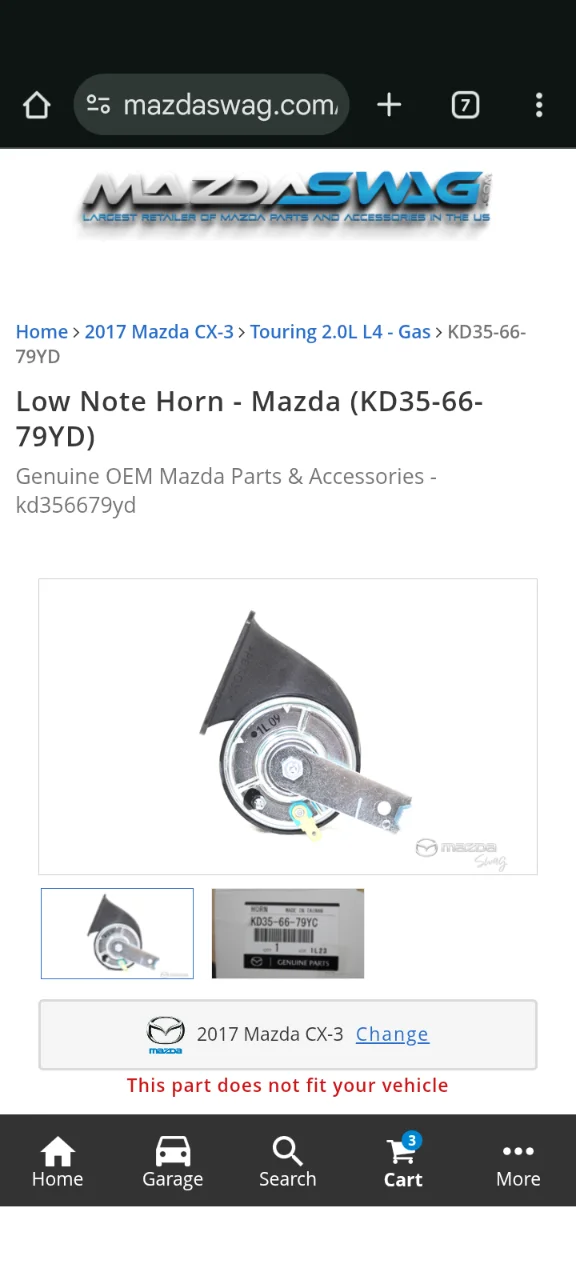

I tried to replace the horn today but failed. I wasn't able to remove the front bumper so I reached in from the grill slats and top trim. After getting the stock horn out, I realized that I need a few more components to install the Hella Horns. After putting the stock horn back, it wouldn't sound any more. It was very low before, now it's mute. 😂 Even the alarm won't sound when I lock the car.
There was a lot of sand and small debris inside the snail. It took a lot of shaking to get everything out.
The stock horn looks exactly like this one, with only one spade (?) on the back and connected with only one wire. (All other horns come with two spades on the back.) There wasn't anything connected to the screw on the back. There is a thin wire that looks like a ground connection that is connected to the top of the mounting bracket which the horn is attached to. It doesn't appear that the screw makes contact with the bracket though.
One YouTuber was able to replace the stock horn without removing the bumper ("skinny arms for the win", and in his video, there wasn't another wire to watch out for. What did I miss?

I declared the attempt a failure when the horn made no sound after it was connected to the wire and before it was mounted. The bracket must have worked as a ground connection somehow. After I secured it back to the bracket, the sound is at a healthy level, not loud, but not weak either. It was all the sand and debris inside that made it quiet. I was about to use a Bluetooth speaker to play horn clips on my phone. 🤦
