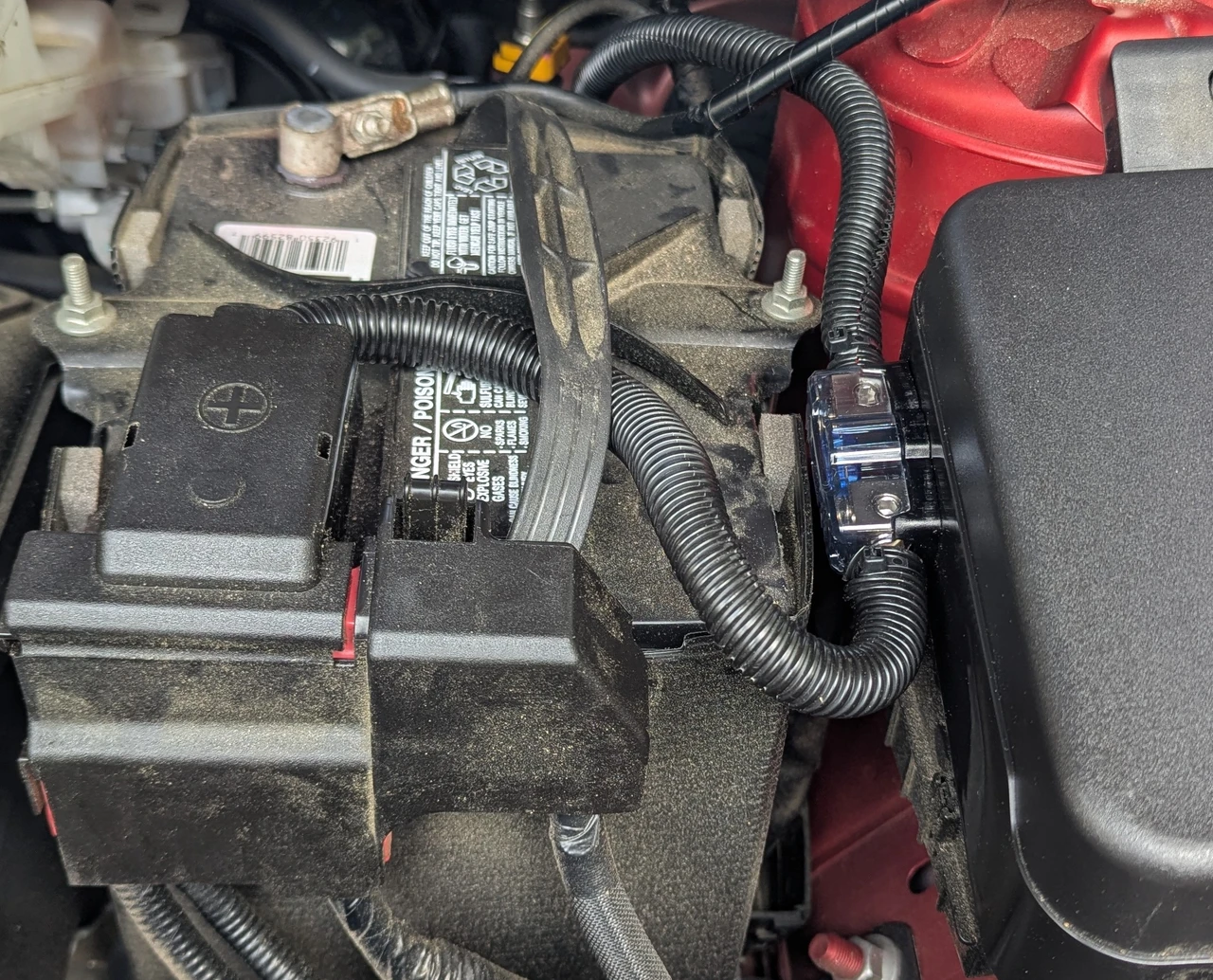

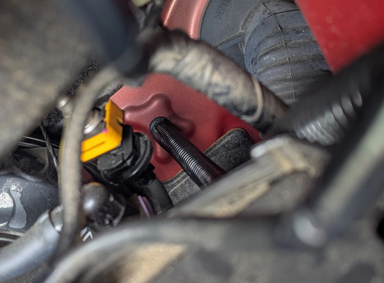

I used 4 gauge OFC welding wire for my power wire, and there's a perfect spot under the hood directly behind the battery in the shape of a "dogbone" that is perfect for punching through the firewall. There's absolutely nothing on the inside anywhere near that spot in my car, but check yours to be sure. I used a rubber grommet to protect the wire.
The fuse I simply attached to the side of the factory fuse box lid. I used short machine screws with red loctite so they won't back out.

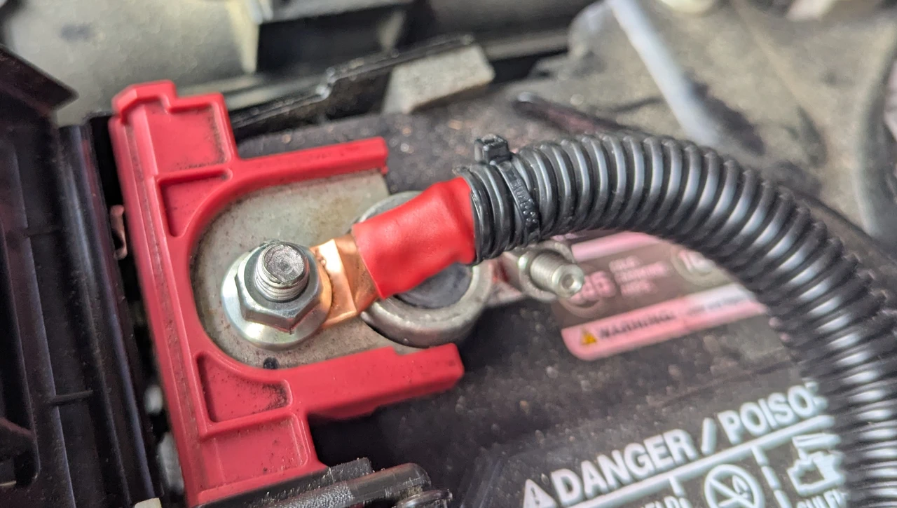

It's almost like Mazda knew that I can't leave a stock stereo alone! They have a large lug on the terminal for attaching accessories, so yup, use it!

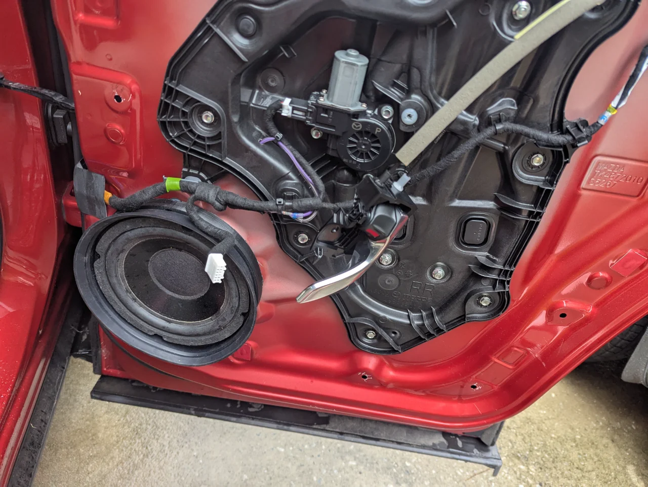

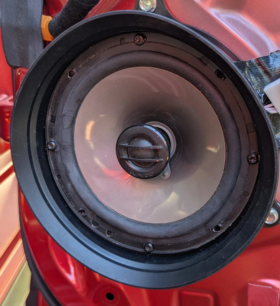

Rear door speakers are JL Audio C2-650X coaxes. Honestly? This was a waste of money. The factory speakers back there would have been fine, and I'm being serious. Don't make the same mistake I did. Luckily, I got these used off of eBay, so I didn't spend nearly as much as they would have been new, fact is, about 1/3rd the price as new.

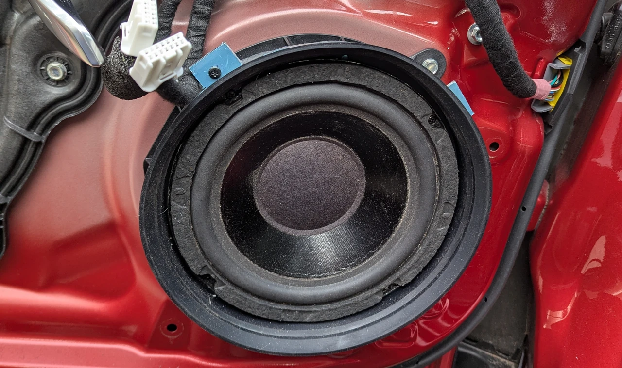

Front door speakers I went with Linear Power LP8.0's. These speakers are nothing short of incredible. Absolutely mind boggling. They are so damned good, you absolutely, DO NOT NEED any type of subwoofer at all. Yeah, they're just that good. I can't give these speakers enough praise. Buy them. I mounted them with the factory Bose door adapters, part number KD45-66-A61. They are made for the Bose 9's, so they are slightly too big for 8's. I simply made an adapter plate out of 1/8th inch aluminum to go from the speaker to the factory bracket. I used the factory speaker wiring. Done and done.

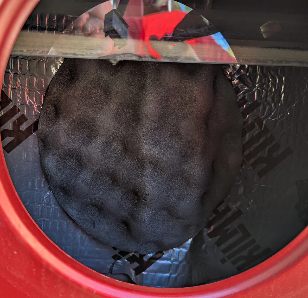

Inside of all 4 doors, I added Killmat soundproofing, as well as the rear wave cancellation foam that came with the NVX silicone speaker rings that can be seen in the above pics.

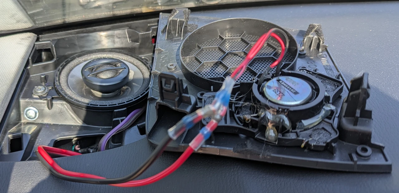

For the dash speakers, I went with JL Audio C2-350X's, as they fit perfectly in the factory openings. I also went with the JL Audio C2-075ct tweeters. I found a set of Bose dash grilles on eBay, ordered them up, and used hot glue to mount the tweeters in the factory locations on the grilles themselves. Pretty easy! To wire them, I dropped two runs of speaker wires straight down through the dash, and then over to the door sills, then to the amp. The reason I had to run new speaker wire is each speaker in the car is driven off of a seperate amplifier channel.

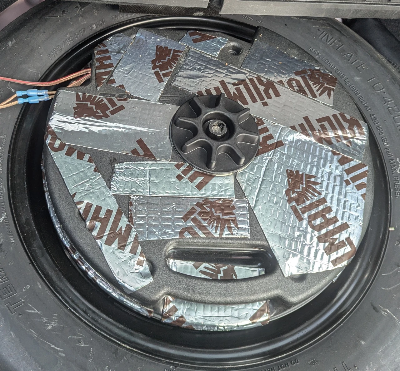

Finally the subwoofer. Like the rear door speakers, totally unneeded because of how powerful my Linear Power door speakers are. But this is a factory Bose subwoofer box that I pulled apart, stuffed with polyfill, and then put Killmat all over it. Does it work? Yeah. It does. But it's also totally unnecessary. Again, this came off of eBay, so the hit to the wallet wasn't as nearly bad as it could have been.

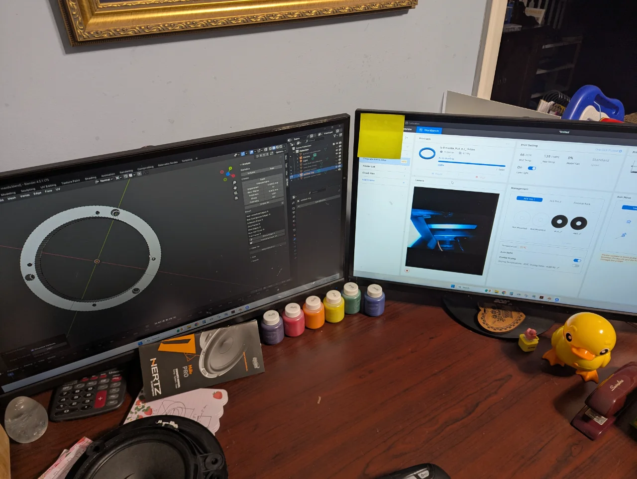

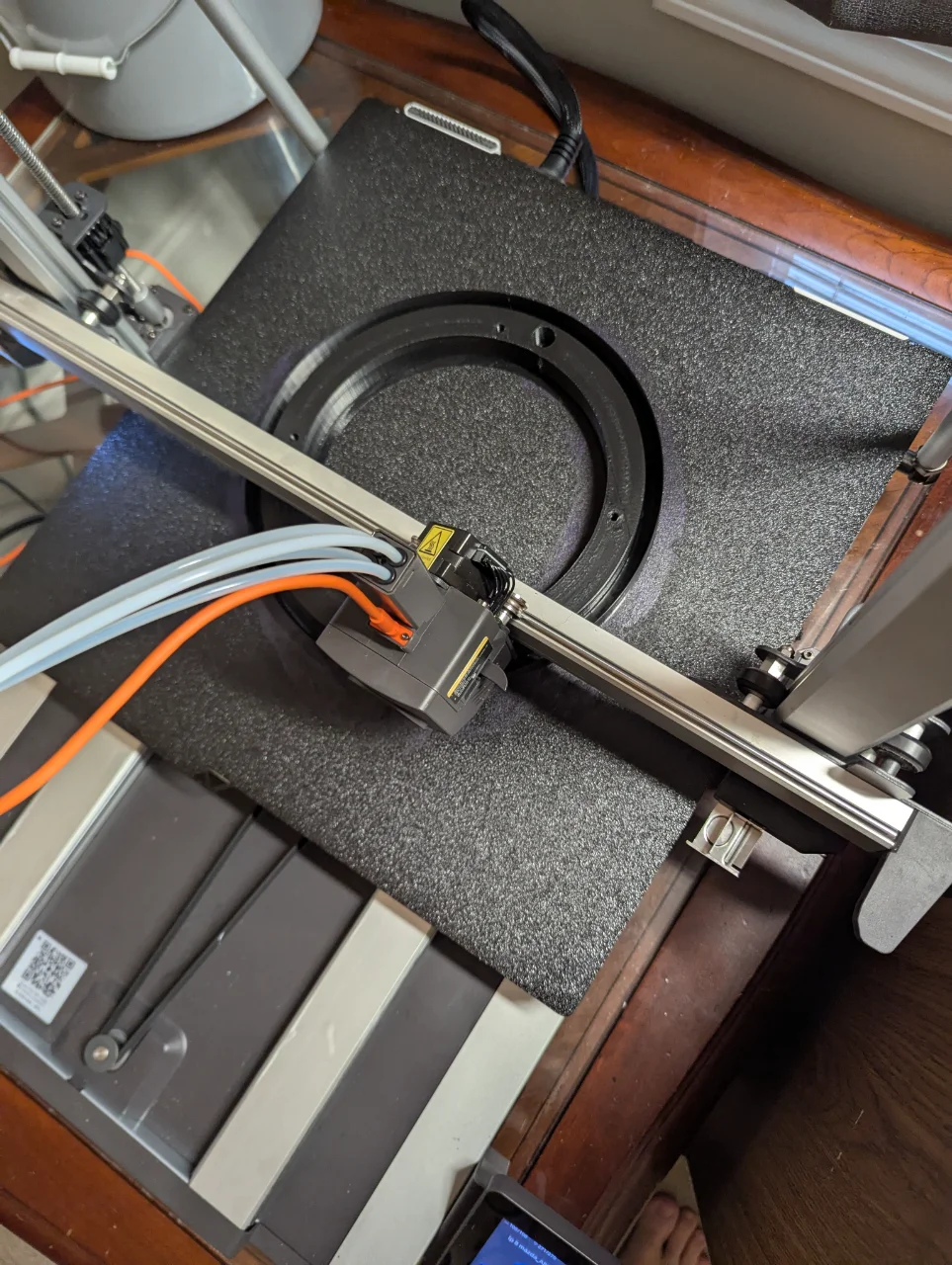

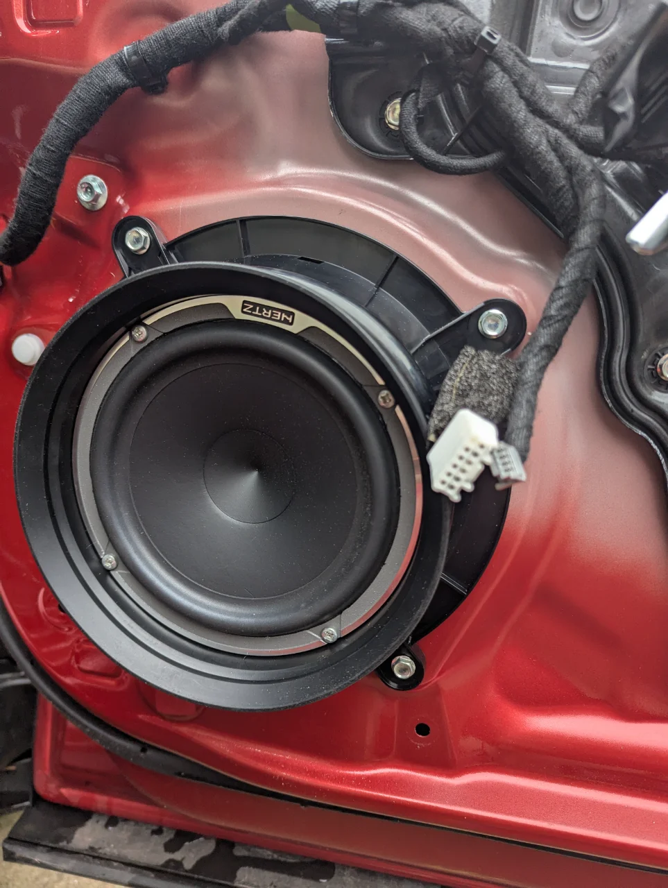

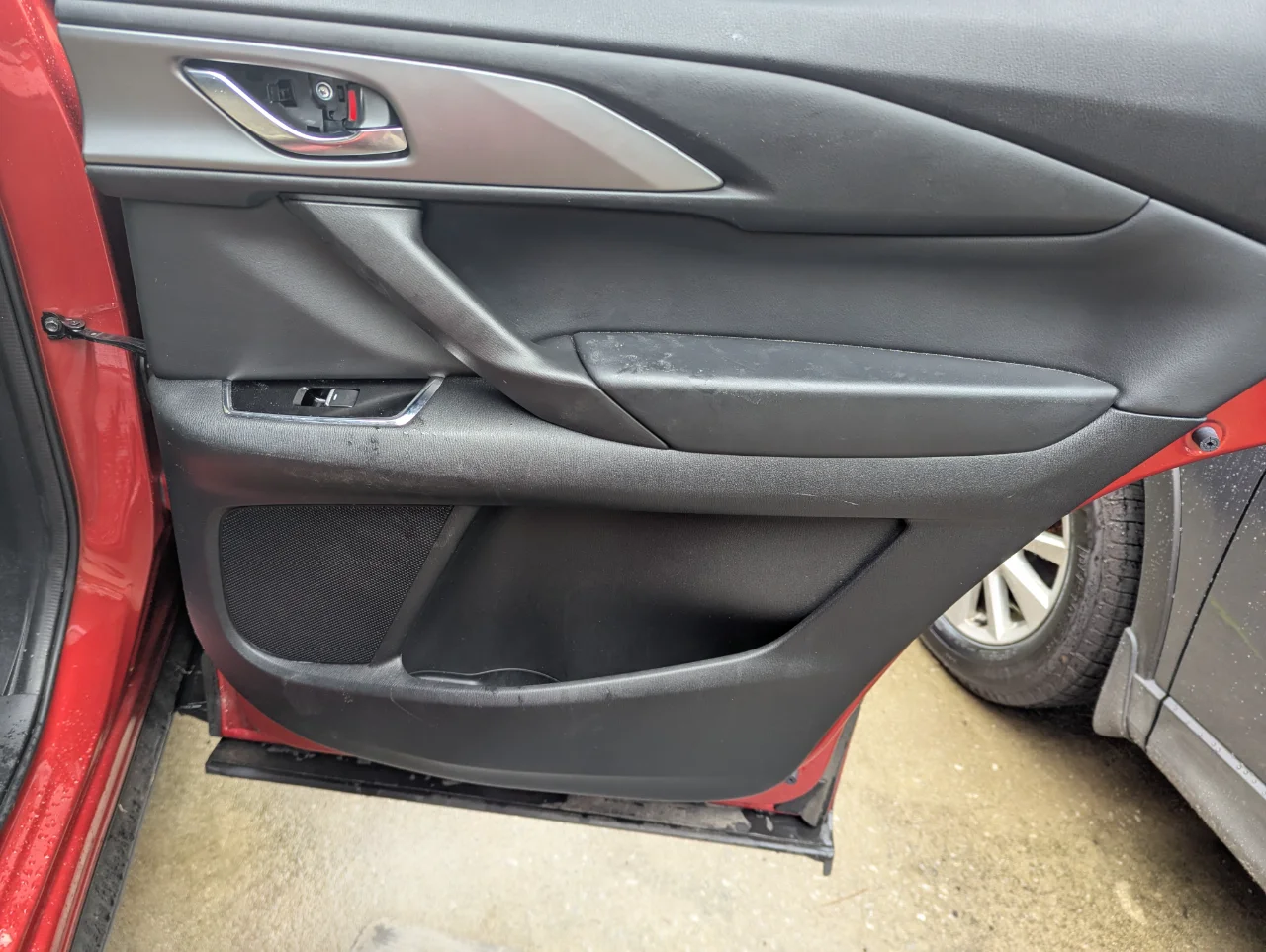

2 days of drafting, 5 prototypes, and the adapter works, and the Linear Power LP8.0's dropped in the rear doors in place of the otherwise useless rear speakers and Blows subwoofer in the back. I did have to use tin snips to trim a bit of the door metal, but no biggie. A little rust prevention primer and paint, and she's good to go. And yes the door panel goes right back on perfectly.

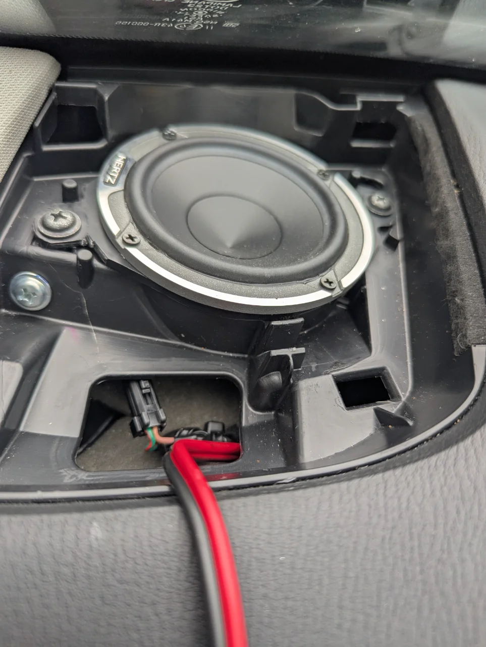

JL Audio speakers in the dash are also gone in favor of the Hertz Mille Pro MPK 163.3 set up front, Linear Powers moved to the rear doors for sub duty, (and they SHINE like that!), all active on an Alpine PXE-C80-88. I can't do a traditional sub in the rear, because this CX-9 is the primary family hauler, and the hatch is used all the time for odds and ends and various sundries. Half the time we use it for Home Depot runs instead of my truck!
