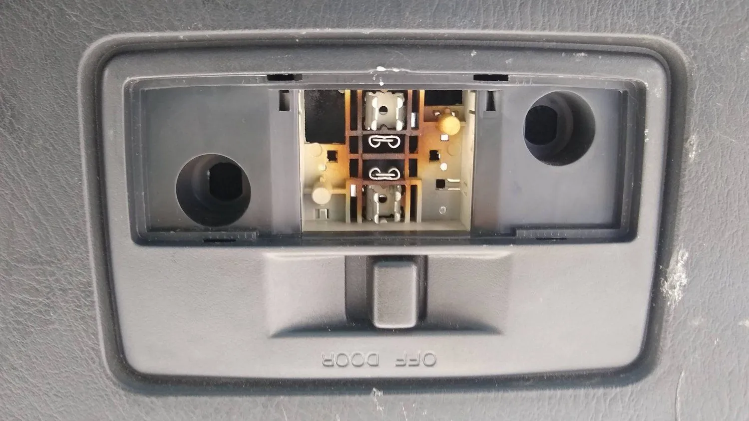

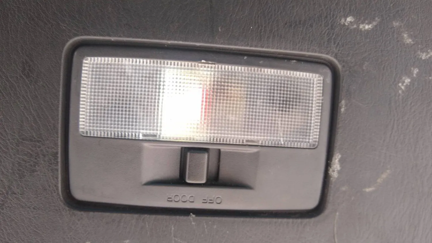

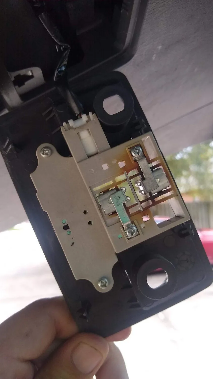

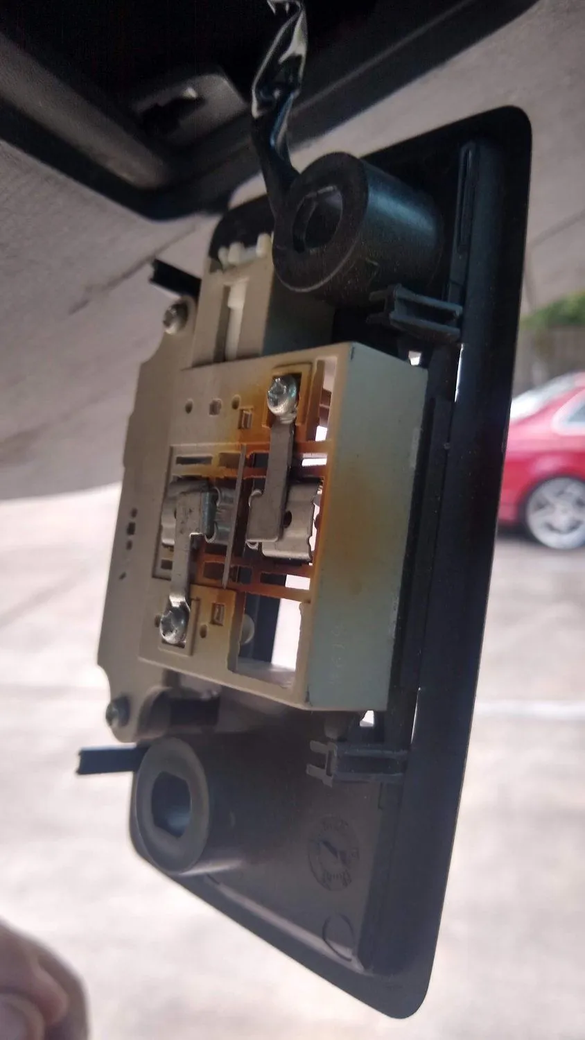

I have a peculiar problem I am troubleshooting in my 07' CX9. The vehicle will not lock unless the door light on lift gate is switched to the ON position. That same light will not dim/turn OFF when lift gate closes and locks. The light stays on, killing the battery and reaping havoc.
I included pics of the lift gate light switch in black that appears burnt. Possibly from the LED light I put in a few years ago, idk.

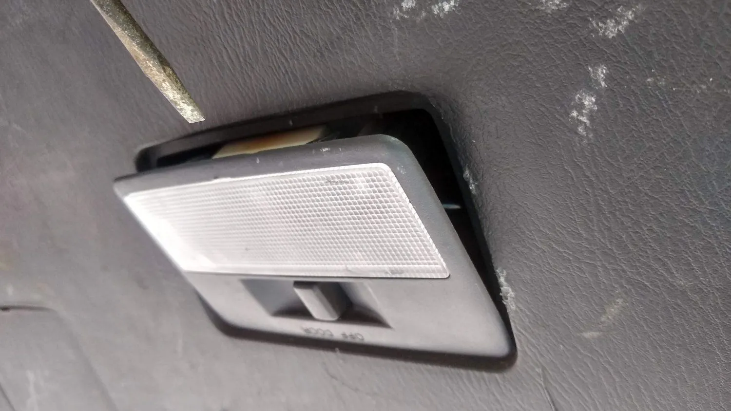

Also, my center ceiling light is messed up, the switch broke and it just slides back and forth freely. I haven't taken that one apart to see if I can fix it yet.

That is very odd. As a temporary fix have you tried locking it with the tailgate light bulb removed or with the lift gate light module disconnected?

I did try without the bulb and it wont lock, seems the light completes the circuit for the doors to lock, without the bulb, the car thinks the door is open. I didn't disconnect the light module as I do not know where that is.

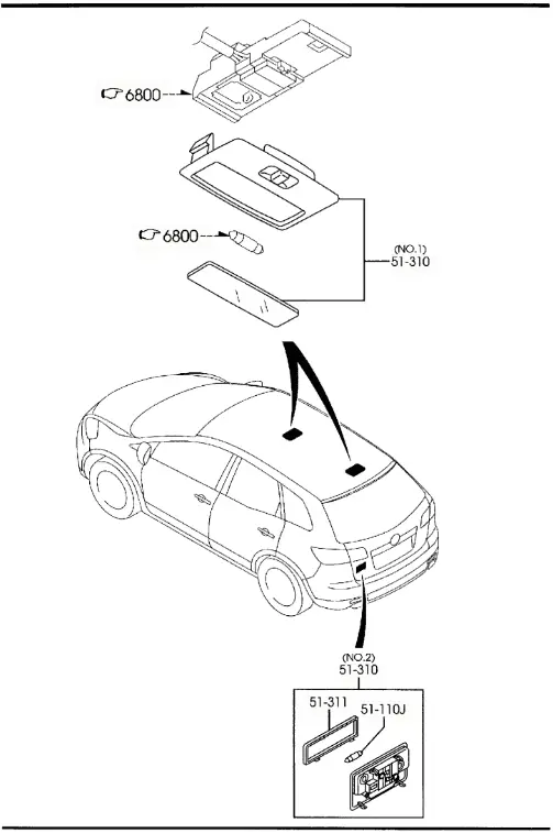

The connector to the module is white and can be seen at the top of the module on your 3rd photo. You simply unplug the white connector from the module to remove it and replace it.

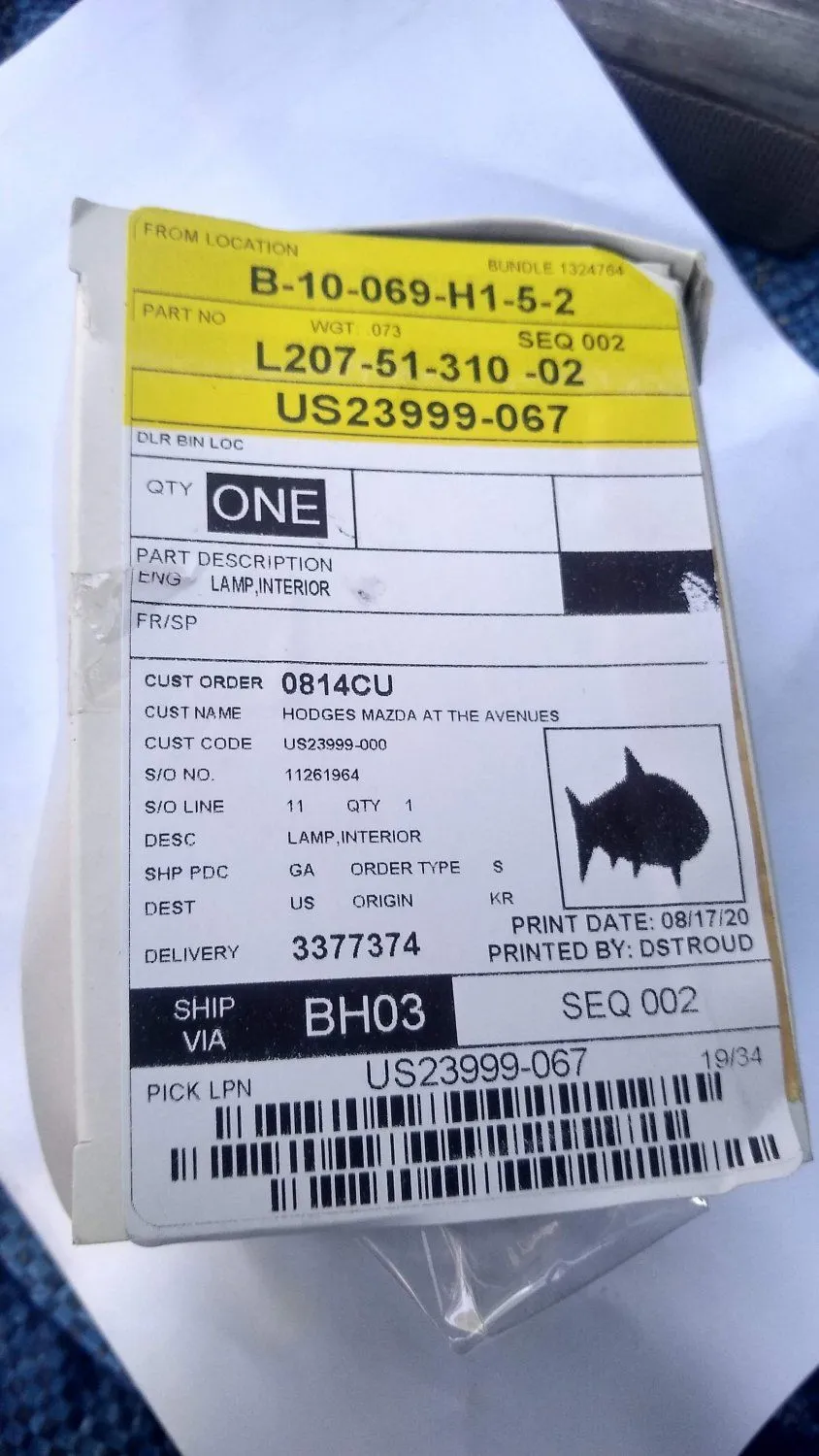

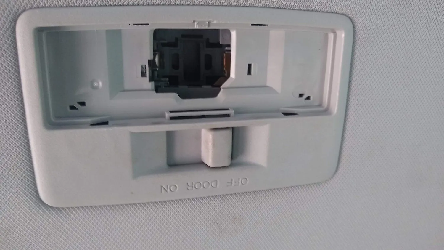

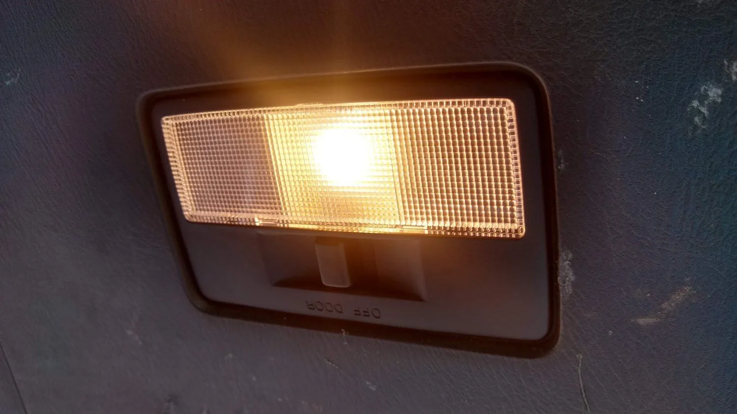

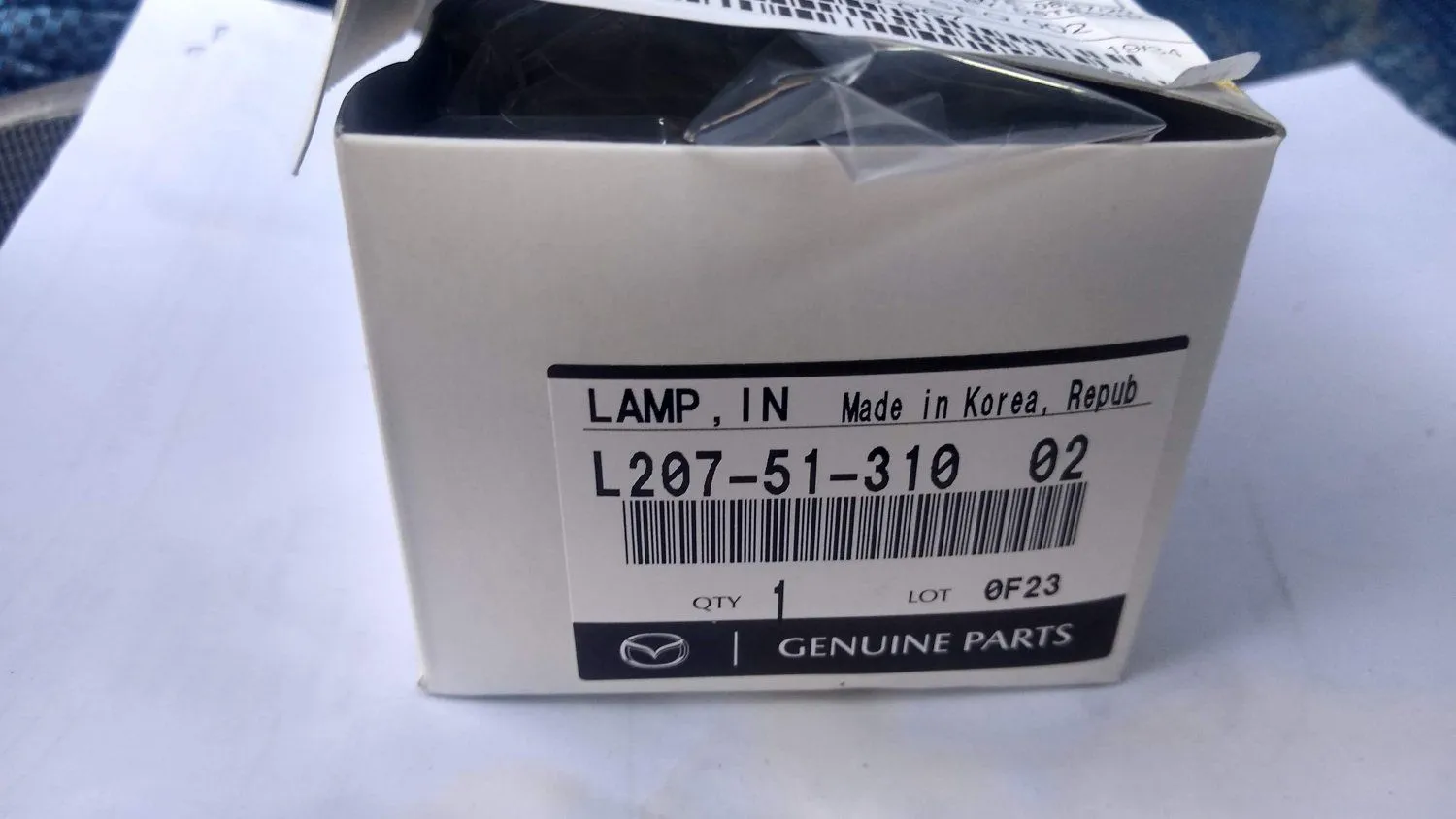

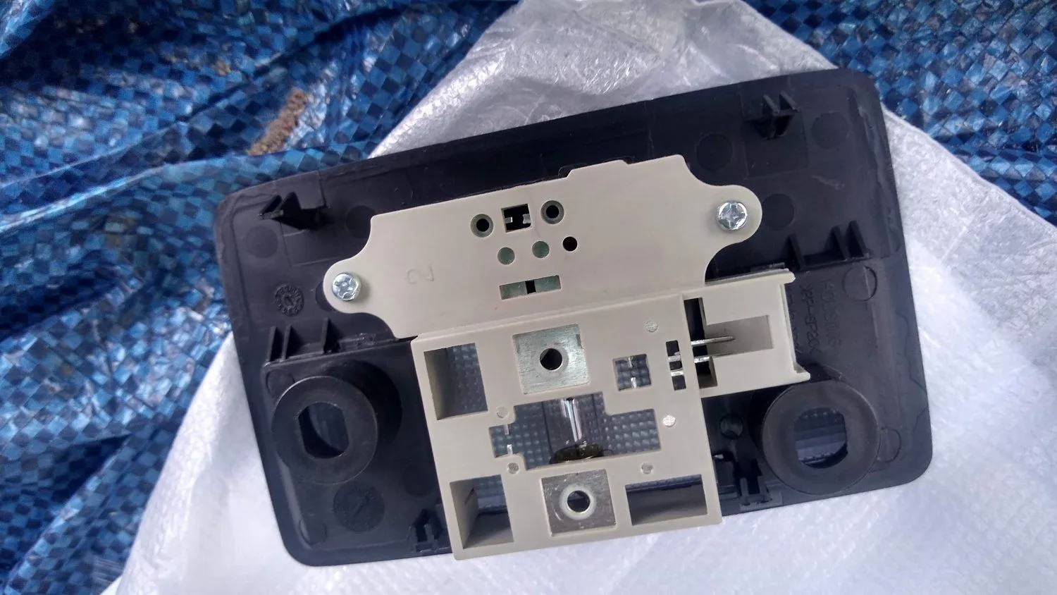

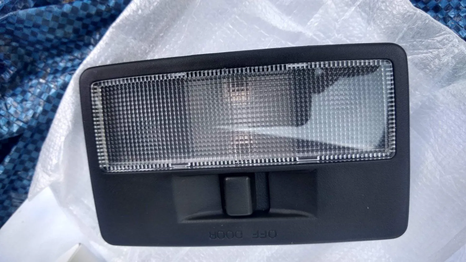

Fresh off the boat from Korea, I received my part from the dealer. With a flat head, I was able to change out the part in under one minute. Worked like a charm. I was happy paying the $32 to be able to fix this problem and lock my doors again as normal.
I would say this was caused by the aftermarket LED I used though I have no way to confirm this. So far this is the only fixture that has done this in the 100K miles I've owned this vehicle.
