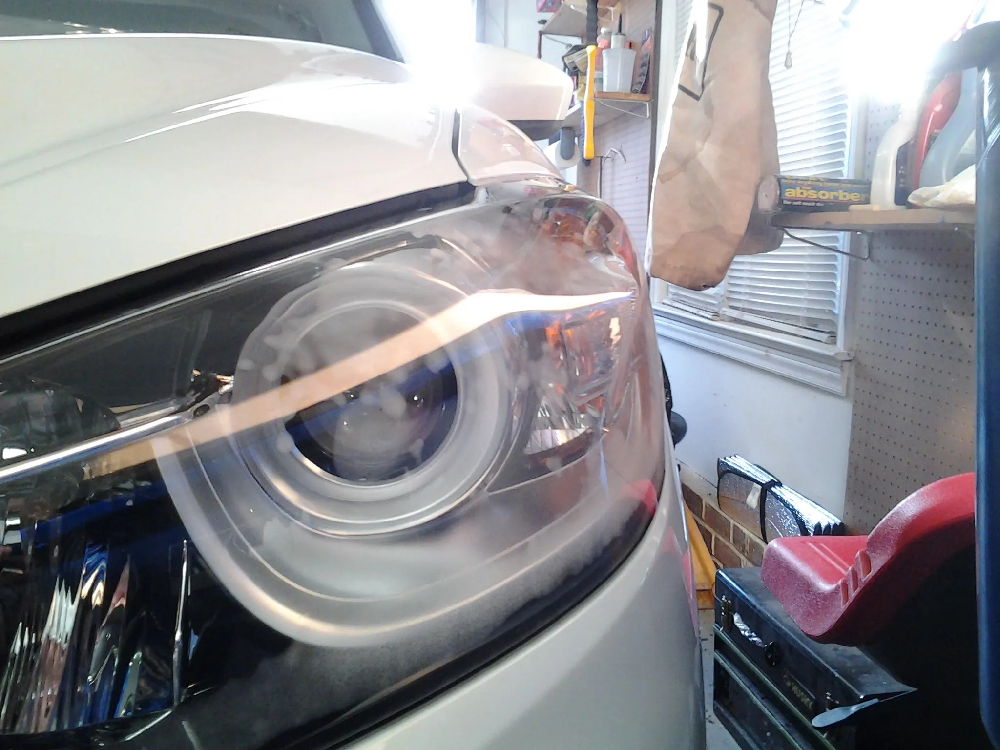

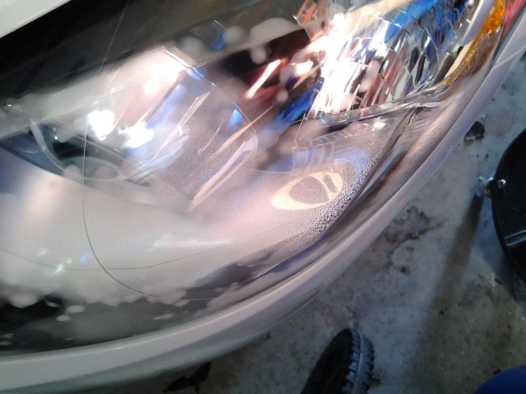

Is anyone else running into this problem? I did a search and found a thread on the CX-7, but not the CX-5.
After a good rain, my driver side headlight has condensation but the passenger side is clear.

Thanks! I took the car by this morning. The tech informed me that Mazda's process was for them to take a picture and send it into corporate for a decision. Apparently, a mist along the inside bottom edge may be considered normal, however if there are larger droplets then it is probably an issue. Mine had large droplets in the angular/pointed edge of the light and the tech thought that to be a problem.
I would think any condensation inside a sealed lens is an issue, but that is the process for this TSB.
The headlight (and taillight) housings are not completely sealed. There are even breather ports on the back casing. A slight fogging in moist situations is normal (hence the ports), but when large droplets form, it's a problem. Chances are, its a faulty bulb gasket or the sealant around the lens.
Yes, I have seen these tubes (generally J shaped rubber tubes) to allow moisture to escape on my vehicles over the years. Condensation on the inside of the lens should never happen though, that reduces the lights ability to shine ahead. Moist air needs to escape, yes, but fogging/condensing on the lens, no.
I just got a call from the dealer. The area rep who reviewed both my pictures (above) and pictures taken by the tech claim that this is normal. The lens is still fogged 3 days later but that is normal. No way. The only recourse was to wait and see if it gets more water in it. Unbelievable!

This is how it looked today.
The headlights are still showing condensation on 01/19 (this originally happened in the afternoon on 01/13). We have not had any rain since then.
I went back to the dealership today (8 days after initial issue) to document that there was still condensation in the lights. They noted that it "looked better" than before and would contact the district rep again. IMHO, it does not look better. The water usually condenses on the lens but when it gets cold, like the last few days, it seems to go to the bottom of the light and then rises up once it gets warm again.
