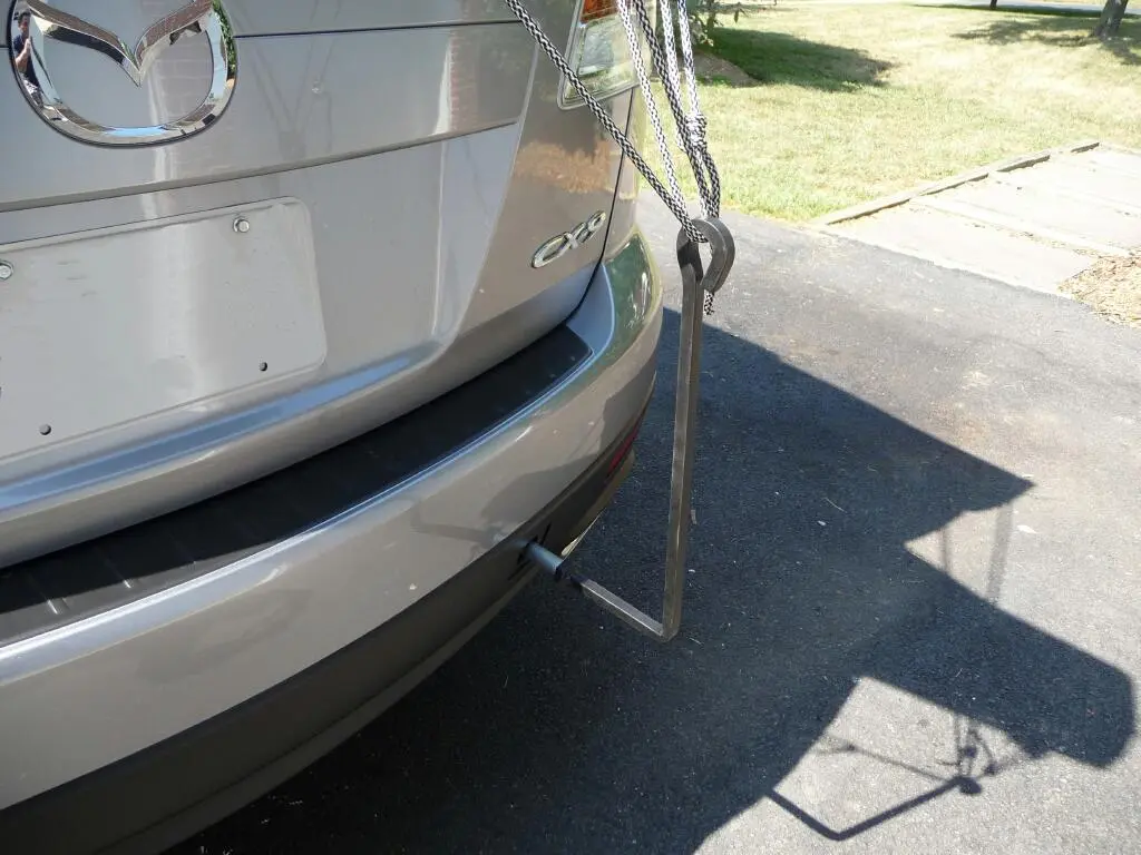

i'm not clear on what the rear tie down looks like/where it attaches to...probably b/c i've never owned a SUV/CUV and have therefore, never tied anything down to my bmw coupe before...could you elaborate a bit on the rear portion with a pic perhaps?
thanks!
scratch on the pic - i just viewed a different thread of yours with a picture of the rear tie-down...
so it would appear that to use the rear tie down application, one would have to have the tow package in place?
(which i don't - does anyone know how much that would be to get the tow package put on?)

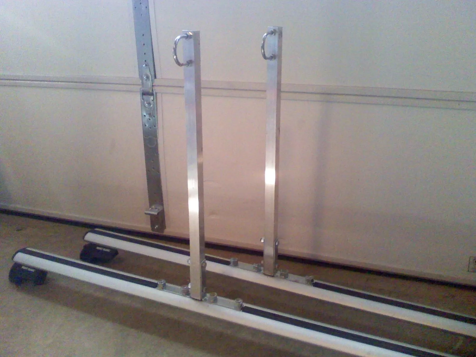

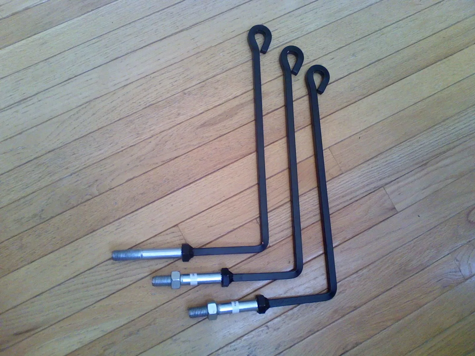

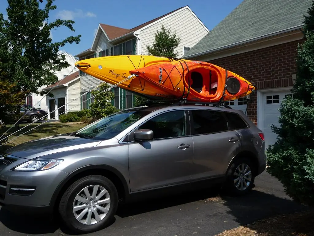

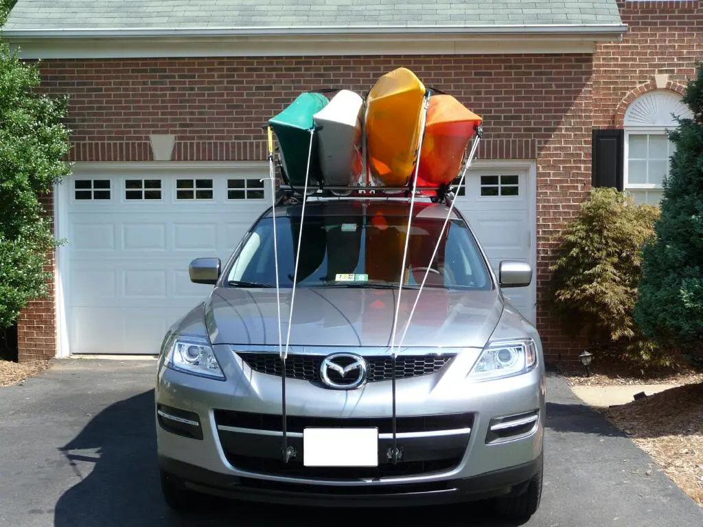

Hey CX9 SportOwner, thanks for the great idea and tips on the tie down bars! Also thanks for the recommendation on the Mont Blanc crossbars. They work great and fit perfectly. I needed the longer bars and strength (Mont Blanc vs. factory) to carry 4 kayaks.

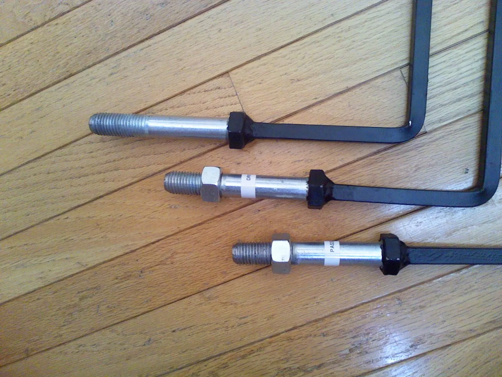

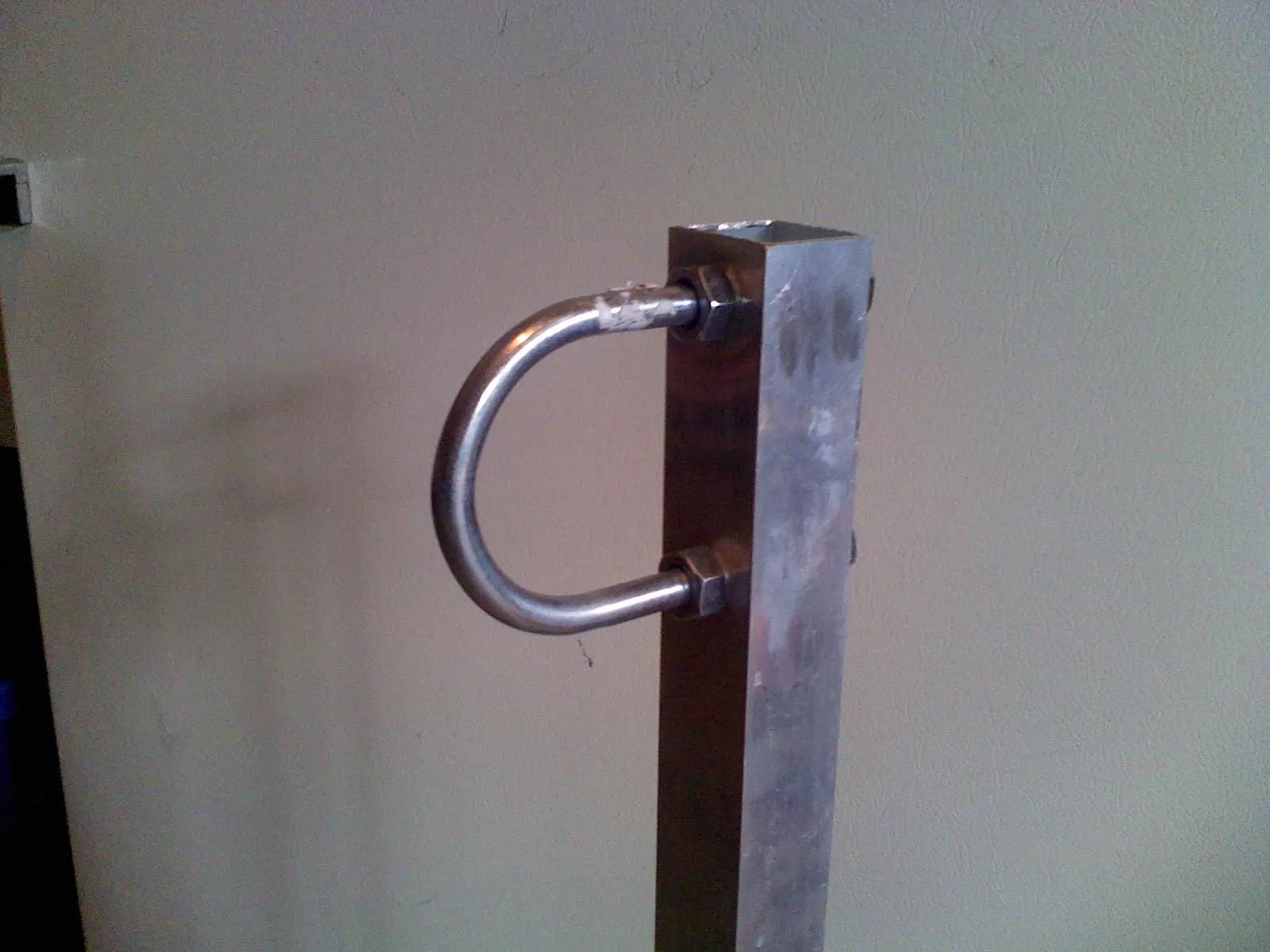

For the tie down bars I fabricated my own version using 20mm bolts and nuts (purchased from www.mcmaster.com) and welded some bent square stock to the top of the bolts. I then covered the tie down bars with Plastidip paint.

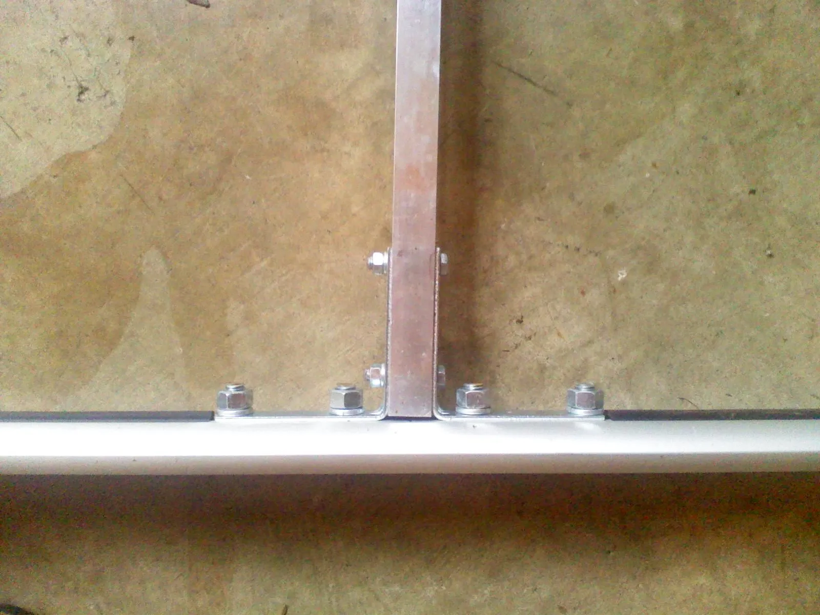

I also made my own kayak stacker using 1" aluminum square tube, corner braces, and 1/2" carriage bolts, that I milled down and lathed so they would fit the track slot on the Mont Blanc cross bars.

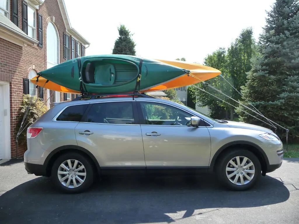

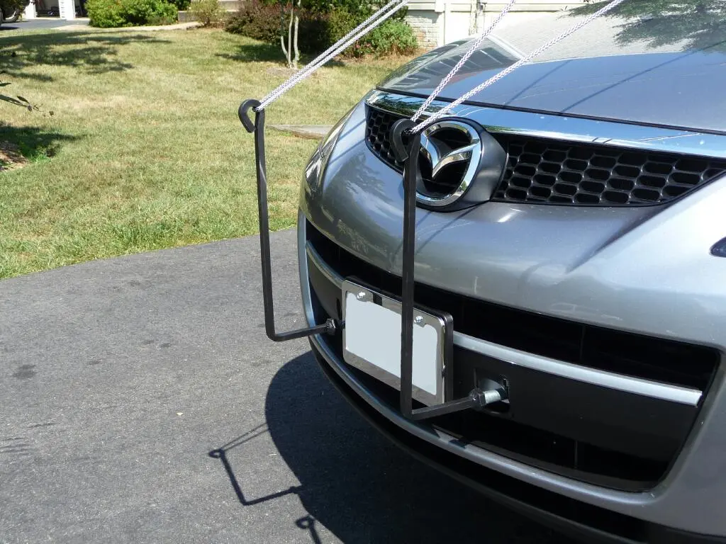

Tie Down Bars
Thanks. They don't seem to flex much at all. The square stock is pretty tough to bend. I also don't wrench down the boats, I just make sure the lines are nice and taught. I like those rope ratchets too, they work nicely. The boats are held very firmly by the tie down straps, and the front/back tie downs are mostly there for additional safety. No whistling or any extra noise from the front bars, but then again, the boats on the roof make enough noise to drown anything else out. When I install the tie down bars, it looks like I'm winding up the car. heh.
