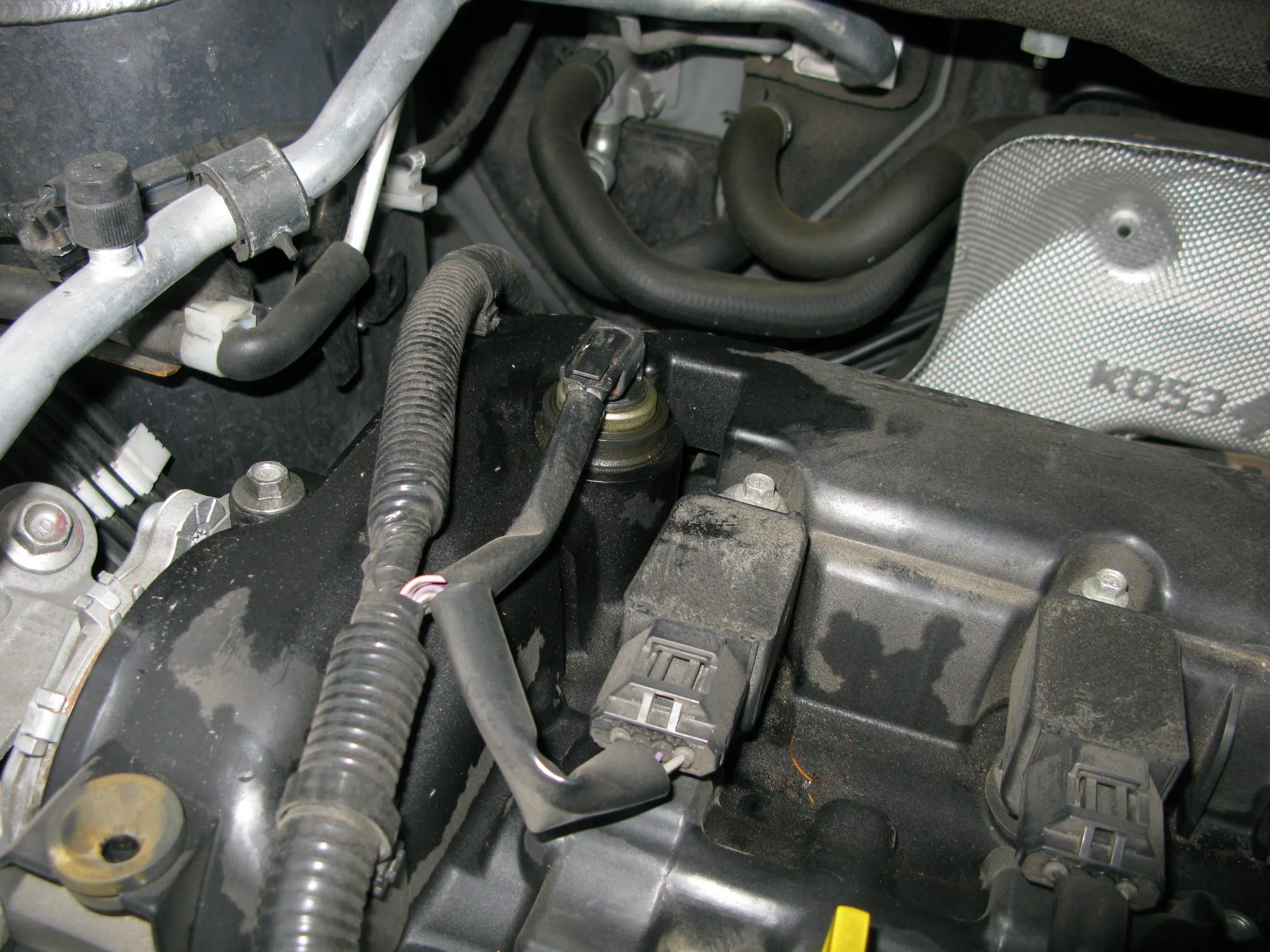

You might want to pop the top cover off the top of the engine and check for this oil leak, seems to be common around that mileage. Should be covered under your power train warranty.
https://www.mazdas247.com/forum/showthread.php?123848381-Small-Leak-on-Top-of-Engine-(Sensor-)
