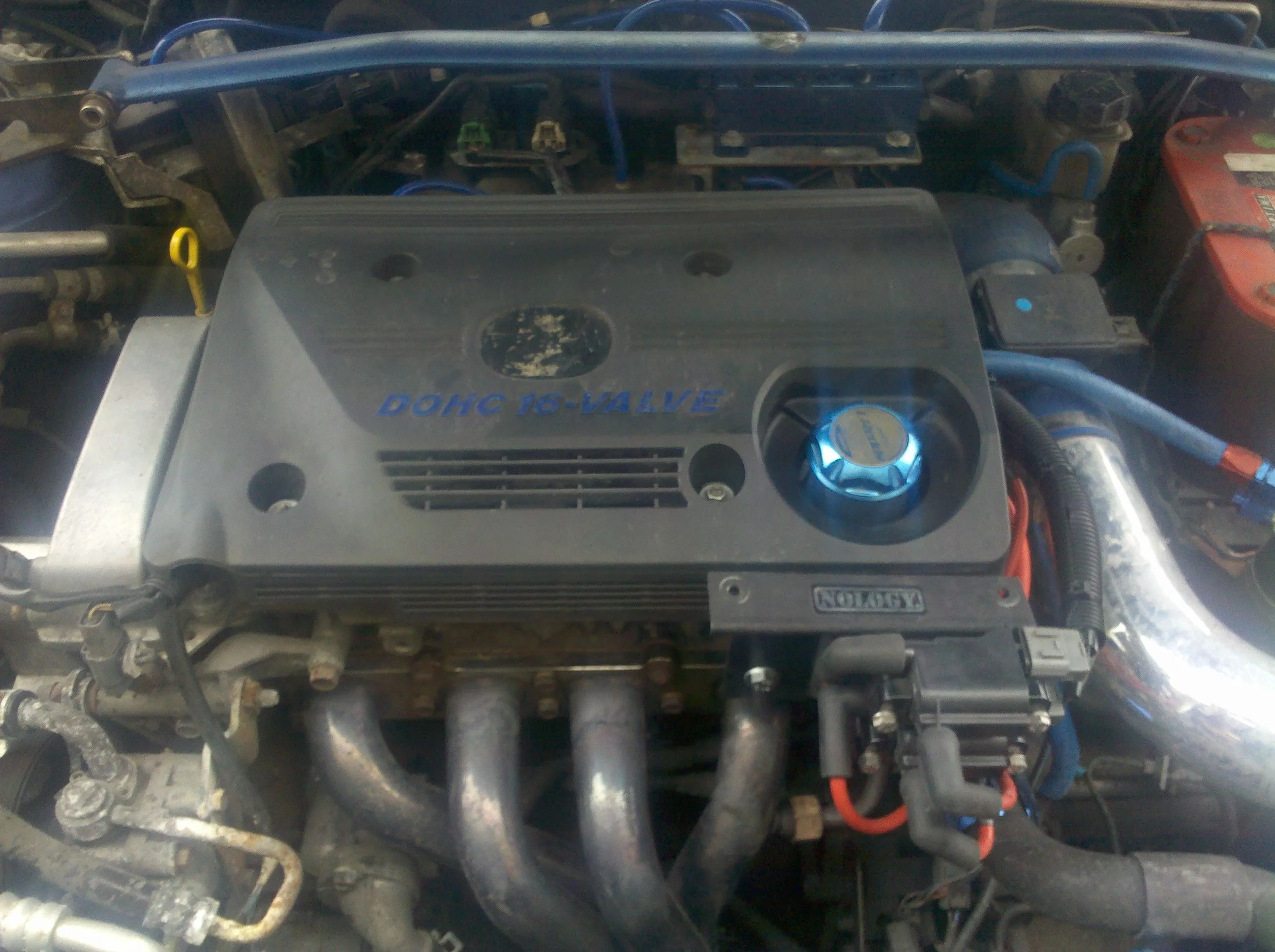

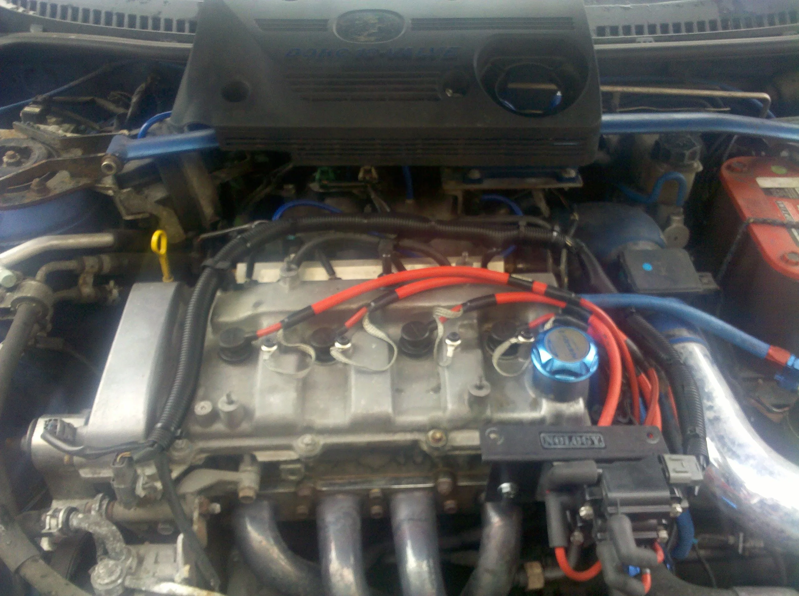

I just put on my Nology wires last weekend. Turned out pretty good. I just need to make a bracket for a 2nd mounting point.
