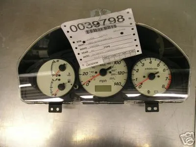

I have an 02 protege, manual, w/o tach. How would swapping this cluster go? Would the plugs match up? Would I have to run a tach wire myself or what? Details would be great
I'm not too concerned with the mileage not matching, but if it comes to that I'll check prices on having a speedo shop swap them and fixing the odometer.
It will more than likely work just fine for you. Have you ever take your cluster out before? If not, It's not too involved. Just take the 2 screws at the top of the gauge surround out (they attach the top of the gauge surround to the dash)... it works well when you put your steering wheel at its lowest position.
Next, grab the lower section of the surround and pull straight back out from the dash. This exposes the cluster and the 3 screws that hold it in. Make sure that you don't drop a screw here... they can get stuck in various places in the steering column. Now you can tilt the top of your cluster forward. On top there are 3 plugs. The middle plug (off center to the left) houses the tach wire (if it's there) It is back and purple. If you just look at the plug as it sits in the cluster the wire is on the far left in rear position. If the wire is there, then you are good to go. As you have an 02 (DX or LX?), I think the wire comes stock. Also, I'm not sure, but I think you need to get a cluster that has the same door lock options (power vs. manual) as what you have in your car. I hope this helps. I've taken plenty of gauges in an out of my 99DX.... so ask me if you need anything. If you need parts for a cluster, I've plenty.
