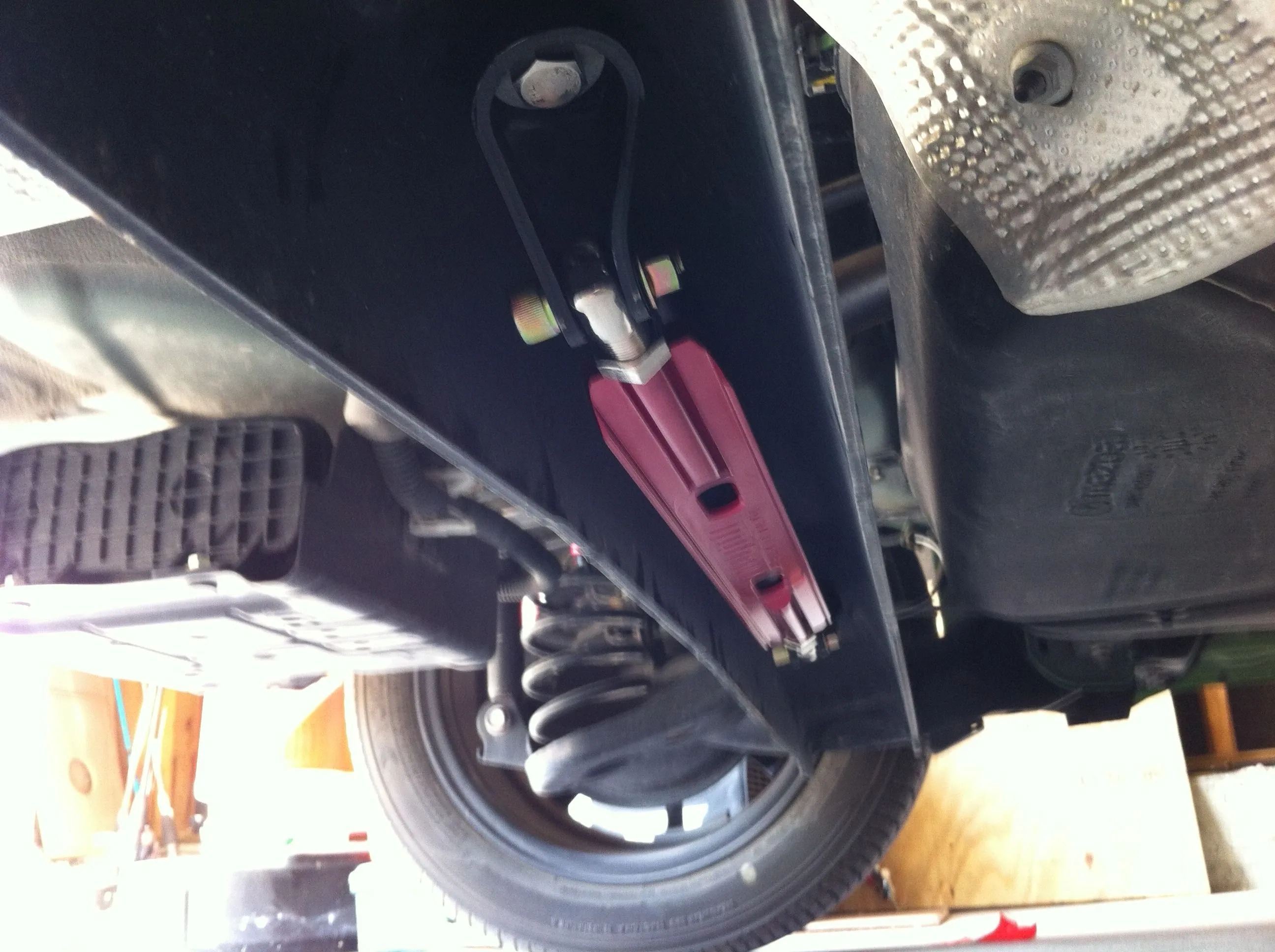

Installed mine today. I used a Megan racing lower tie bar. Got it for $35.

It's the same thing just has different end links/joints. I probably would have bought that style had there been any on the 'Bay when I got mine.
