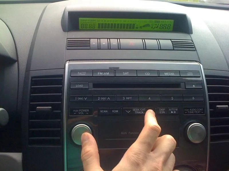

Here's the closest I could get. This was by holding down the power button (with it on radio) and pressing the ^SEEK button.
With the display info for it being there, and since the radio has a speed signal fed to it, I'd assume it could be possible. But then again, the LCD is probably the same one used for years with the DIS units or not.
The only button combinations I could get to other features was by holding down the power button and then another. If you do the power/media button combo, you get a 'PRESS KEY' message and then each button you press it gives you a description of what it does. The one I haven't figured out is preset 4, as it says 4/PROGRAM. But I couldn't get beyond that.

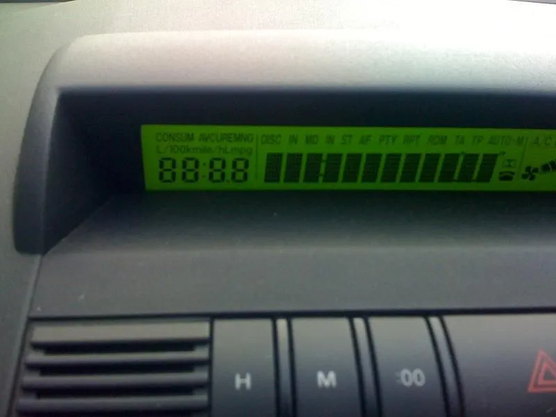

you can clearly see in your pic that the clock display has the DIS display built in (look at the avg/remaining/L/100km/mpg stamps). this is exactly how the mazda3's clock display looks. there were no additional buttons on the mazda3, either. on the left of the head unit, there was a button that said "clock" and next to it a button that read ":00". you would use these two buttons to set the clock. BUT, once the DIS was activated by the secret combo, the ":00" button also toggled the display between clock and DIS functions.
on the 2010 mazda head unit, there are three clock buttons: H/M/:00. i'll bet the :00 button doubles as the DIS toggle once activated.
at this point, i'm convinced that the DIS is there but disabled. the problem is that mazda isn't leaking the button combo to activate it. i remember the button combo being very complicated on the mazda3; it was not a combo that you could come up with simply by trying a few different combos.
also, each year, mazda would change the code. by '08 or '09 it became impossible to activate. so, maybe mazda did something more "industrial strength" to lock the DIS. i don't have high hopes for the mazda5 DIS. i figured i'd at least post what i knew and ask if anyone had cracked it.
My '08 has the same clock buttons your '10 - as you can see from the pictures.

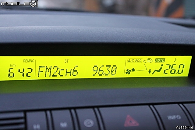

Taiwan version of the M5
Looks like the Taiwan version of the Mazda5 has the trip computer available. Here is a picture of the display:
Here is the URL of the article (in Chinese) doing mileage comparison.
http://www.mobile01.com/newsdetail.php?id=8405
So, that feature might be already in the North America version, just a matter of sending the car computer the right code to activate it.
But that also shows an 'INFO' button right of the hazard switch that I think was mentioned being needed to activate/toggle this information.
