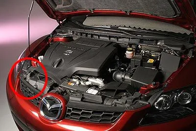

Here's a photo with the area in question circled in red. If someone wouldn't mind posting a close-up shot of that area for me that'd be great. Then I can combine that with what Shaz provided and see if something is missing.
The photo is from someone's gallery sorry I didn't make a note of whose it is, but it's one of the few I found with an inside engine shot.
Thanks for your help!

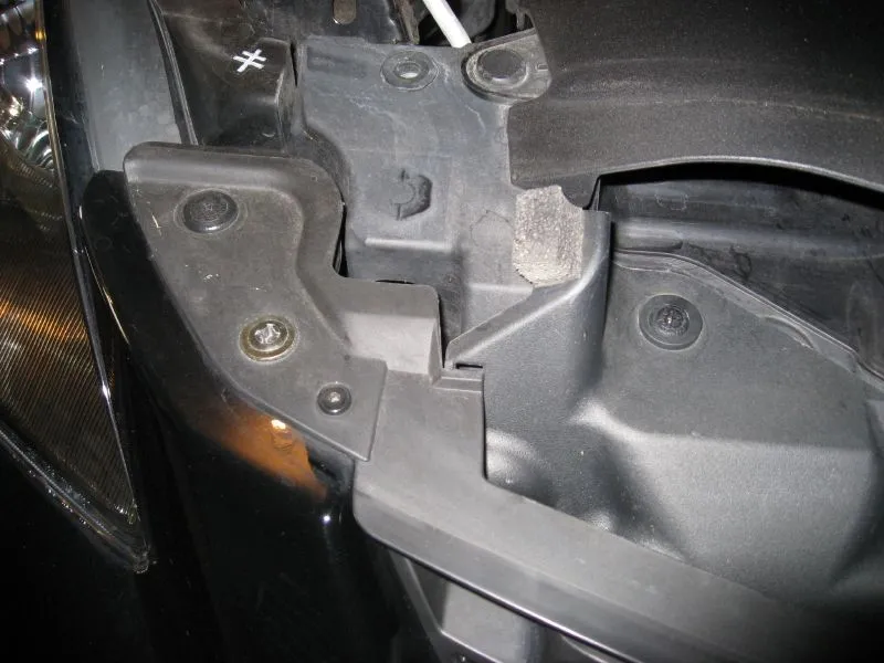

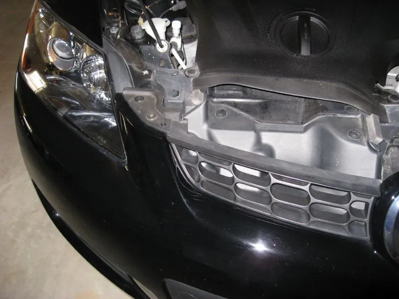

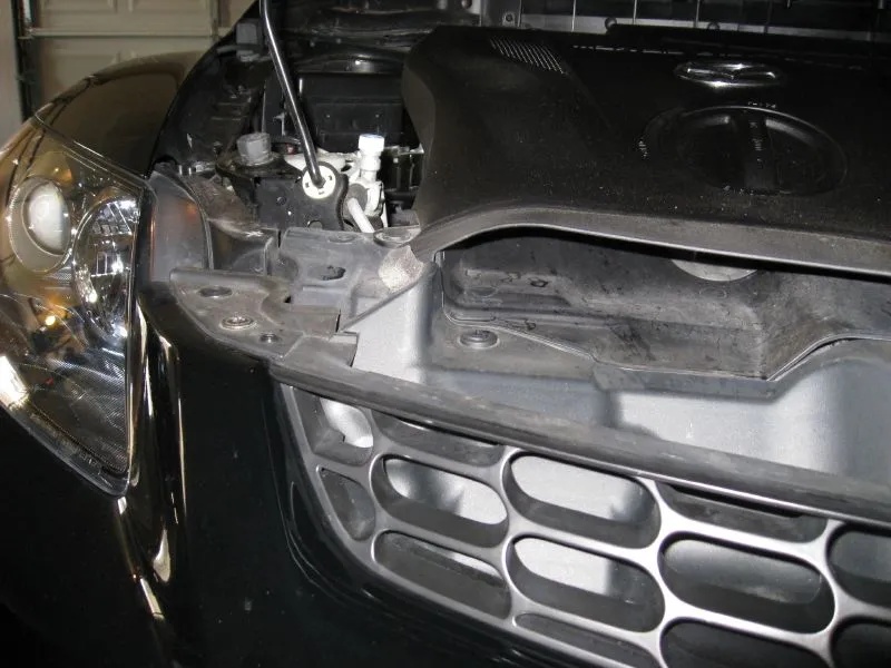

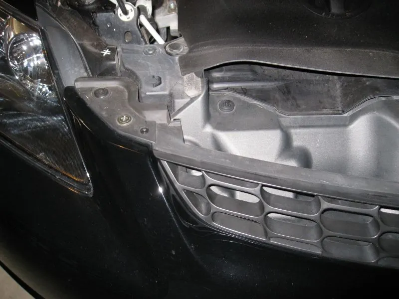

Will these do the trick? From my black GT
Took these photos of that area on my black GT...do these cover it?

Those are perfect, thank you!
Looks like all is in place on my CX7. The grille/moulding must be slightly out of alignment in that area. I'll have to try adjusting and readjusting.
