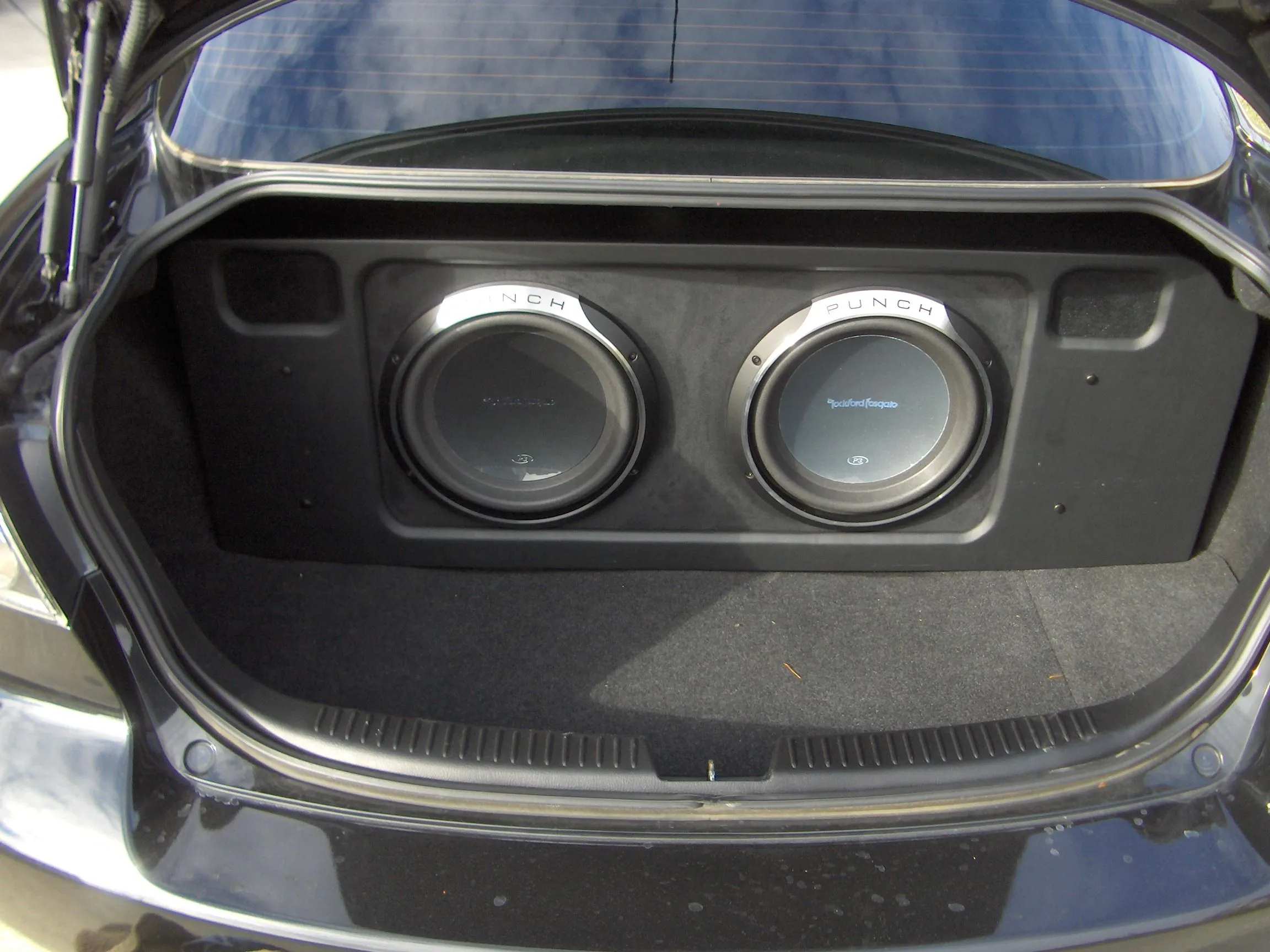

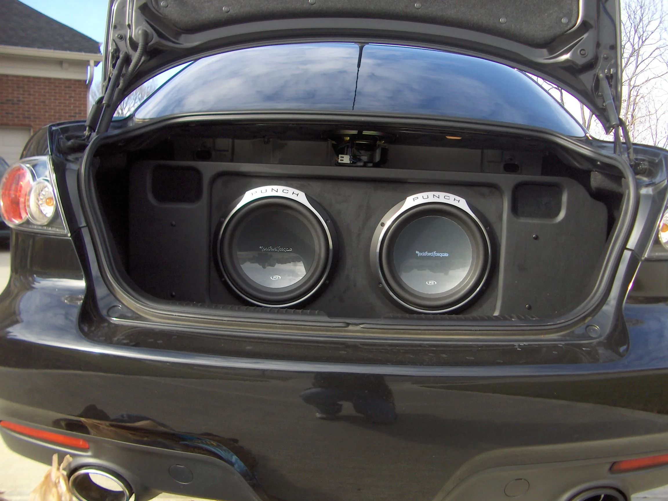

ill get some pictures of mine up here for you as soon as i can. i have a custom built box that fits perfectly in the back side of the trunk and its bolted in so it does not move around at all...leaves me plenty of trunk space too.

i have the amp mounted behind the box bolted to the metal seat reinforcement behind the black cloth of the trunk, and that is what the box is bolted to as well so it can not move around

id like to keep the room of the trunk then having those huge things back there

How was it trying to shoehorn that behemoth into your trunk? I've been looking at building a sub box to span that width between the wheel wells to fit the 4 tens, but with my unrefined box-building skills and my DIYness, the box would be rather square. However the trunk opening gives me doubts that I could put that size and shape a box in. So today it struck me to build the box in 2 separate pieces and join them together once they're in the trunk, if necessary. I could shell out big bucks to get the box fiberglassed and made to slide into the trunk, but as I think I've said, I want to be able to secure the amps on top....not sure how well they'd stay put with fiberglass, unless there's a board underneath to fasten them to......
BTW, what's the Blowse sub still doing there? You still using it for midbass?
the box is 2 pieces...it is your standard 12in sub box but then there is a piece cut out of mdf to fit the outline of the trunk so it looks nice. the outside piece is wrapped in leather and suade and nailed and glued to the box. the seats fold down but only from inside of the trunk, so that is how the box got in there. the blowse is still in there because i listen to pretty much any music so when im not using the subs i have a switch up front to turn them off and i can just use the stock sub.
