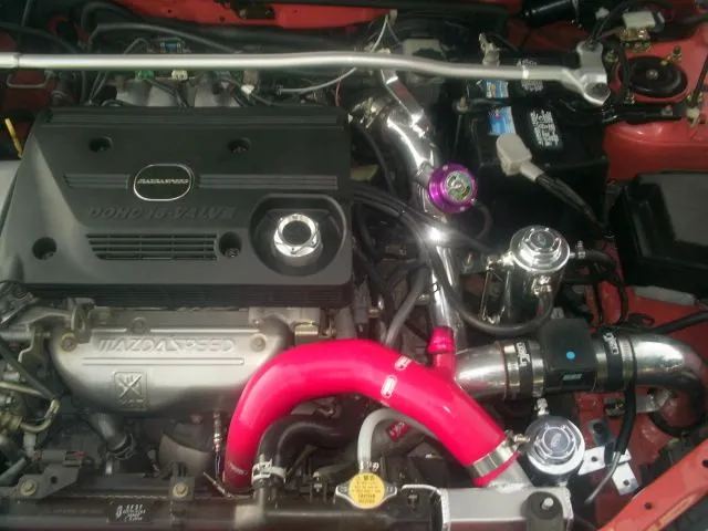

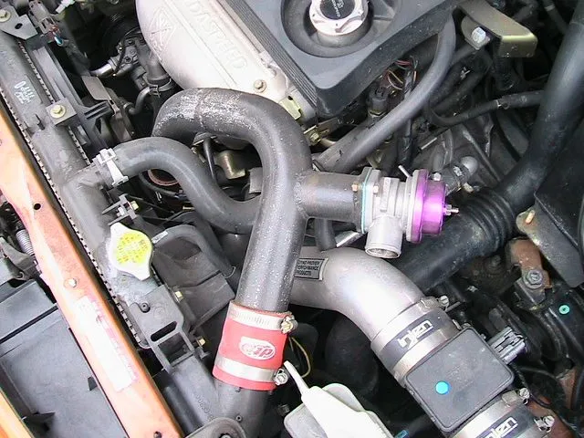

anyway, let me tell you about my experience, i first had the greddy bov only venting on the hot pipe, no bpv. see first pic, it ran ok and the bov was pretty loud and nice, but the main problem was that i would stall when i dropped it to neutral from a high rpm. I later learned about the dual bpv/bov setup and it made a world of difference. look that up first! pic2...
Now i am running both: the bov on the cold pipe and bpv recirculating from the hotpipe back into the intake...car runs waay better and i still get the greddy loud whistle when i boost!
