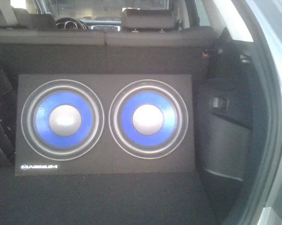

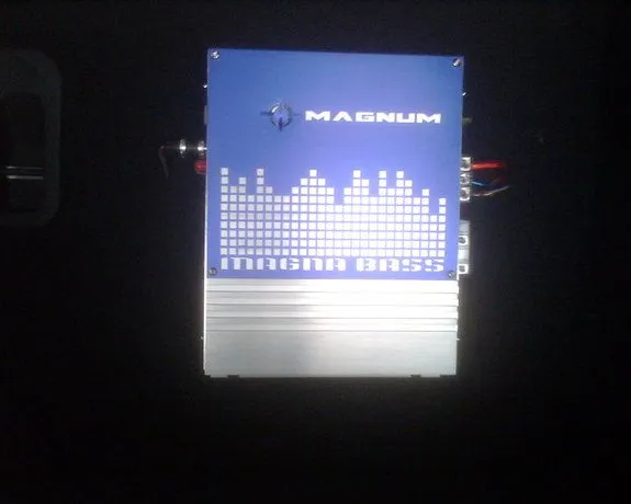

Hi Guys,
It's look like more than one has already the solution for the Bose rear Speakers. Sorry but didn't see this link before.
Take a look at the attached pictures.
Here is the original link: http://www.cardomain.com/ride/2661947
So back to the main question: Is there any one here who add a subwoofer and keep the Bose Radio Unit.
Thanks for the feed back
