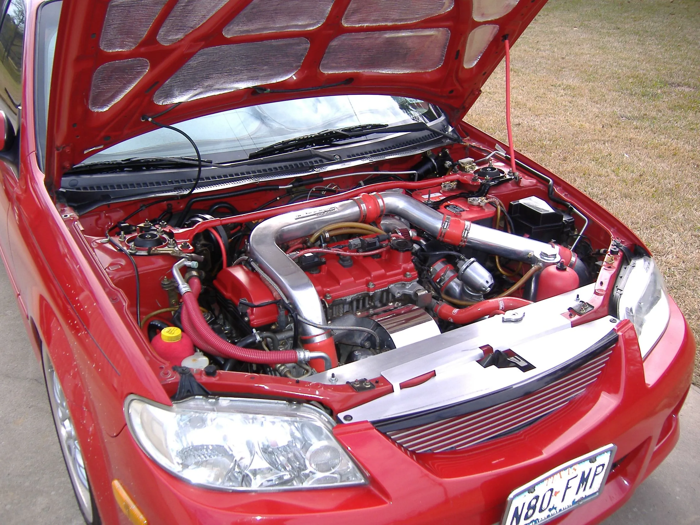

Internally wastegated used to be IHI like mine but I think they are using a T3/T4 internal wastegate. They come with a bov but I've always liked the SSQV.
