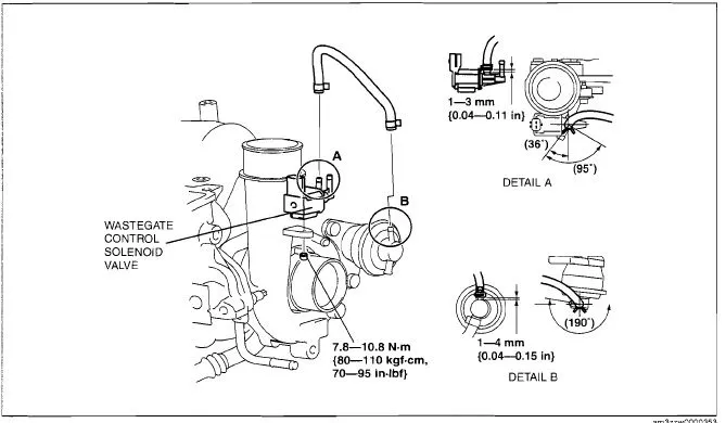

Im running out of light right now so im going to pull everything out tomorrow and check everything in detail. If by chance i did manage to break my boost solenoid, does anyone know where i can buy another one? Also is there a scematic somewhere for the the boost lines to the solenoid so i can be 100 sure it is hooked up correctly?
Boost Control Solenoid from OnlineMazdaParts
For the vacuum lines that connect to the solenoid. The line they show in this picture goes to the wastegate actuator. The other "nipple" on the solenoid goes to the actual inlet pipe.

Sweet, thnx for the diagram. I was getting aggravated and decided to just pull the car into my garage and try to figure this out now. For the life of me i dont see anything wrong. All the vac lines are correct, there are no tears or pinches in any of the lines and the solenoid doesnt show any signs of cracks. Im stumped.
