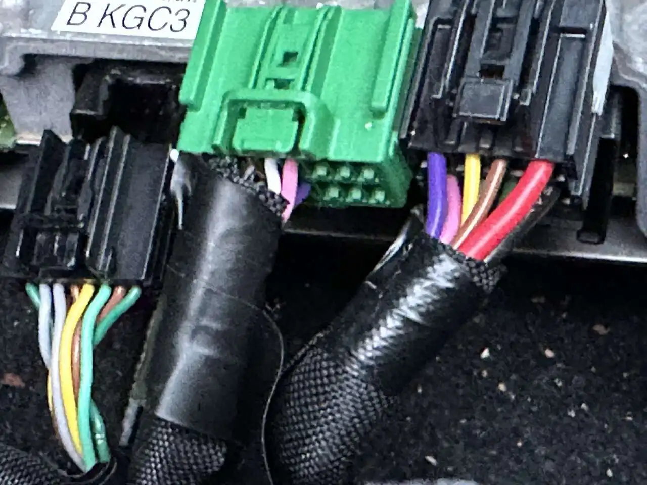

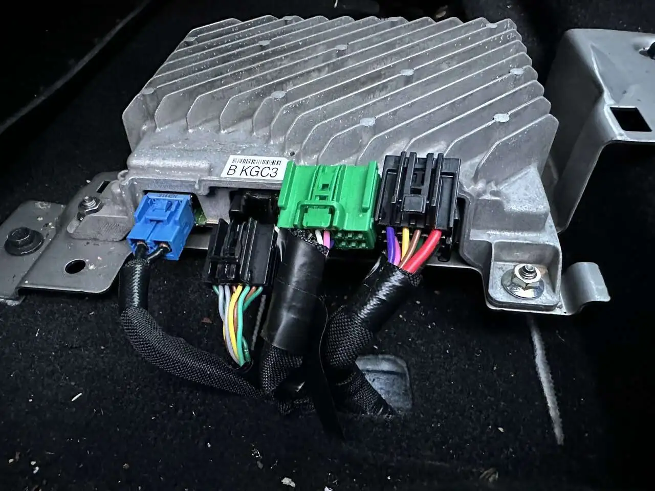

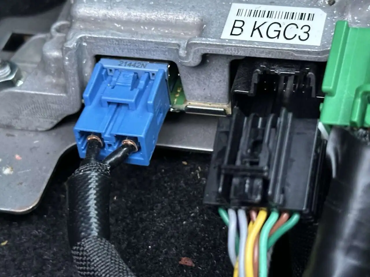

The 2024 Mazda CX-5 with Bose has different color connectors and different colored wires in different locations from my 2019 CX-5 with Bose. Here are some current pictures of the above from my 2024 CX-5 at the amp.
If anyone knows which connector is for the audio or has a correct pin out of the 24 Bose system, please let me know!
IDK if you made any progress, I am looking into fixing my aftermarket sub installation.
What I found out from surfing is the blue connector is a Mazda Opctic to amplifier, so you can only tap post-amp/EQ.
