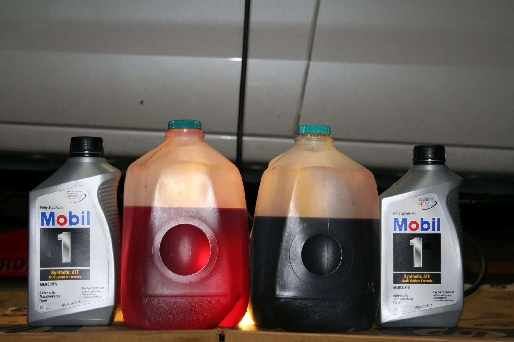

While change oil at 18k, I decided to drain and fill OEM ATF with Mobil-1 synthetic ATF knowing some past Mazda/Ford 4-speed auto have problems.
Here's a pic on ATF.
P.S. I didn't change the filter. Refill is a tick under 3 qt. And comments on carwash are not welcome. :rolleyes:
Are the two milk jugs of oil the old and new ATF? If so, I presume the one on the right in the photo is the used ATF? And I believe your post title is indicating that this vehicle has 18,000 miles on it, correct?
IF all of my assumptions above are correct, you need to be changing your ATF at absolutely no more than 15,000 miles. What are your driving habits?
P.S. For anyone anywhere to say that xx ATF lasts yy miles is absolute foolishness. ATF lasts according to the transmission design, capacity, usage, etc.
Dirty ATF (r) and new Mobil-1 (l).
Mobil-1 (Mercon V) new formula is more apple red than old one (cherry red).
My MZ5 is driven mostly short distance (2-5 miles) per trip. Almost never stop-and-go traffic. 20-30% highway (> 50MPH). Average Houstonian driving style.
3 qt (drain/fill) out of 7.6 qt total should be adequate for 20k if good semi-blend or synthetic is used.

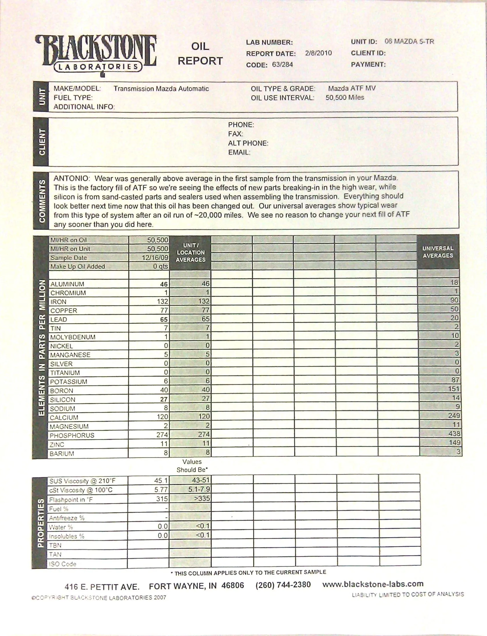

Mazda5 ATF Oil Analysis
Did a drain and refill on my Auto Mazda5 with 50,500 miles. Refilled it with the Mobil1 ATF. Sent a sample of the ATF to Blackstone Labs for analysis. It cost $20 to have it analyzed. Attached is the result ...
