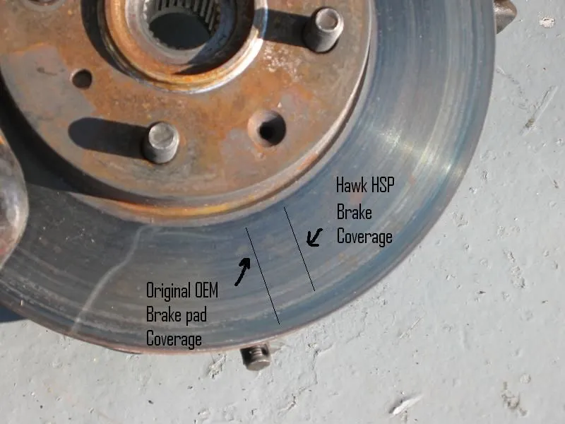

Well it appears that the contact area on these brakes is much smaller than the OEM's.....there is about a 1/2 inch thin line of rust accruing on the outer edge of the rotors (fronts). Any suggestions outside getting new rotors? Should I have any safety concerns?
so you're saying the brake pads you had on are much smaller than the OEM rotor size.
did you buy the car with these pads already on? almost sounds like they were the incorrect pad size for the car.
if thats the case, you should definitly replace the pads... as for rotors, like i said you will HAVE to either resurface or replace them at that mileage. no option. Resurfacing is cheap, as long as the thickness of the rotor is still within spec. make sure the place that cuts em for you KNOWS or can find out the rotor specs for the MS6.
If he finds they ARE under spec width, than you are SOL and MUST buy new rotors.
They are Hawk HSP on MazdaSpeed OEM rotors...I need to stress about 60000 of those 93000 miles were highway. When I replace the fronts they were at 6/32 and 7/32. The rear brakes fit perfectly. I've included a pic to demonstrate. Car brakes great with no vibration at this point.

never realized about teh pad coverage. i have HPS pads too.
material-wise it seems to do just fine.
again, the life of that rotor no matter the TYPE of miles SHOULD get resurfacing when you went to new pads. without, the pads could end up getting grooved due to the way the old pads ran on the rotor. resurfacing cuts a nice fresh flat surface for new ungrooved pads.
the minimum spec thickness of the rotor needs to be about ~0.906 inches or 23mm.
It sounds like you already rpleaced the pads withouth resurfacing the rotors... which is fine, but just understand you run the risk of grooving or bad glazing effect which will lead to long term issues with braking or faster wear & tear.
eitehr way sounds like this matter is taken care of. lol
