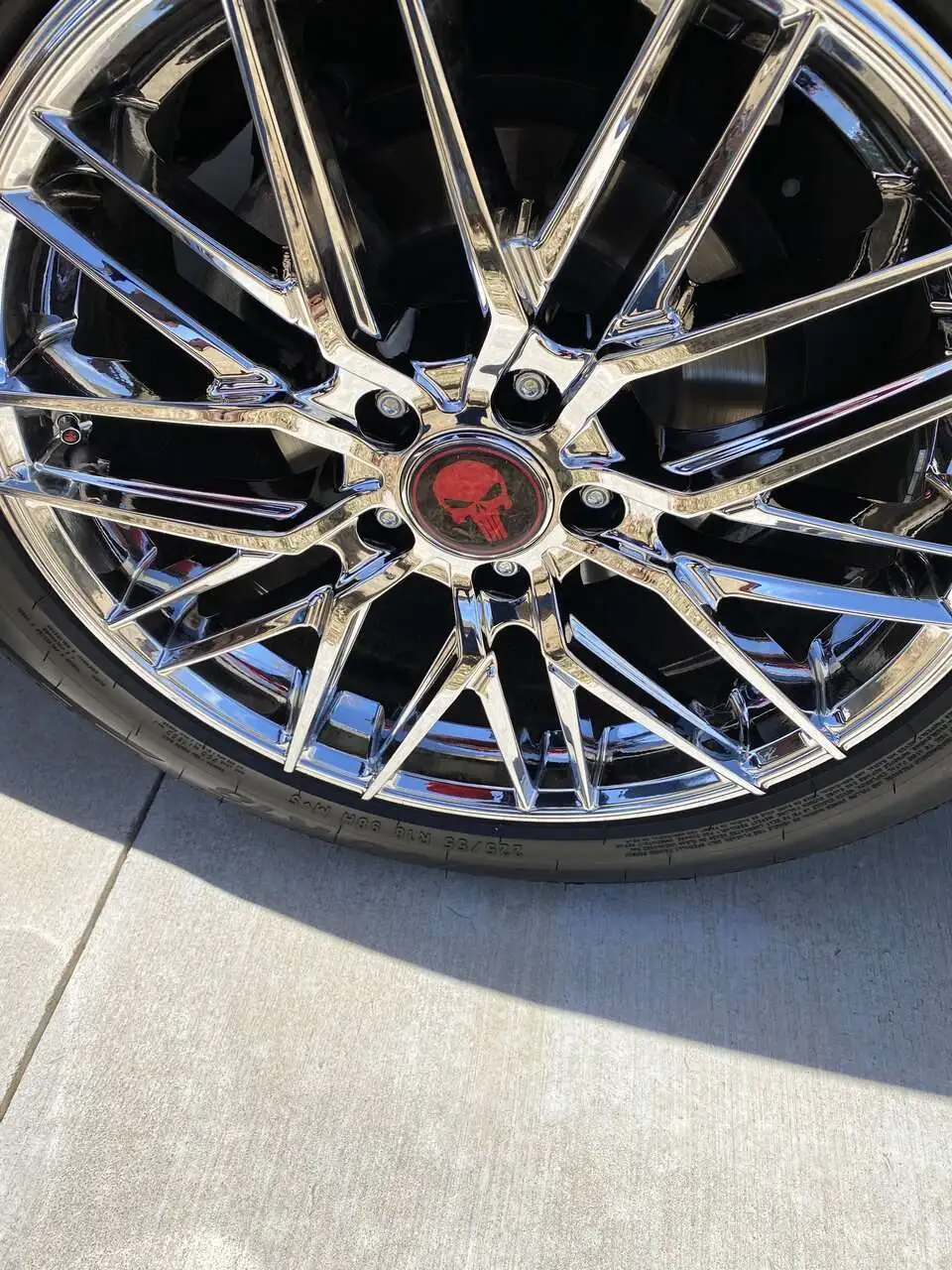

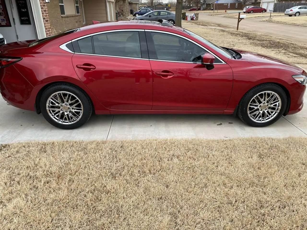

I never gave the OEM rims much thought. Shortly after buying my 6, I bought some used 19” chrome wheels and never looked back.
Due to my own lack of attention, I curb rashed two of them. So, when time came for new tires, I went ahead and bit the bullet for new rims. No regrets. Love the contrast of the car’s color against those new chrome wheels.

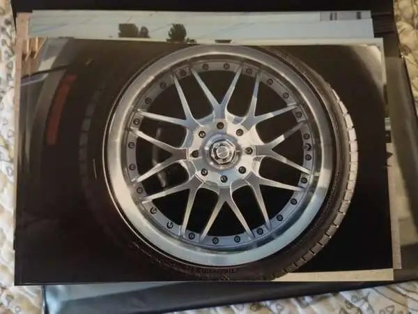

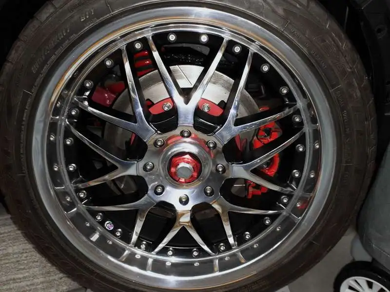

This is one of my wheels on another ride of mine. In 2003 I bought a limited edition set of wheels. Then later at Laguna Seca I had a tire blowout and went off the track damaging cosmetically the wheel. The wheel was discontinued, and no one had one for sale anywhere in the world. So, I had a wheel shop repair the damage however they could not match the machined finish that came with the wheel to match the other 3. I took the time and meticulously hand polished all the wheels. And then masked and powder-coated the inside ribbing. After which I applied a clear coat. The second picture below was taken the other day to post here on this forum on another thread. But the point is you can polish alloy wheel DIY and clear coating last for years and retains the shine and luster.
Oh and the center large RED nut I had hard anodized.
Year 2003 then and Now April 2022

Difference in night & day. It never occurred to me to spray a clear coat on the wheels to preserve the finish. Nicely done!
