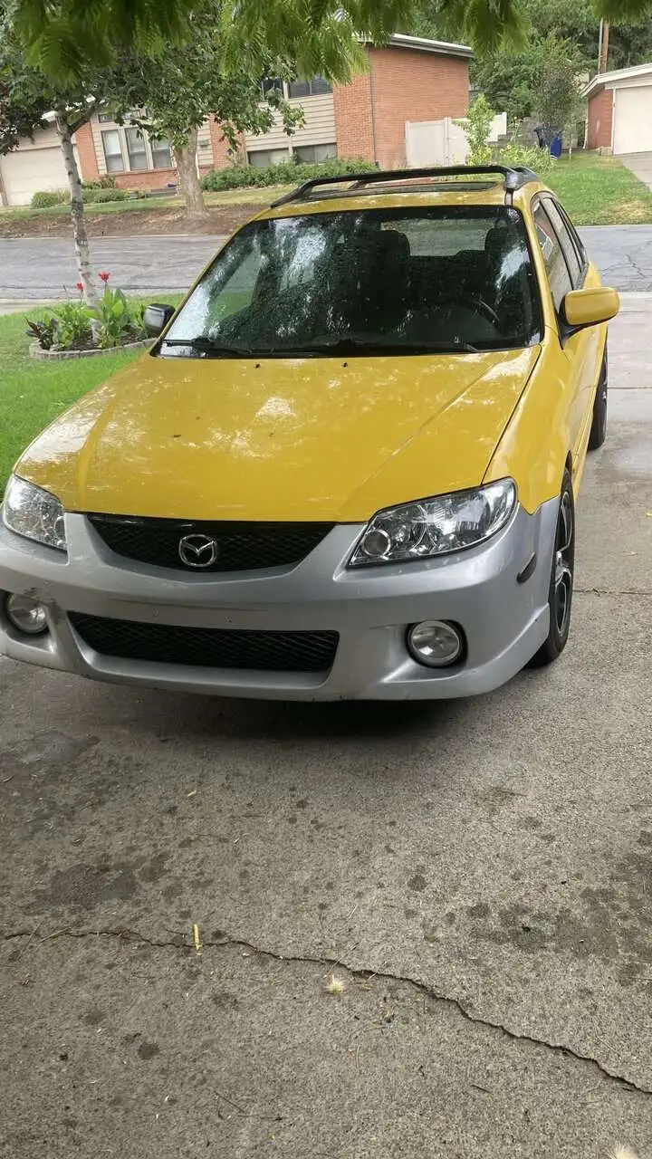

Thought i’d document progress on my p5 and start some activity on my account so i have somewhere to ask questions and get help from people that know their stuff better than i do
I got my protege a couple months ago from my neighbor who had passed about a year ago. She didn’t have any kids of her own and she spoiled me and my sister and treated us as if we were her grandkids. Since i got my license i wanted my own car that i could screw around with and my parents brought the protege up as a potential option and i had always drove past it sitting in her driveway and it always caught my eye. It has about 90,000 miles and I finally bought it for $2800 and my parents paid for half. since then i’ve fixed issues like ac not working and i’ve put a new sound system in and fixed some cosmetic damage since my neighbor had put quite the damage on the exterior before she passed. her neice told me she has horrible vision and that they should’ve taken her keys but never did.
It’s starting to come together since ive put a new bumper on and attempted to paint some stuff. I haven’t touched the engine yet and i don’t even know where to start but i would love to make this car a little faster and i’ve been trying to find a turbo to throw onto it for a while but i can’t figure anything out and it would be especially difficult since it’s an automatic. I’ll throw some pictures in of the bumper and trunk that i recently pulled from a nearby junk car and some wheels i bought since the old ones were so bent from my neighbors driving that the shop wouldn’t align my car until i got new ones.

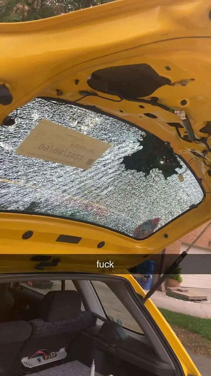

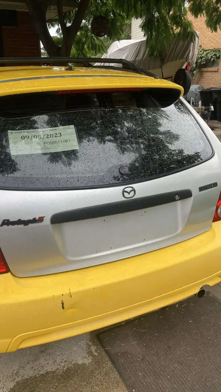

I was working on pulling a dent and removing the rear wiper when the back glass shattered and left a huge mess on my driveway. i felt pretty stupid and i’m still finding glass everywhere. i bought a trunk with an intact window and thought it would be easy to repaint. it was not. i did some bondo work on the new one and primed it and realized i didn’t have enough paint for a full coat. i waited for the paint to cure and got two more spray cans. it was still not enough. it looks good from 20 feet but the primer is showing green from under the paint. body shops have told me to get more paint. F315A381-F105-42D9-9CF8-4EFB907334C7.jpegB54F7842-8BA8-459A-B1BE-D102D64CC26D.jpeg
I like the bumper and i think i’ll keep it silver, my friends said it looks like a blue/silver impreza with the two tone.

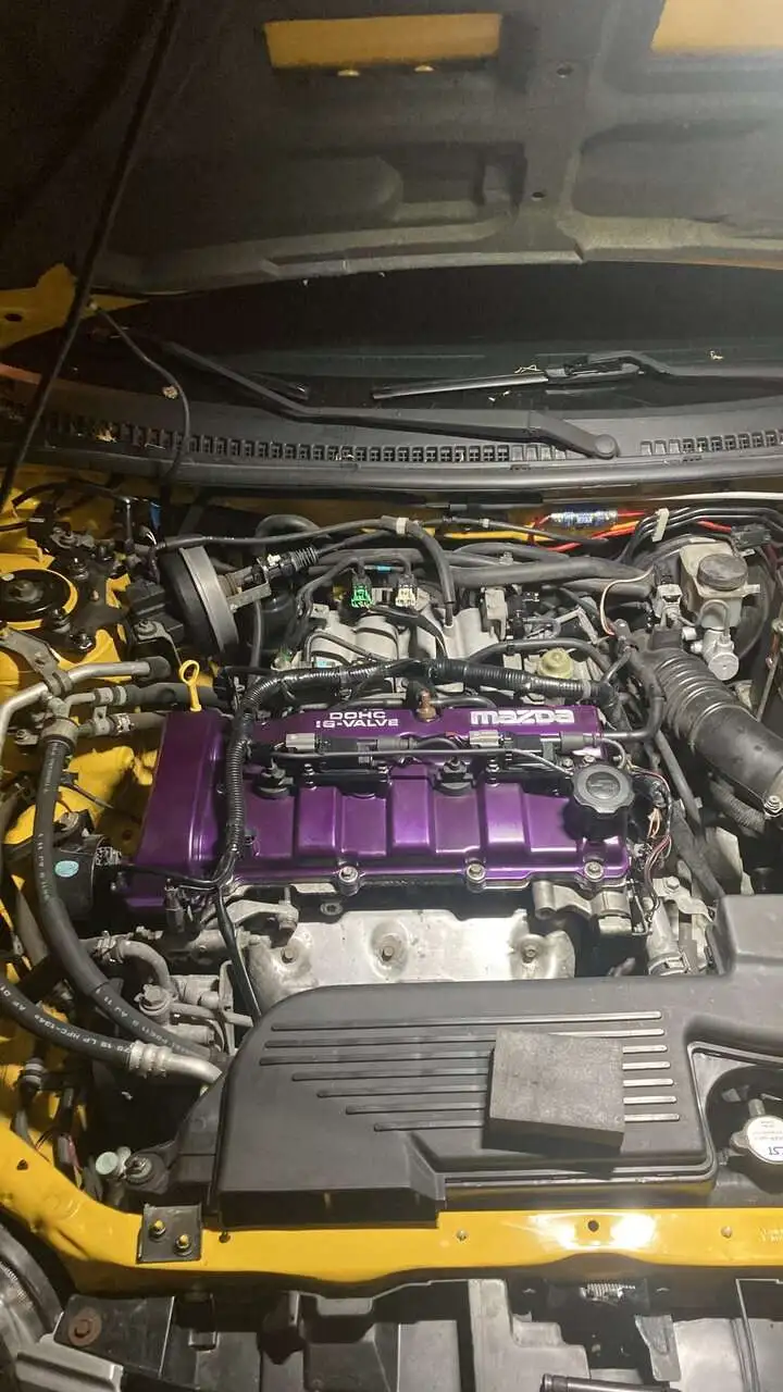

Painted valve cover purple, turned out great. Also tinted the taillights, thinking about taking the red lens off and making them clear

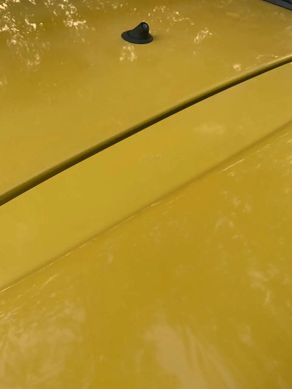

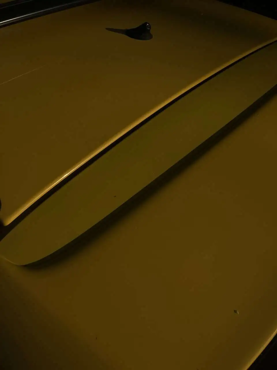

another thing, does anyone have any experience painting yellow with spray cans? how did it turn out? is there anything i should know?

One thing I remember is that the yellow Protégé 5 was not clear coated.
All other colors were clear coated.
good to know, that explains why the yellow shows up on rags when i clean it.

Yellow is a notoriously difficult colour to spray, use a white primer instead of grey and lots of light coats (go for a few more than a darker colour) it's all in the prep and with a bit of practise you'll be painting like the pros :)
There was a factory two-tone Familia called the Field Break;
It’s pretty cool how many variations there are of these cars, I still haven’t seen another pro5 outside of my junkyard.
Thanks for the tips on spraying the yellow, I suspected the primer might’ve been the reason for the greenish color. i’m going to go get some paint soon, i’m going to be out of time though now that I have school starting tomorrow.

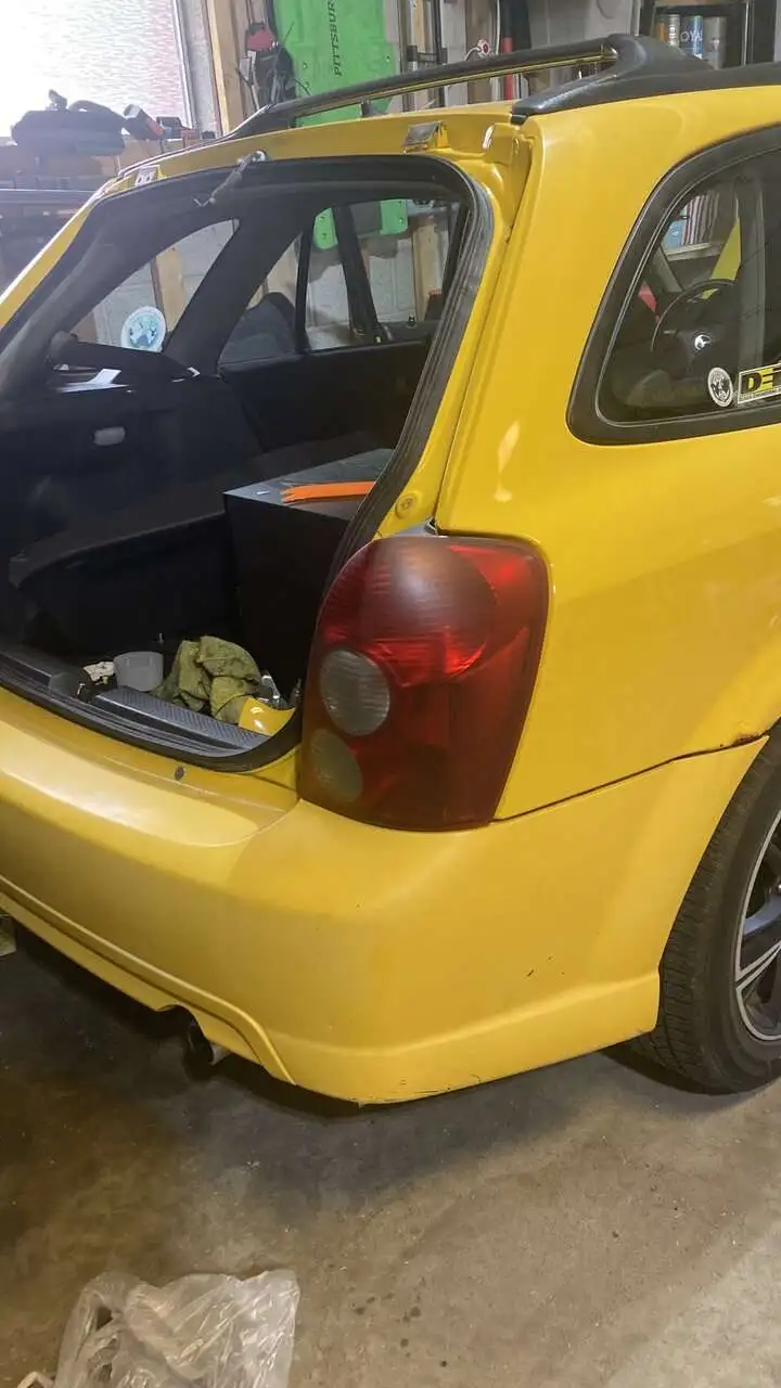

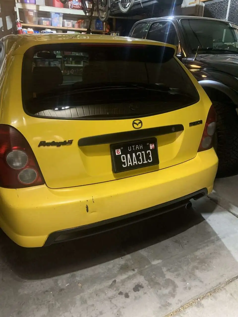

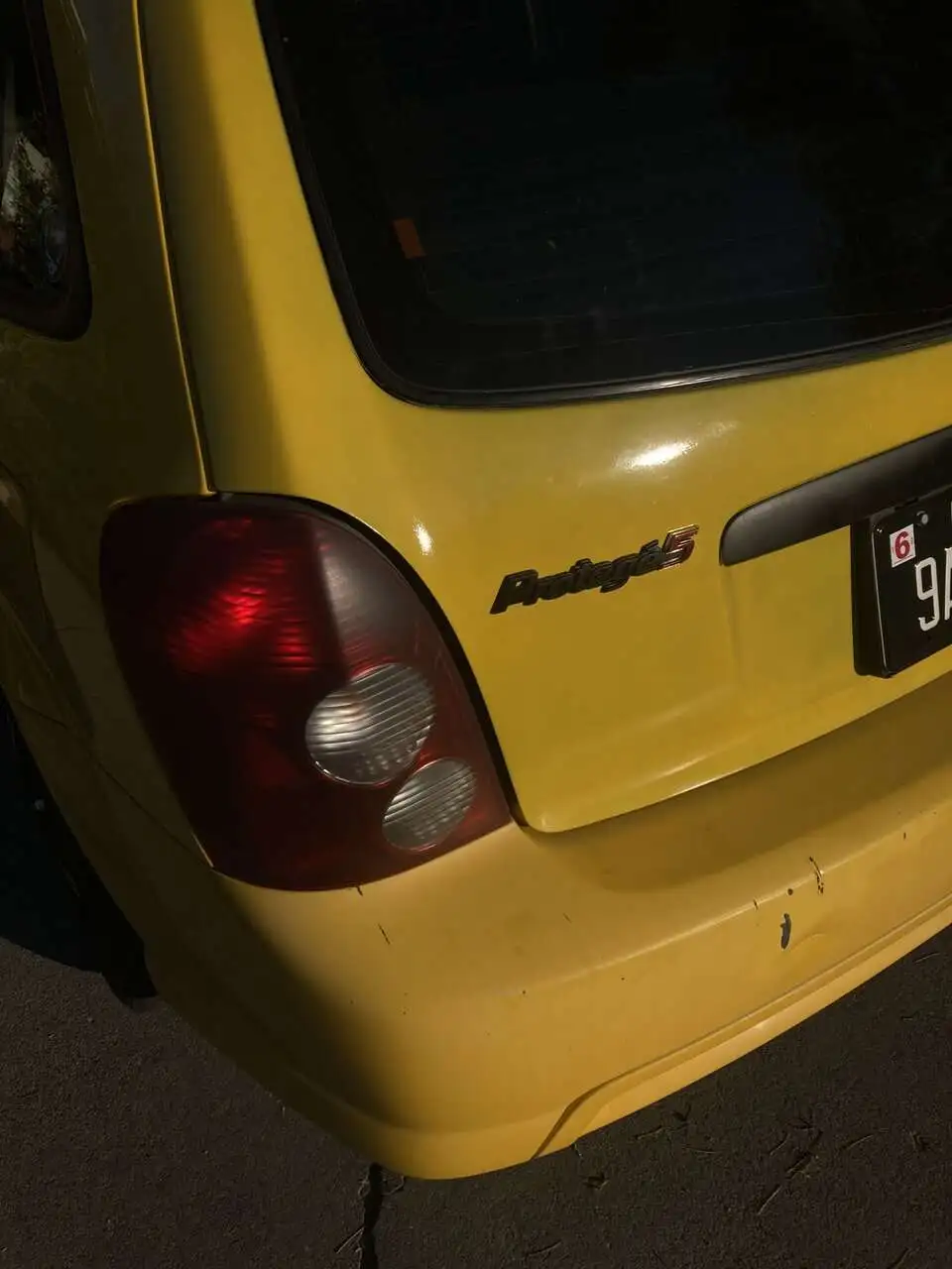

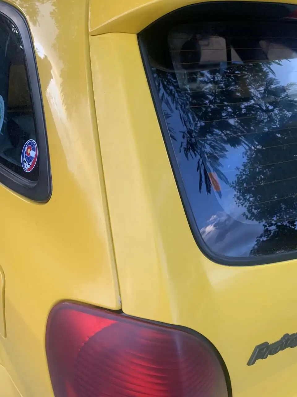

Here are some more pictures showing the trunk after my attempted paint job.
My friend with some amount of magic involved came across a yellow protege5 with no body damage at the junkyard.
I’m regretting spending so much money on paint supplies, and when I go to check it out today I’ll decide if I want to just buy it and know that it’s going to be perfect or keep going on mine and have the experience of painting it correctly. Although I’m definitely going to grab a mirror cover and rear bumper cover depending on the condition.

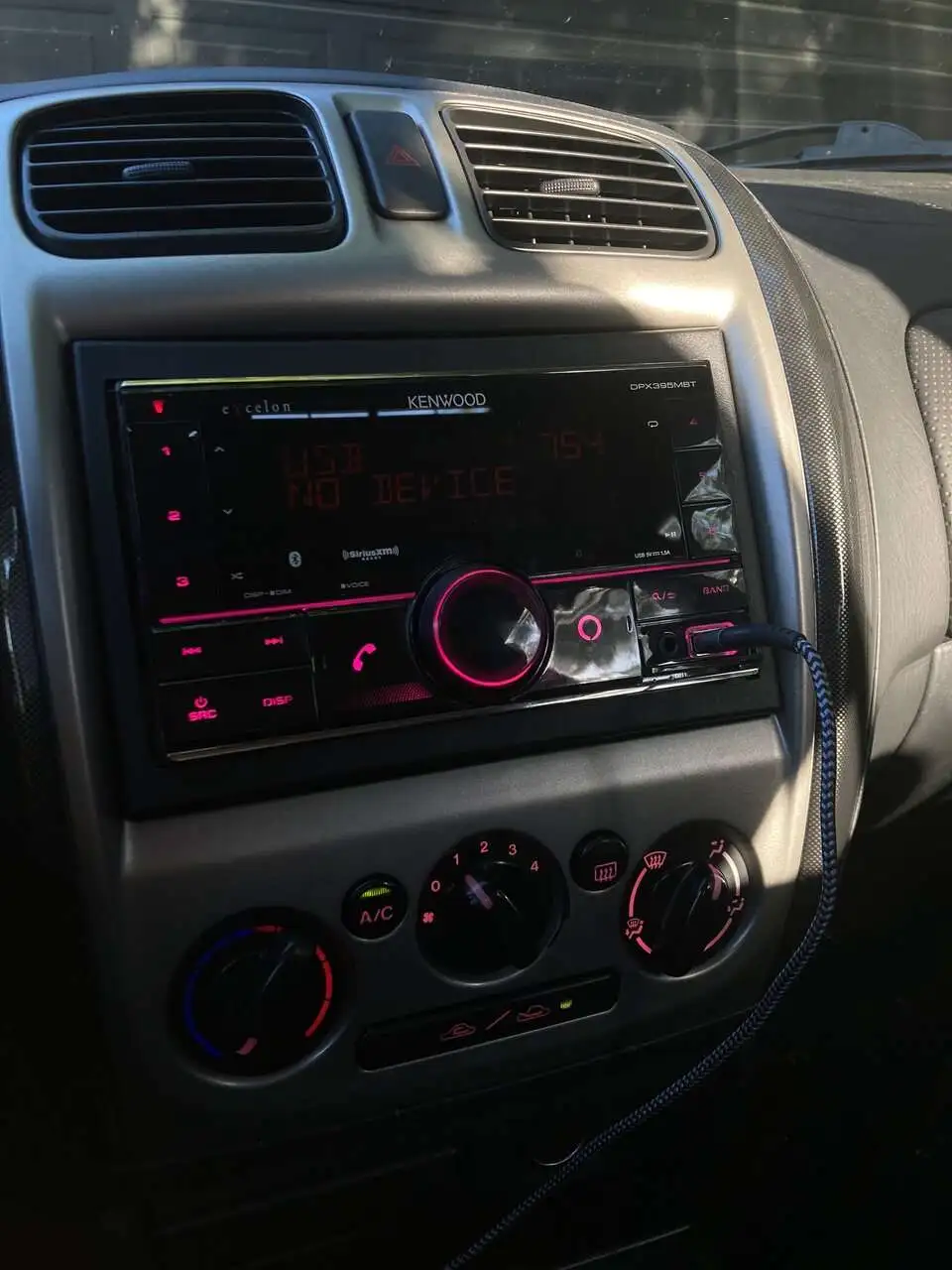

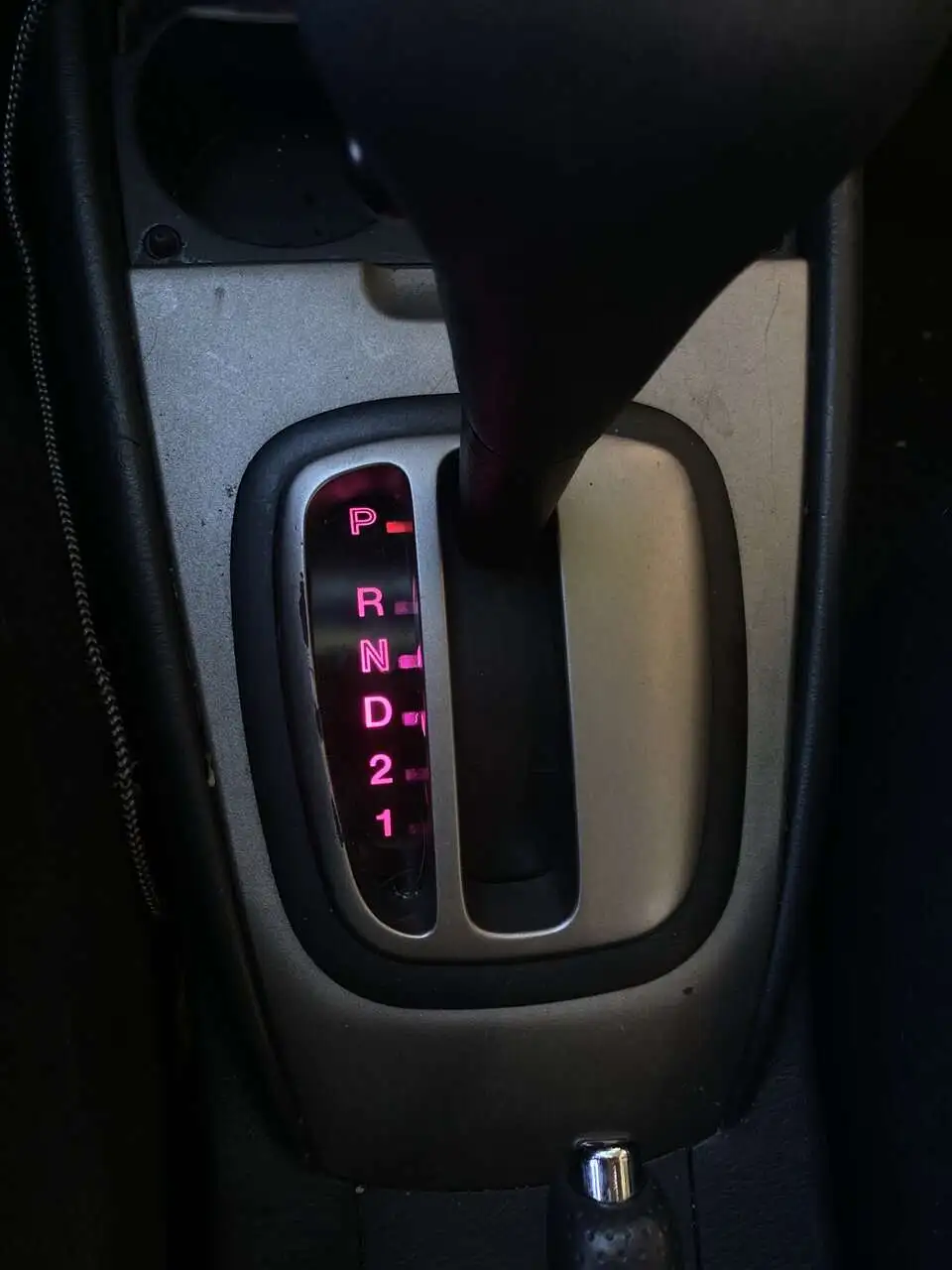

Attached pictures of the purple LEDs I switched into everything if anyone has interest in that. The cluster leds don’t show up any different on camera because there is a red film behind the numbers on the cluster and it just looks stock on camera. It does have a nice purple tint to it at night.

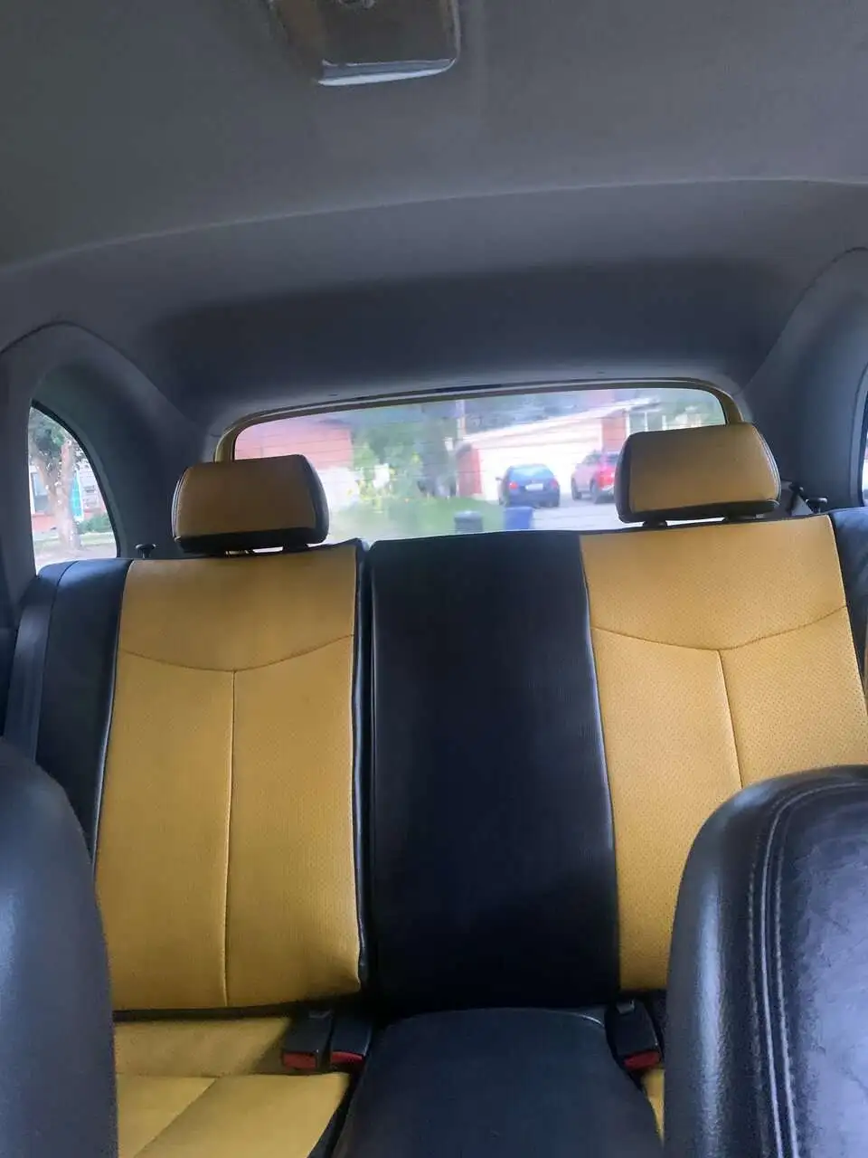

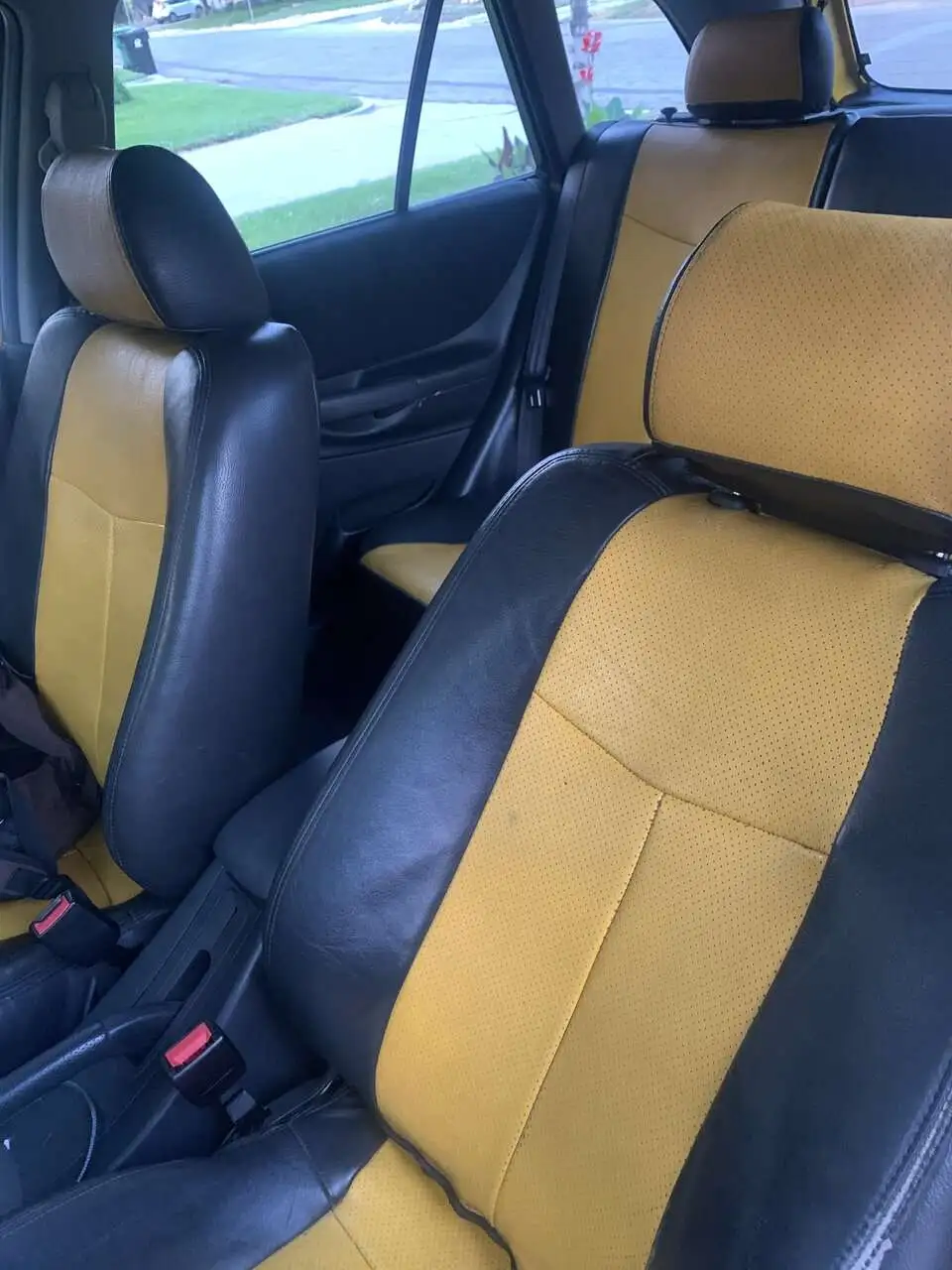

I got some fancy leather seat covers, I had to tear apart the seats at the junkyard to get them, and sliced my finger open on that nasty sheet metal. The seat covers looked like they were from the factory, and I haven’t found any info on what they are or where they’re from, but after taking my old seats apart and sliding these covers on everything fit snugly so I assume they came from some type of protege or Mazda with the same seats. If anyone has tips on what these covers are from and how to zip the front seat zipper, let me know.

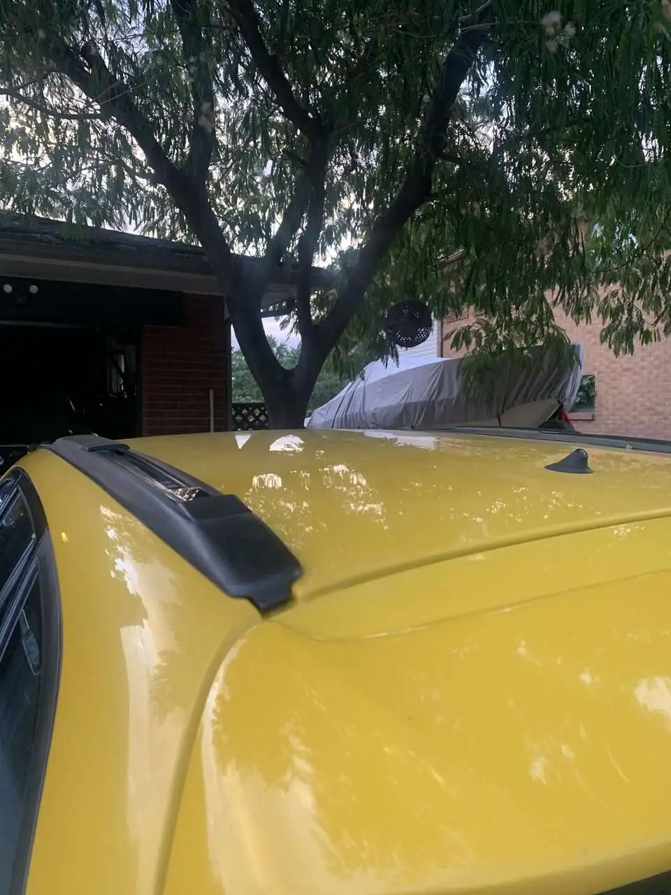

I removed my roof rack, I haven’t done the headliner thing, but I wanted to see how it looks... it is much quieter on the highway and it looks better. I’ll be taking the headliner out to remove it fully.

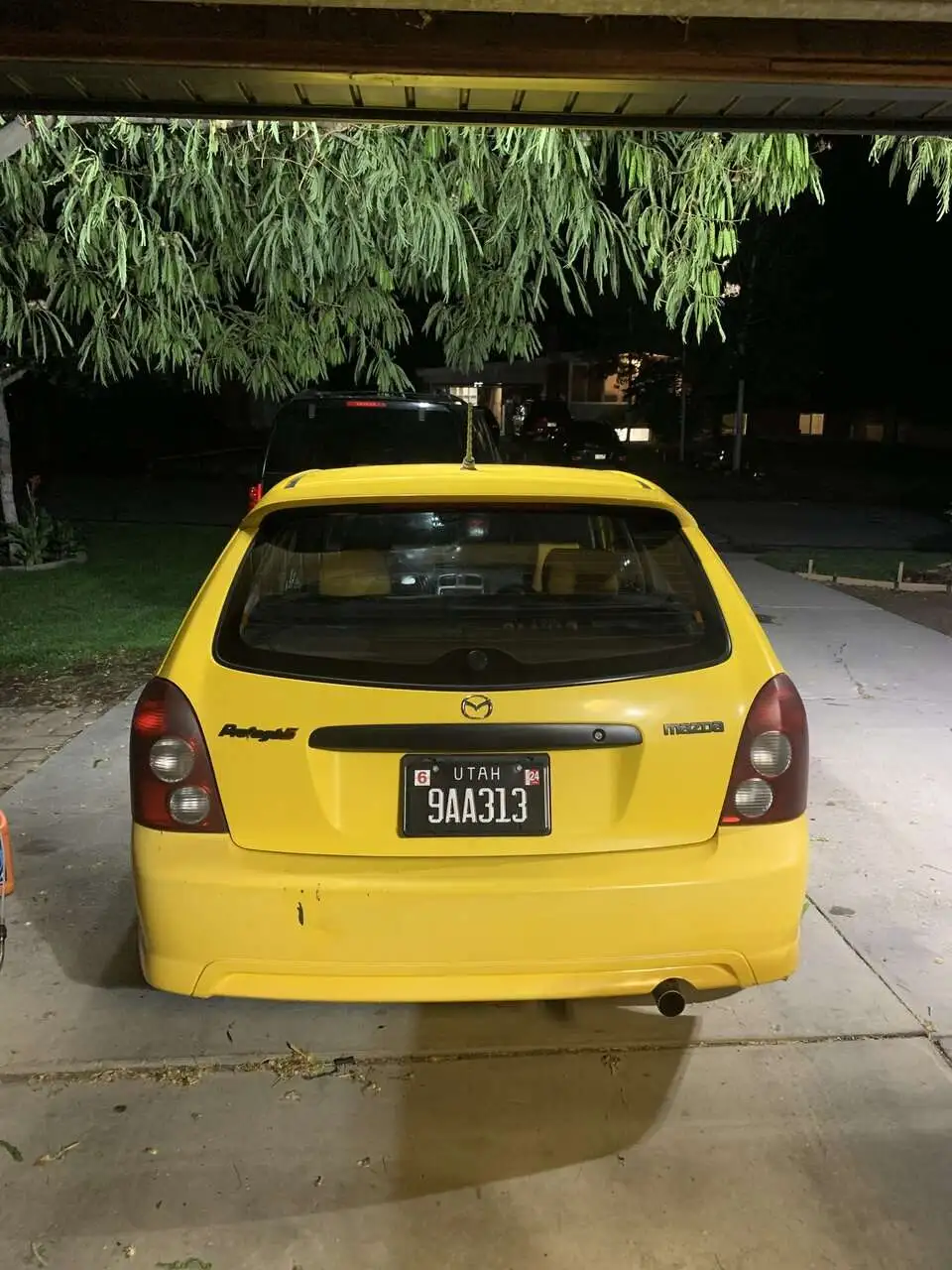

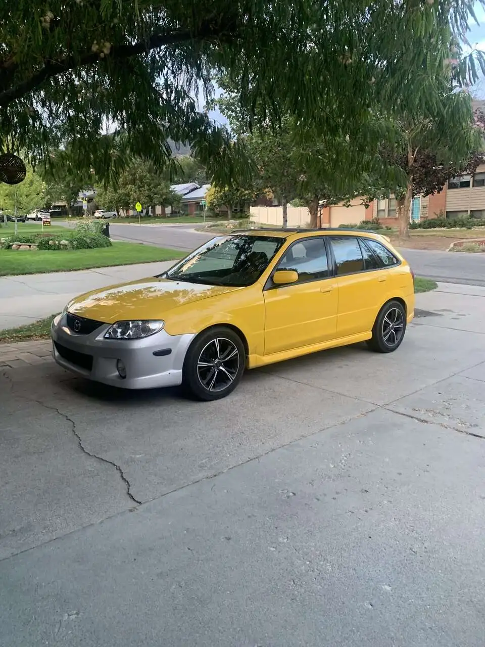

pic of my car as it stands today

Those seats look sweet! Good score, most likely aftermarket but look pretty good quality

Thanks! They need some sewing and restoration for the fronts but they got rid of the cigarette smell. The back seats look brand new though.

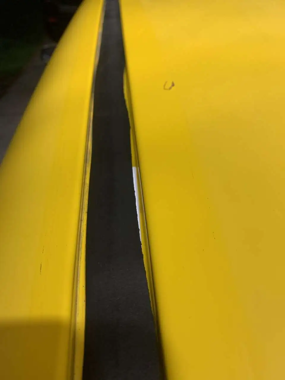

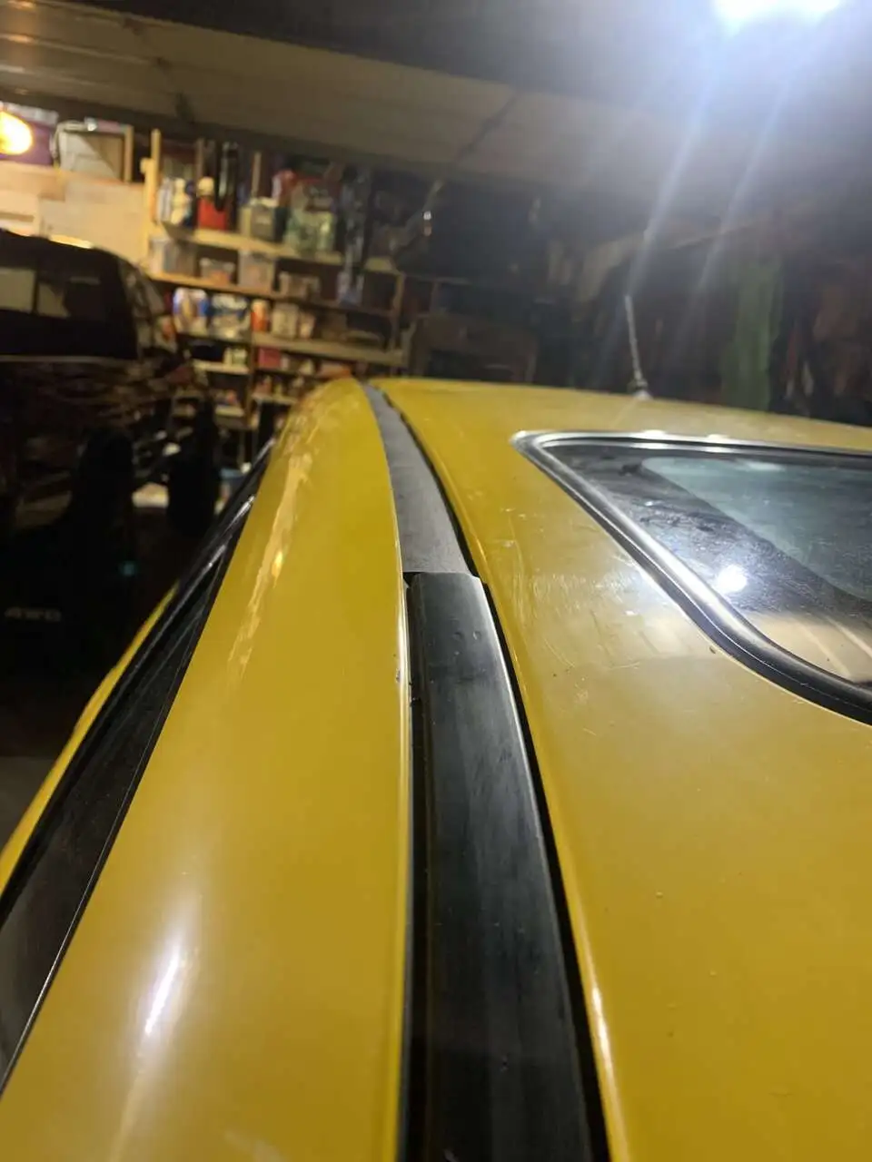

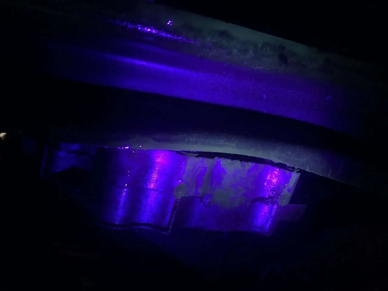

Roof rack removed! Headliner had some leaks when it rained today, still unsure of where it’s from but it looks like it’s either the windshield seal or the sunroof drip pan. It’s from the drivers side corner right where the visor hinge mounts to the headliner but it got so wet I couldn’t tell.
I didn’t buy the roof rack filler strips, I used a garage door weather stripping / seal and it looks like poop from close up but it does the job from afar. I used caulk on some thin plastic sheets to seal it.
I’ll be keeping the headliner out to maybe reupholster it and in case it leaks I won’t have to remove it again. It looks much nicer, especially from the back.

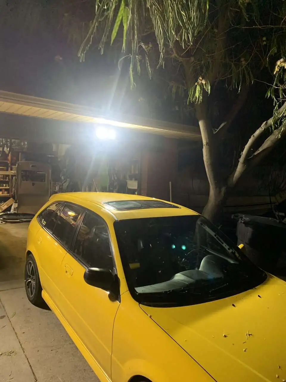

I think Katzkin made a leather seat cover kit a while back, these look similar and in very good shape. It's coming along nicely.
It is! I got the interior reinstalled and the old tint off the back glass; she’s ready for some new tint tomorrow afternoon!

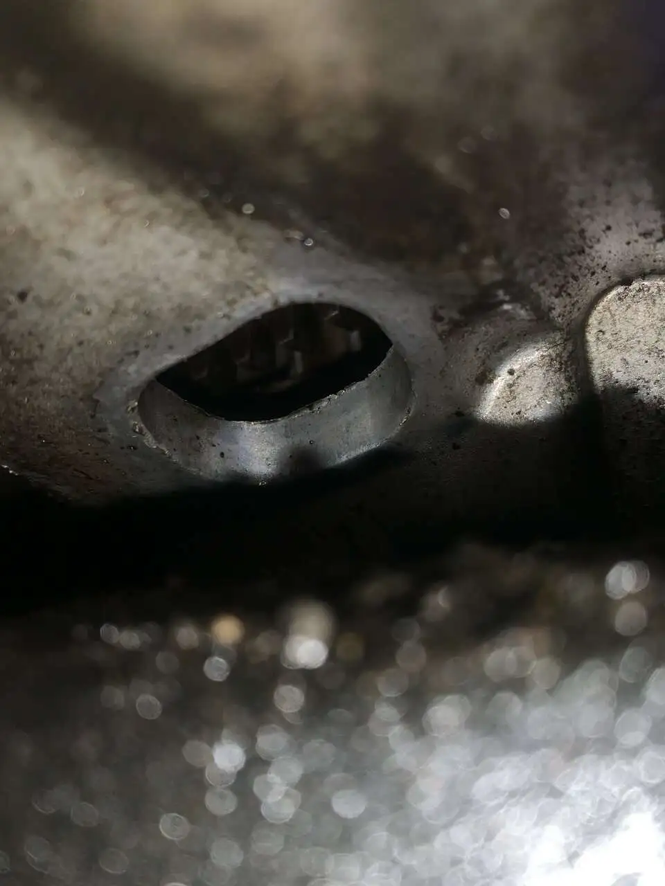

Well everyone, I need some help. I have an oil leak, it’s coming from what looks like either the rear main seal or the main bearing support. I put some of that ultraviolet dye in earlier today and decided to check it tonight. I couldn’t get any good pictures but I need some help figuring out if this is going to turn into a whole engine/tranny removal or it it’s something I can fix on the car. I assume the only way oil can get on my flywheel is through the rear main seal or the mbsp. If this is true then what should I do next. Do I have to pull the trans for the mbsp? Im sure I do for the rear main.
I have a class at school that has everything I could ever need to pull this off and I’m free to go there after school, how long would this take? I’m sure I could do it all in a few days or maybe a week and I would have help but I wouldn’t want to have it out of commission for much more than a week if I can help it
If I have the transmission out and I can get ahold of a manual then I see no reason not to go for the swap if the wiring isn’t too much of a nightmare. If it’s possible I might start getting the parts together and harness and etc put together. it would add def a few more days to the swap but it would unlock a lot of potential out of the car and I would probably get an mp3 reflash if I can get that far. I wanted to manual swap this from day one and I’d like to hear of anyone’s experience doing that and if it can be done smoothly and without trouble
I’ve read it’s worth it to just pull the entire engine out and separate the transmission outside of the car, is this an easier route? Is there anything worth replacing on the engine at 100k miles?
Other than this leak, the car is still coming together, I got it tinted and painted a couple things. There’s still a lot I want to do on it and it’s already getting expensive now that I can’t work full time.
Heres some pics: the flywheel with a drop of oil on it, even though it’s not visible in the picture, the uv light on the bottom of the bell housing, and my rear end ;) it looks nice after painting the valence and refreshing bumper paint.

Oil leak is most likely the rear main seal which is do-able with the engine in the car, just gotta drop the gearbox which can be 'fun'
If you're planning a big service, check your timing belt, tensioner and water pump, check the accessory belts as well
