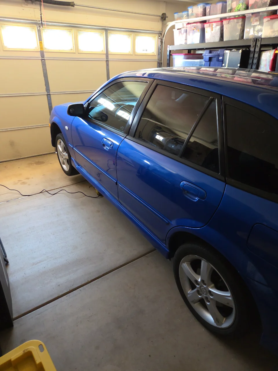

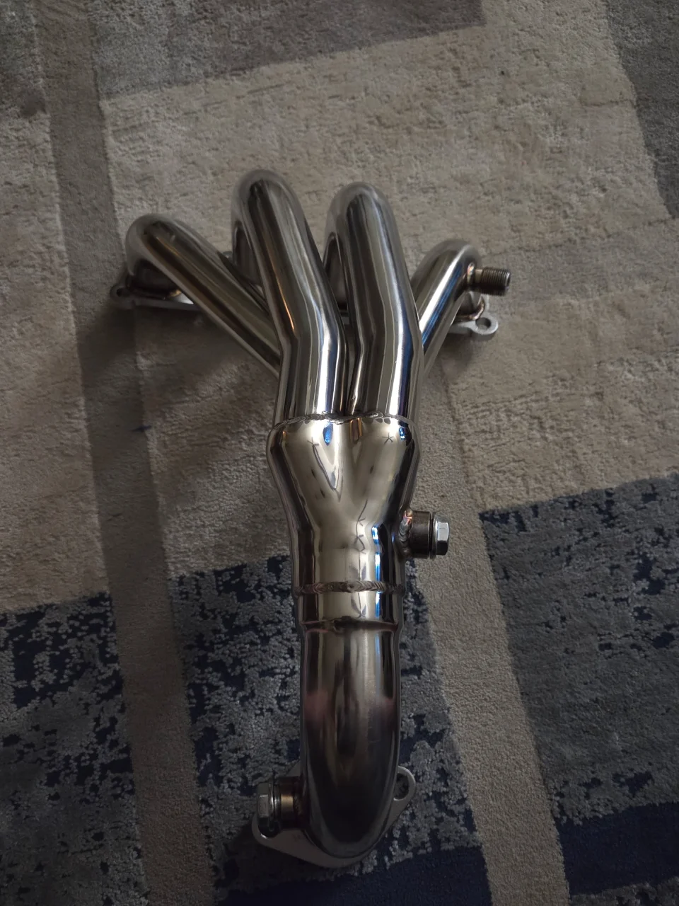

Sorry that happened JD. Also, I have moved from Northern UT. I took the P5, and my family, down to very Southern AZ. I have started in on mods again down here, having just finished the install of headers. Projector beam mod for the headlights is this weekend and coilovers are in the works soon. I'll have header installed pictures shortly. Keep up the good work and don't get discouraged.
Those headers look great! Ill keep an eye on your thread for pics. Hope things are going good since your move and such.
