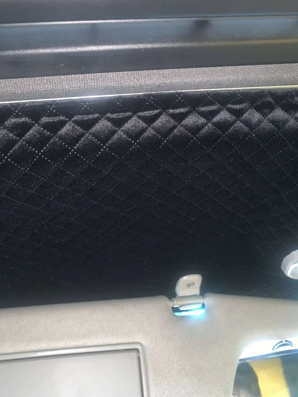

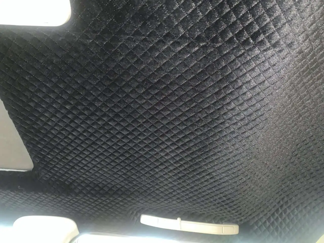

one fancy update, my and my buddy fixed a leak or two in my headliner and while it was out we put the roof rack rails back in, they’re definitely better looking in my opinion, and we put some new fabric on it, i wanted some soft suede, and the diamonds are a different style than the other interior bits, but it came out damn good, i’ll be painting the sun visors and handles today to finish the job.

Daaaaaang that looks good!
How did you attach the fabric, spray glue?
yeah just that 3m headliner stuff

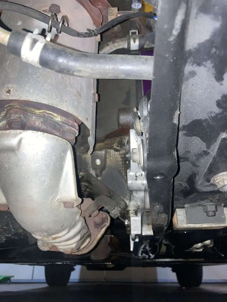

pulled transmission this weekend and replaced the rear main seal. replaced motor mounts and changed oil too. everything looked perfect as it was reinstalling and it went well. triple checked everything. i got the car driving today and discovered that it’s still leaking as bad if not worse than before. while i’m sure it’s the rear main i would like for someone to tell me that i left a bolt loose and i don’t have to take the transmission out again. it was fun and my friends and i had a nice weekend doing it but damn i am sore and not looking forward to it. is there anything i could be missing? everything was perfect going in and it wasn’t a thought in my mind that it wouldn’t work. its also now leaking from the ”front“ of the block near where the motor mount by the radiator is. any advice is appreciated
does anyone have or know where i can find a relatively simple diagram of the mbsp and how and where it seals? it’s starting to look like that’s where it’s coming from. it’s starting to (appear) to leak from an area outside of the where transaxle/engine meet and i think it might be the mbsp. i’ll attach an image of the front of the engine, you can see the bellhousing that i painted purple and it’s coming from the seam on the engine on what looks like both sides. id love some help on this, i would hate to pull the trans again just for it to continue leaking

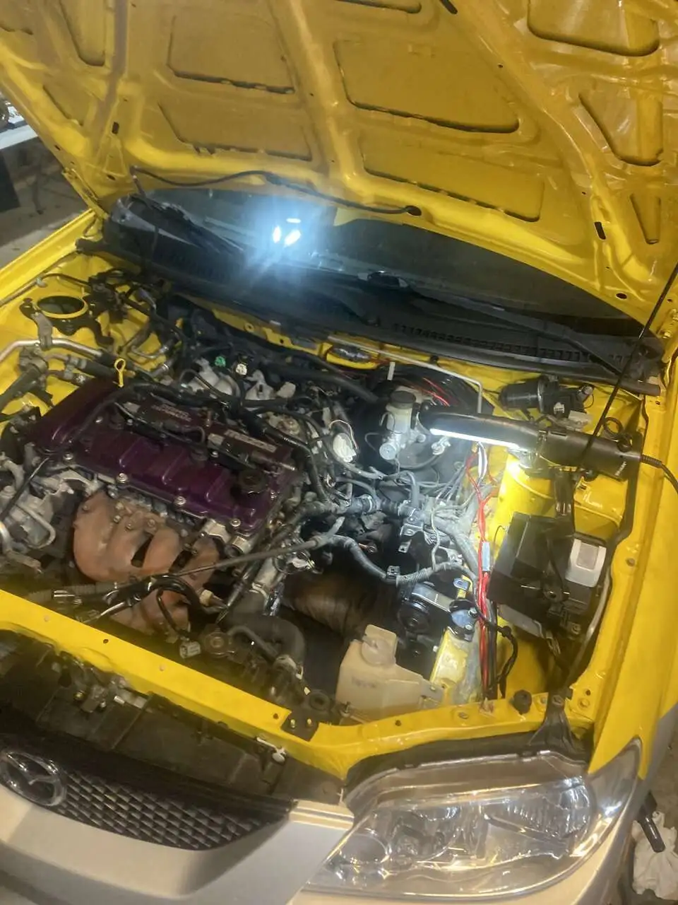

Interesting , never owned a Protege' - the exhaust manifold is on the front side -- with the threes it went to the back -Nice work --bet it runs great !
thanks! it should be when i’m done fixing this leak. i wonder why its flipped, id think it would’ve been cheaper to have a shorter exhaust pipe that runs closer to the rear
Yeah , Mazda obviously agreed- all Maz now have rear exh mani's - ( on inline 4)
but Ive seen many japanese inline 4s that had it in front ...accord etc - great reliable cars. ~ and to this day I cant find a mechanic or engineer that can give me the answer- Ive had to replace many valve cover seals from the heat rise from rear exh mani on my 3s - but it would seem cooling would be better if its in front ?

thanks, its paying off! car stopped leaking (for the most part, still a slight leak but nothing worth pulling the transmission again) and is running and driving great, but maybe the heat is the reason, it would be kept lots cooler in the front and they could’ve switched it around to keep the intake manifold cooler for the later cars?

well well well, i just bought a turbo. after talking to a couple transmission shops and lentech (who doesn’t make any parts anymore) i’ve had some good info on how to do this right. the smart way to do this would be to pop a manual in which is easier said than done, but after pulling my transmission twice, i have some hope that i could pull it off. i have a couple questions: i’ve read that the stock automatic ecu can handle 4psi of boost, i’ve only heard one person say this, but the author of the thread seems to know what he’s talking about. from the transmission shops i’ve talked to, the auto would only be smart to keep at or under 4psi. the transmission is rated for 270 ft/lbs of torque after the torque converter doubles it. this means that 135 ft/lbs of torque is the most that the transmission is rated for and that’s what the fsde makes with no boost. if anyone has any proof that the ecu can handle 4psi please let me know. and do i need an intercooler if i’m only using that much boost? is there any risk to just going for it? is there any transmission upgrades i can do to make sure it’s going to survive even the smallest of boost? aftermarket transmission cooler? for tuning should i use a fmu and o2 clamp? what about emissions testing with the precat removed, i can do spark plug non foulers but would it pass a visual inspection? and should i look into final drive gears? my auto shop teacher told me to sell the turbo and buy a lower ratio final drive but that sounds like less gain for more work. the turbo is going in this car even if it does next to nothing, and if my transmission blows then i’ll do a manual swap. this threads been pretty dead but id like some help deciding what to do here, i did a lot of research and thinking before i bought it and now that i have i’m hearing that i’m going to be going into a much bigger project than i signed up for. ive sifted through so much info and there’s just nothing that gives me a solid answer. if it comes down to manual swapping then i’ll go to the junkyard and start getting my kit together. the turbo isn’t going to go on for a while, so i have time to prepare my car for it.

i’m going to get a new oil pan and weld a fitting into my old one soon, is there any reason i should look for a mazda speed mbsp? those two bolts in the bell housing are telling me i shouldn’t..
