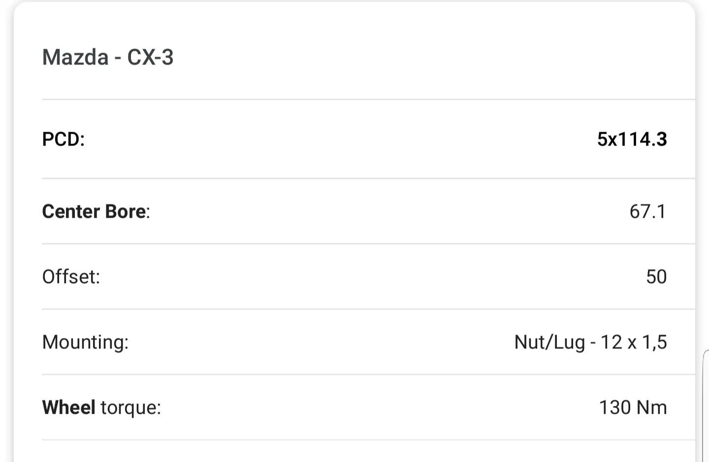

If you are looking to go to a different rim other than OEM take a look at the picture I attached. That is for the 2106 18" wheels that came with the car from Mazda, I am assuming it's the same for your 2019, if not you can always search also the 67.1 Bore is very important because most aftermarket rims have a bigger bore and a spacer would have to be added to keep your rims centered and not from riding on the bolts.
