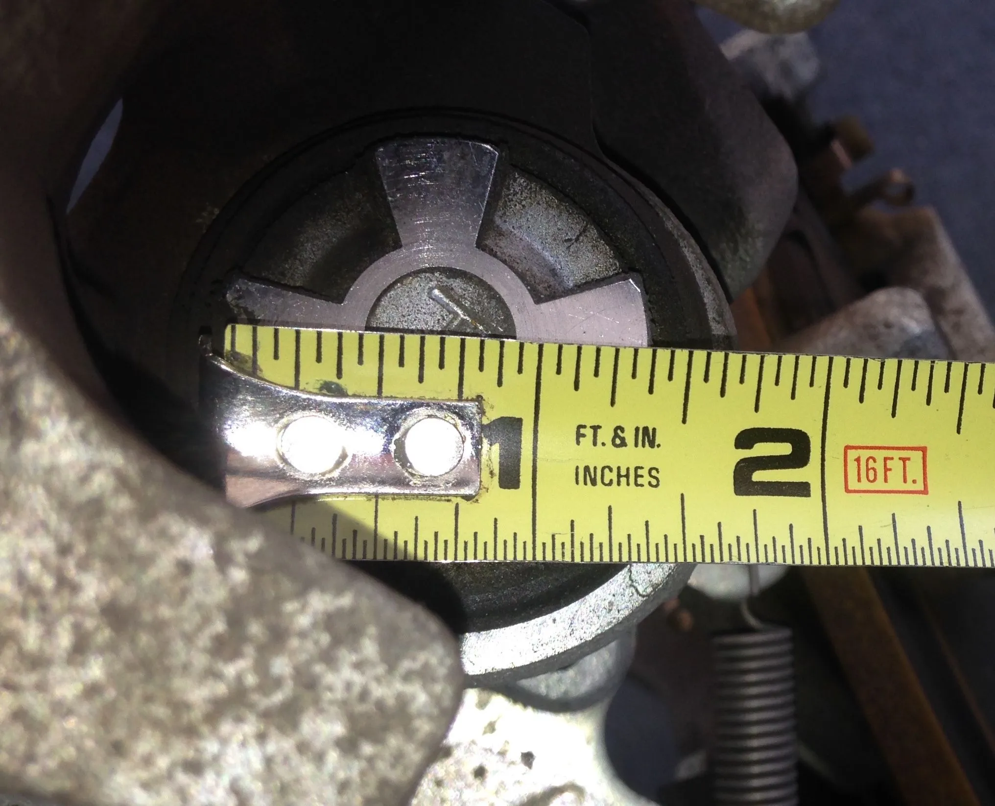

I took the slider pins out. The grease amount seems to be just adequate. I cleaned them and used sil glyde. The bottom pin looked normal and gold shiny. However the top pin felt gritty when I slide it. When I took it out all the shine was gone.
I included a picture of the piston for anyone that will be buying a tool to rotate the piston back into the bore. I found one I like at amazon that is 1 1/4". Which might be just a bit too big.

I went ahead and used Paulstravelspicture guide to check my rear brakes. His guide says to remove the two 14mm bolts on the back of the caliper by turning clockwise. I found that they are normal bolts. It just seems like you are turning it clockwise to remove because the bolt is pointed to you. I don't know if he did this on purpose or just a mistake.
thank you for sharing. I've only owned mostly Hondas and Toyotas and changed the brake pads on many of those makes and have the adapters for most caliper pistons, but never a Mazda. It looks like I might have to buy another adapter for this one... :/
