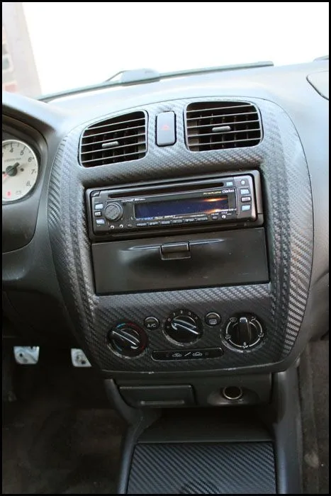

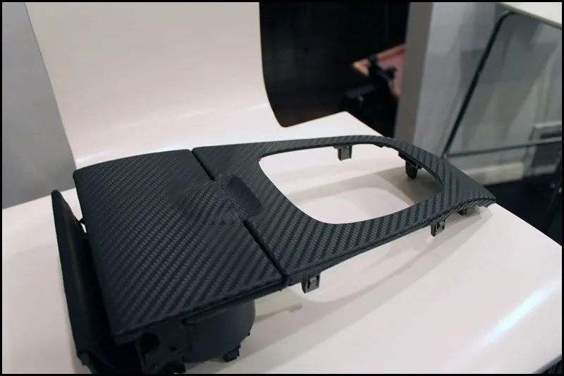

Interior of my mp3 just thought I'd throw these up here. I love the stuff.
