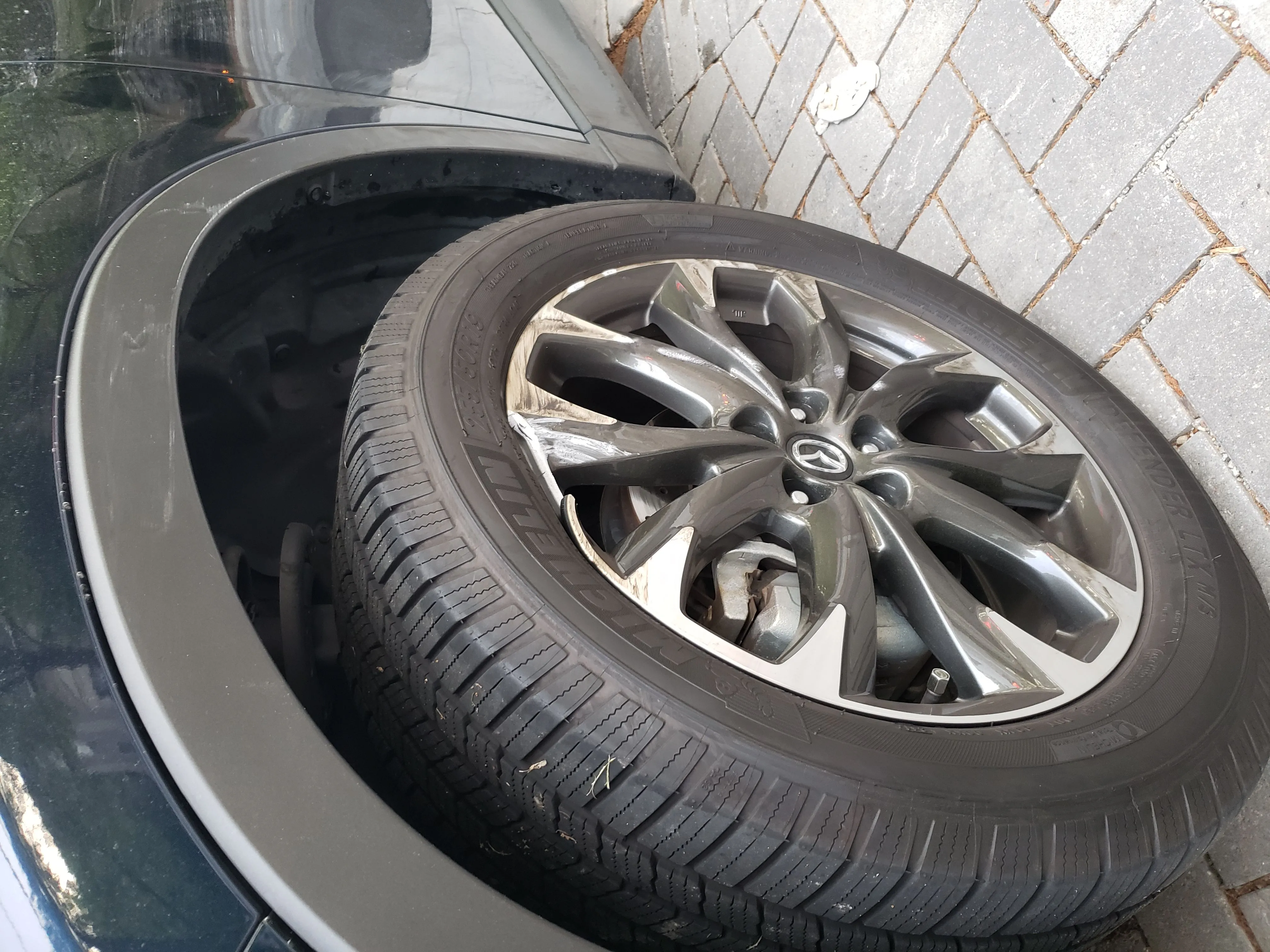

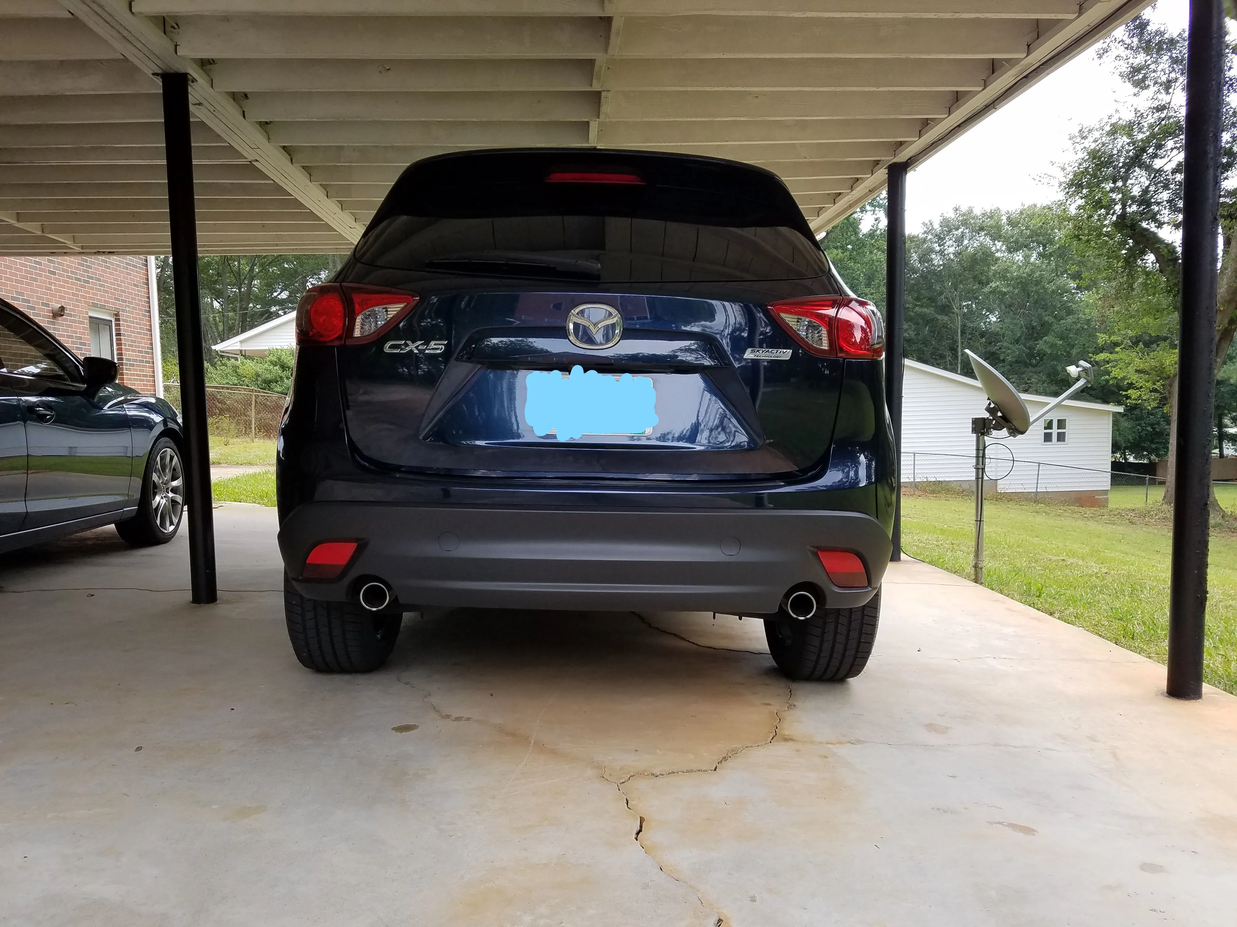

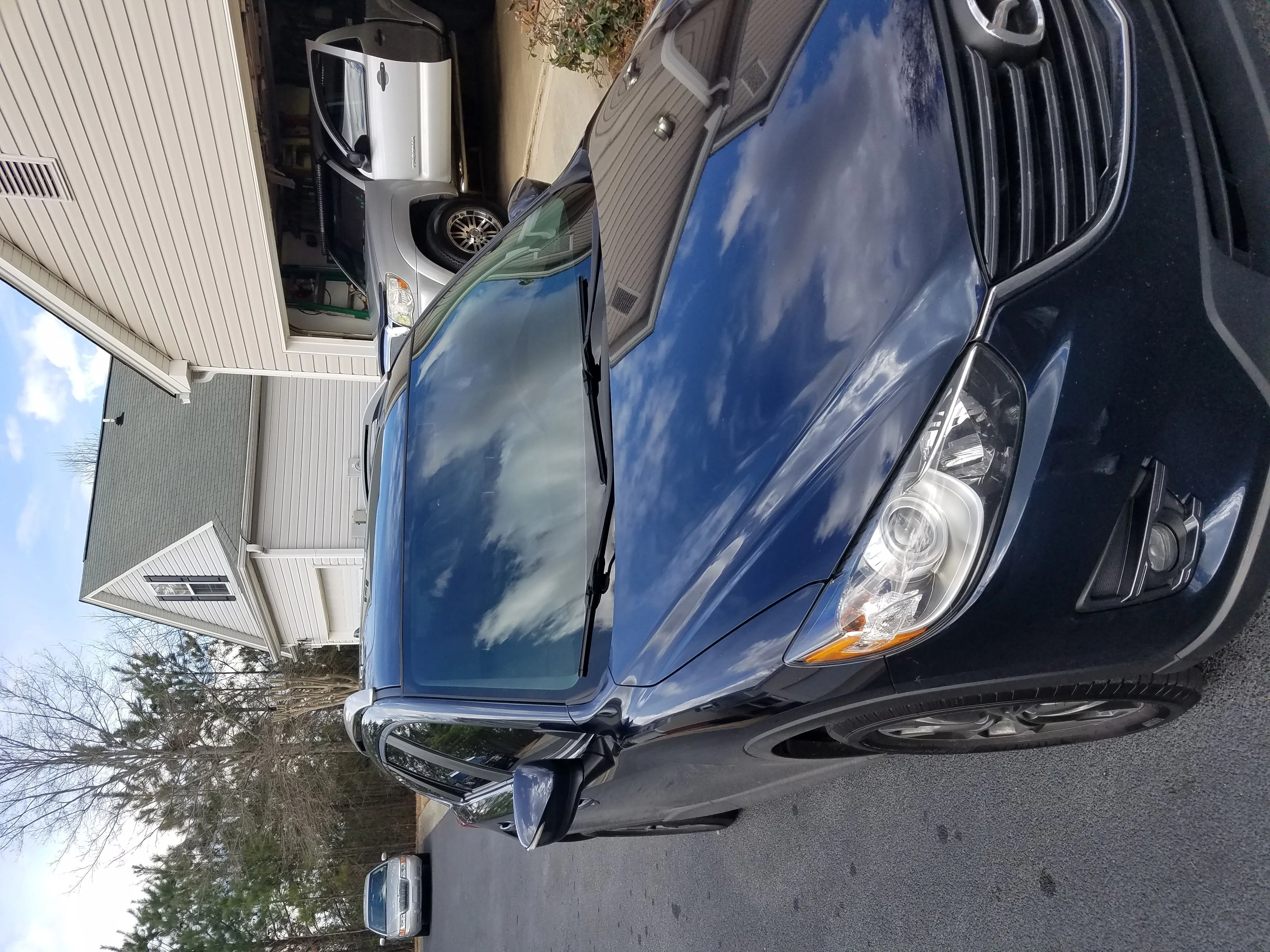

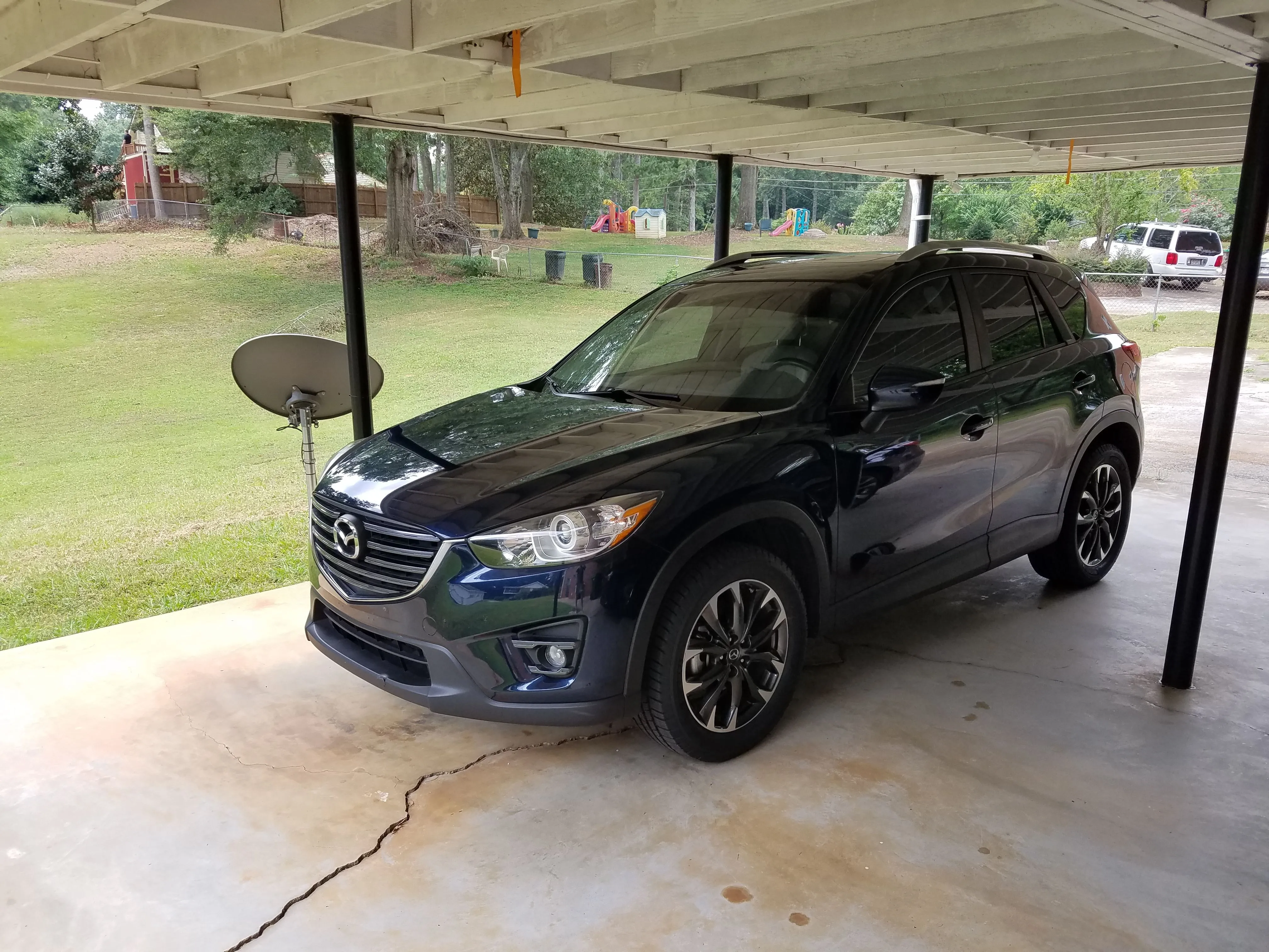

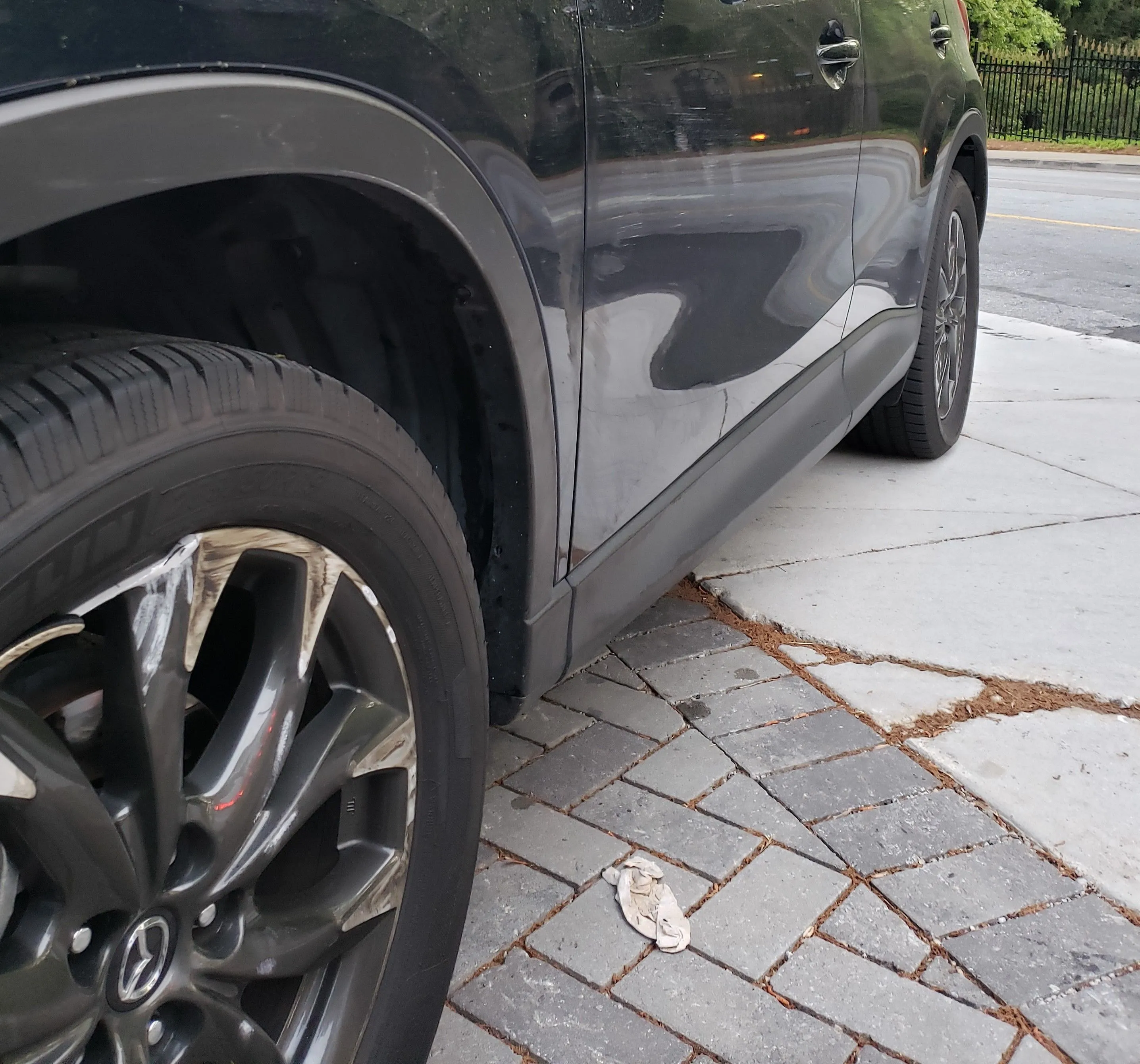

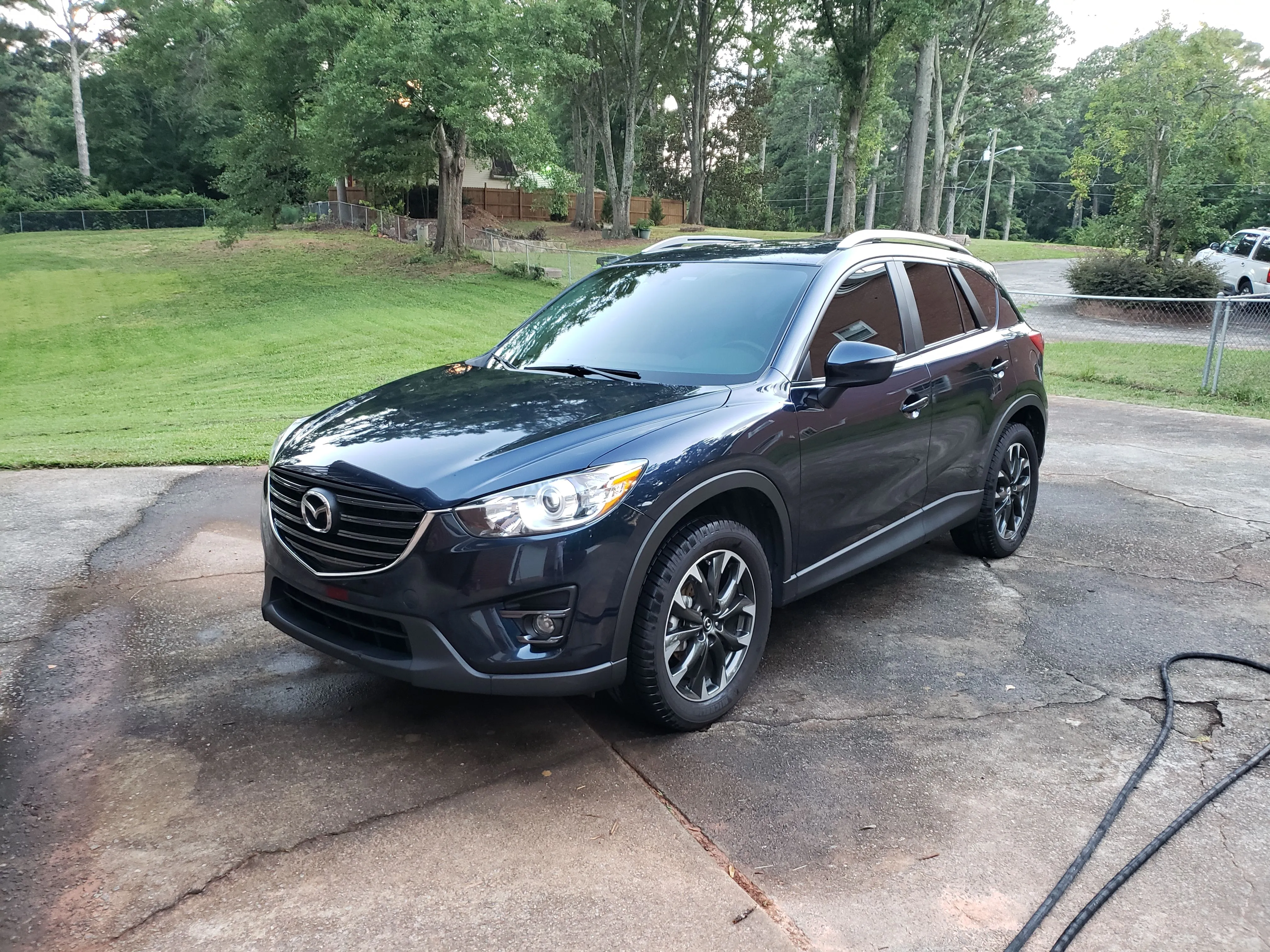

FWIW, on my 16 CX5 GT I ran Michelin Defender 255-50-19. I would not go with any other tire. I was in it for comfort and longevity. I never had issues with rubbing.
Love it. Now that’s enough different from OEM size you might see and feel the difference. I’m guessing that a 255 mm wide tire might recommend a minimum 7.5” wide rim. But it looks good and if no rubbing that’s a nice recommendation.
I was about to walk outside and take more but then I remembered I sold it. I should have taken more pictures of that car. Please don't mind the destroyed wheel, what happens when people aren't paying attention and side swipe you. The last picture is the day I sold it and got my 19 GTR. 255 will fit on the stock rim. You get a little bulge but its not too bad. I ran 36 PSI and never had issues with rubbing or tread wearing unevenly. I can't afford tires right now or the 19 would have the same.
