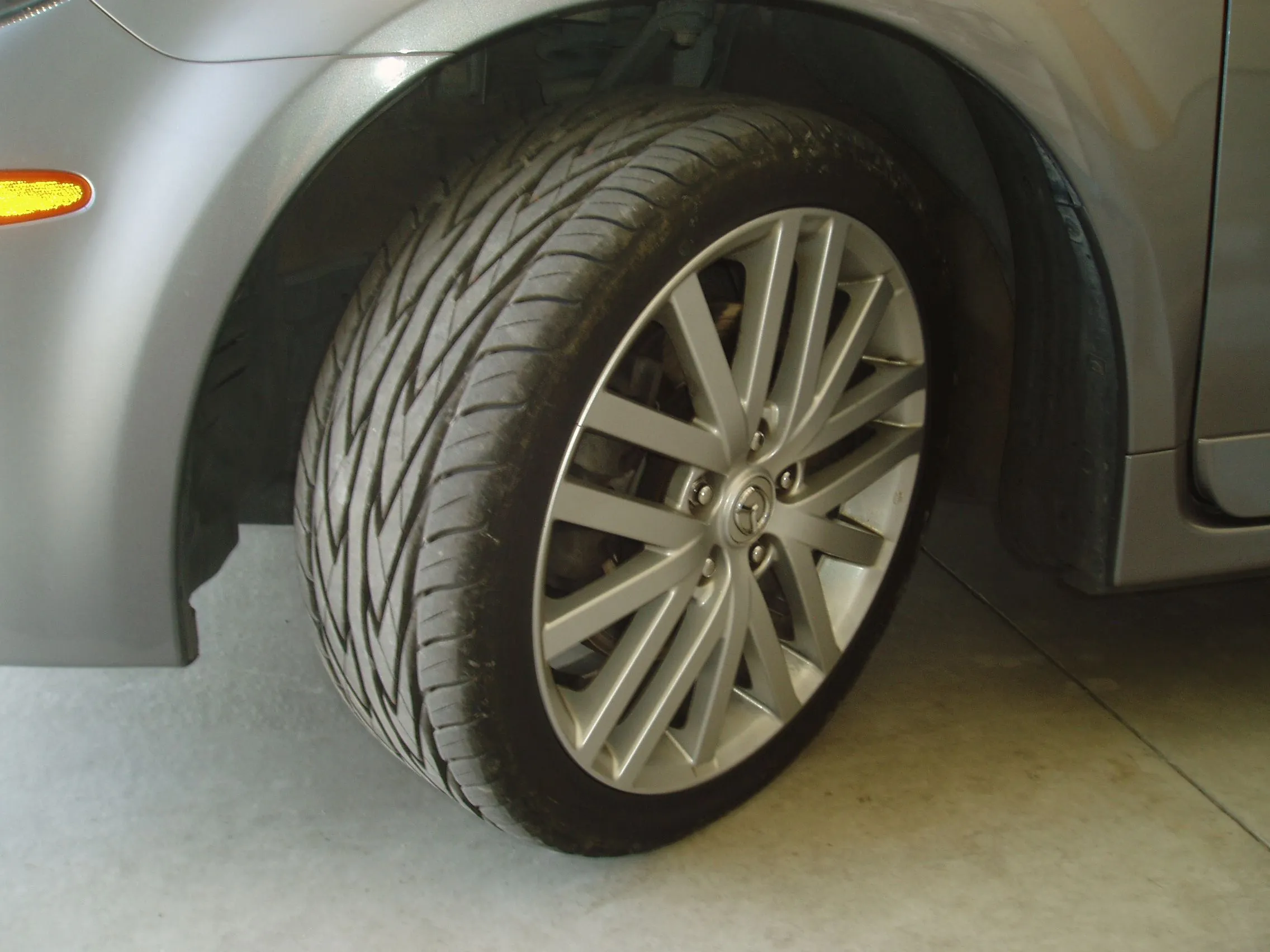

last winter i ran a 225/40/18 winter tire, and also just bought some new Toyo's for the summer. i decided to go with 225/40/18 with those as well. and they don't rub one bit. very nice footprint too, they handle great
Could you post a pic? I'm shopping for tires as well. I am lowered on Megan Racing springs though. I was looking at 225/45 or 225/40.
You will be fine with w/e size you choose unless you are going to mount on 18 x 8 rims... How many inches is the car dropped?
sorry it took forever 225/40R18's on stock rims (wink)

Got the 225's thanks for the input !
Indeed you are right I went and got 225/40/18 and they fit great . I went with Nitto Neo Gen's. You guys might want to check these tires out. They handle great and they are only bout $112 a piece ! .
