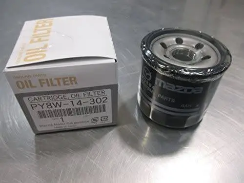

So you bought a new 2021 CX-5 GTR?
The oil filter from factory on 2.5T is Japanese made Tokyo Roki PY8W-14-302. Unfortunately Mazda North American Operations have stopped supplying PY8W-14-302 since Dec. 2019 and it’s superseded by Thai made Denso 1WPY-14-302.
I wouldn’t use Fram filter, as aftermarket oil filters are one size for both 2.5T and 2.5L, whereas OEM’s have 2 different oil filters.
Did you buy the Tokyo Roki PY8W-14-302 filters from Partsouq.com yet? It is $7.75+$5 shipping each to California even if you buy more than one. I also have a Honda Engine mount in cart that is about $40 cheaper. So have you heard of any issues like shipping delays or wrong/non genuine parts? Thanks.

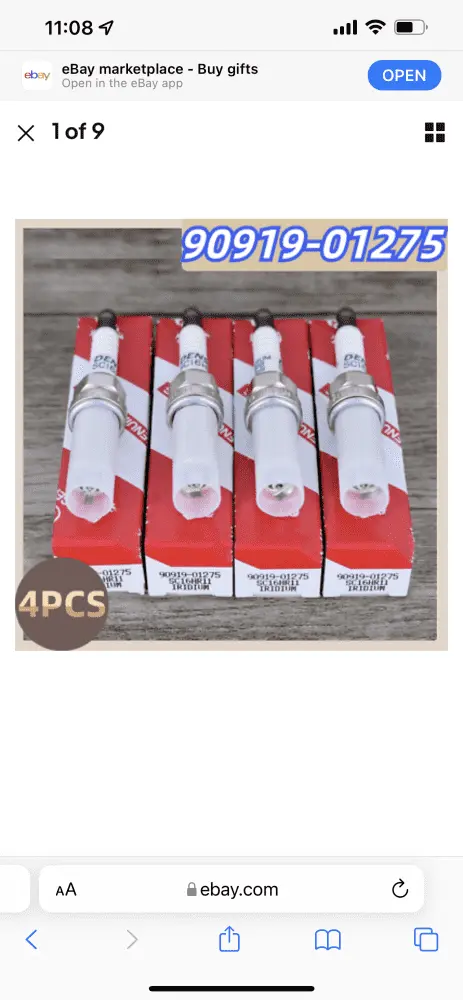

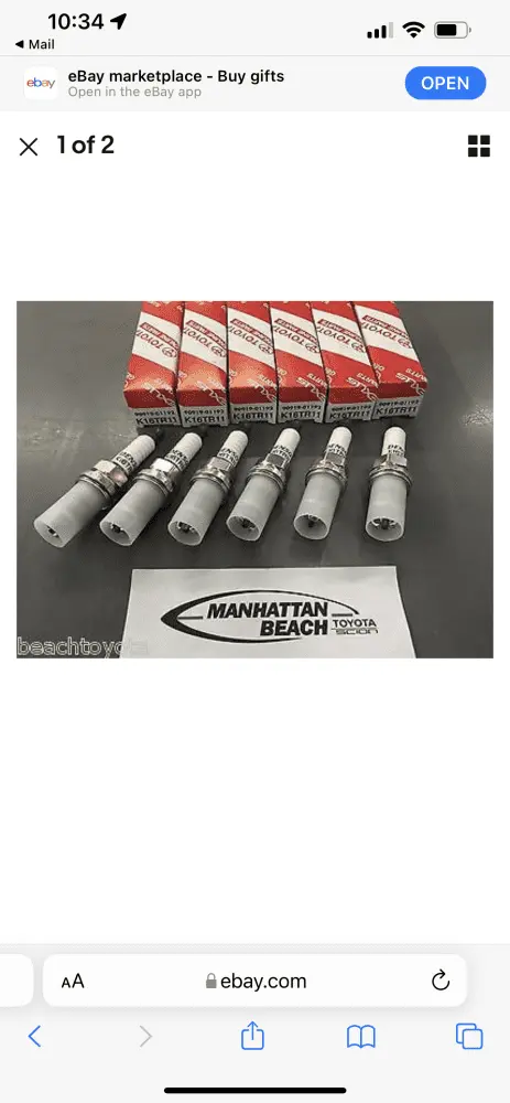

I will, I am going with the actual partsouq.com to purchase Mazda and Honda parts since ebay listing has high shipping. Btw when searching their site I do notice some aftermarket 3rd party parts as well so still have to be careful when ordering/receiving.
Btw on ebay there are a lot of fakes. One example is with Toyota packaging like the red spark plug boxes below both from ebay listings:
Are they both legit or ?
I know a lot of NGK fakes on EBay and Amazon . . . you photos are too small on my 30" monitor to notice any difference if any.

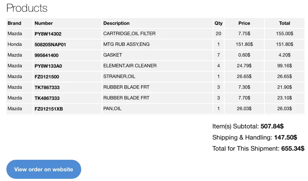

Man I just spent $600+ at partsouq.com hopefully no issues! I paid with paypal incase since it suppose to have free return shipping lol

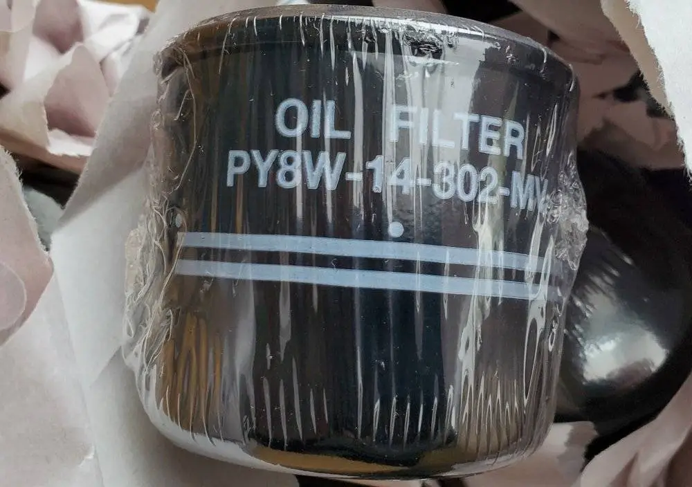

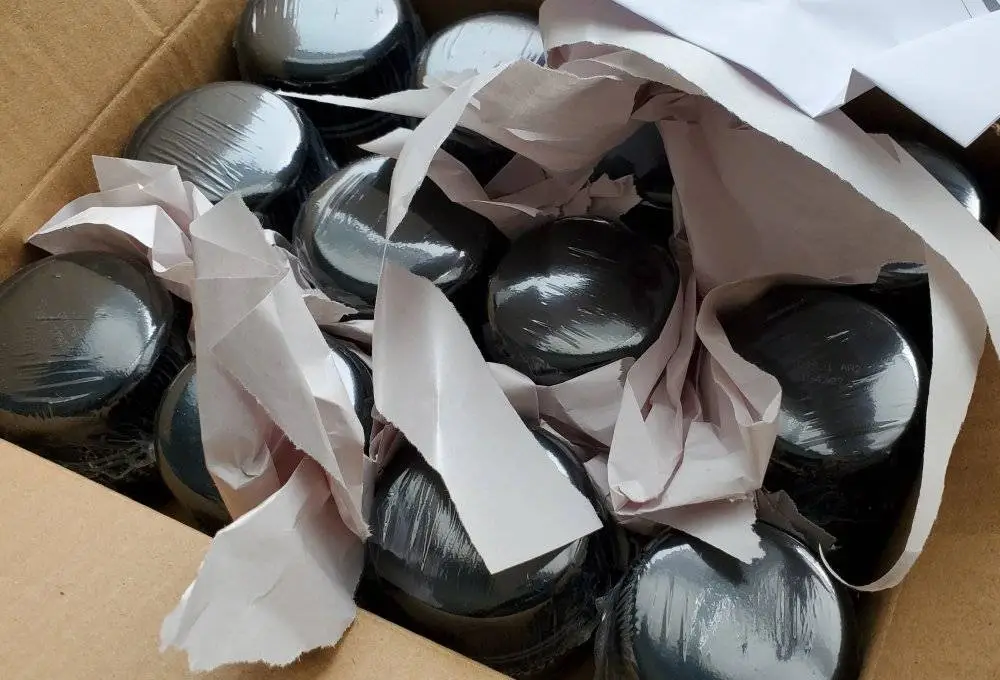

I bought a case of 1WPY-14-302 oil filters from an online source and paid accordingly. But they sent me the cheaper PY8W-14-302 oil filters made in Mexico. Returned and got full refund.
View attachment 306635View attachment 306636
The PY8W-14-302 are the genuine Roki Japan made filters for the 2.5T which are the best filter but the ones you received look like fakes because they do not come packaged like that. The real ones come sealed in a Mazda OEM box with a single plastic seal on the top gasket of the filter inside the box. See pic. Definitely not shrink wrapped like that. My suggestion is to buy from partsouq.com for genuine goods. The 1WPY part number is for the Thailand made by Denso filter which is also legit.
Edit: the MV designation after the part number is the Mazda value line made in Mexico filter but the part number PY8W-14-302 is no longer used except for the Japan made filters I believe so it's a little fishy and the way they are just shrink wrapped seems strange even if a value line filter.
You’d got Mexican made Mazda OEM PY8W-14-302-MV “Value” oil filter which is different from Japanese made Tokyo Roki PY8W-14-302 oil filter. Tokyo Roki PY8W-14-302 oil filter is installed on the 2.5T from factory, and it’s also available in most countries worldwide.
If you order “PY8W-14-302” oil filter from a legit foreign Mazda parts supplier such as Partsouq.com, you should get Japanese made Tokyo Roki oil filter.
Upvote 0
PY8W-14-302 filters are still made in Mexico and sold at your local Mazda dealers.
This’s incorrect. Again, “PY8W-14-302” is a legit Mazda part number worldwide, and it’s the Japanese made Tokyo Roki oil filter.
Cheaper “Value Line” “PY8W-14-302-MV” is a different OEM oil filter for the 2.5T and it’s made in Mexico.
Mazda North American Operations stopped offering PY8W-14-302 in the US since Dec. 2019 and it’s superseded by Thai made Denso 1WPY-14-302. Later MNAO started offering cheaper PY8W-14-302-MV filter in its “Value Parts Line”, and been used by US Mazda dealers for oil change for lower cost. If you want better Thai made OEM Denso 1WPY-14-302 oil filter for oil change at a Mazda dealer, you need to specify it in advance, or you’d be disappointed as you’ll get “Value” oil filter. :rolleyes:
Based on member’s experience here and 98.9% positive feedback on eBay (was 99,6% a year ago), I believe Partsouq.com should be a good foreign source for OEM parts with fast shipping. Their price definitely is attractive even with additional shipping charge.
Why you need an ATF pan for your CX-5? :unsure:

User SillyWabit recommended a new transmission oil pan instead of scraping the old gasket since it was a pain to do when he changed the transmission filter and oil:
Saves time and effort. The filter and pan should be same for 21 cx-5 Turbo as well from my research. Btw Partouq.com just created a shipping label for my whole order today via DHL at 28 pounds of parts so hopefully no issues.
