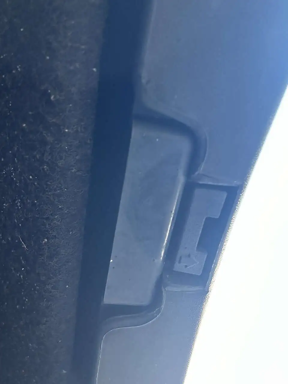

Anyone remove and replace the driver side rear wheel arch trim on a 2018 cx5? I think 2017/19 are the same. I have a couple of fasteners that broke off it and so it needs to be replaced. There is what appears to be a latch around the top of the trim, not sure yet how that is removed. I’m guessing otherwise it’s just a matter of pulling off the trim, inserting new fasteners and popping back on, but wanted to see if anyone has done it. I see videos for the front, but nothing for the rear, which is different.

There is this tab on mine toward the top of the arch. How is that removed?

Can't say I recall seeing such a tab on my wheel arch. Perhaps the 2018 version is different from the 2020.

You can check the tab cut off area of the new arch trim and compare. I believe the tab has nothing to do with holding the trim. You can push or pull the tab toward the direction of the arrow and see if the tab would be falling off by itself.

The rear arch trim should be the same between 2018 and 2020 CX-5. The only thing could make the difference is the color black of the aftermarket trim from eBay can look a bit different from the OEM one.
