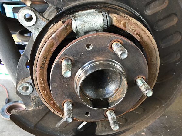

my '13 Mazda CX9 has a separate parking brake (actually all Mazda 2007-2015 CX-9's have them), see picture below, the CX-7's also have them, I think in the old days Mazda Mellinia and MPV had them too.
OP is right, freaking thing is a hassle, my own stupid fault for going to Mavis discount tire to get rotor changed, stupid tech forgot to release parking brake before getting the car on the lift, he thought the rotor was rusted on the hub and started banging away the rotor eventually popped off but not before taking the parking shoe with it, tech had to re-install it by adjusting the gear dial wheel on top of the shoe. The parking shoe kept rubbing against the inside of the rear rotor hat, had to adjust it three times until it was just right, real big hassle because the rotor has to come off to adjust the wheel dial which means the whole caliper assembly also has to come off

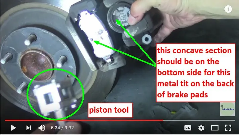

A difference you will find with cars with brake pads as parking brakes is, you will have to turn the piston as you are pushing to retract the piston. You just can't push it in as you would the front brakes or rear brakes on cars with separate brake shoes for parking brakes. So when it comes time to replace the rear pads it is best to use a tool that turns it at the same time as pushing. They are not expensive, or one can be borrowed from a parts store loan a tool program.
this is a good point, does anyone know for certain if the brake pistons for the CX-5 rears can be just pushed back or do they need to be turned
