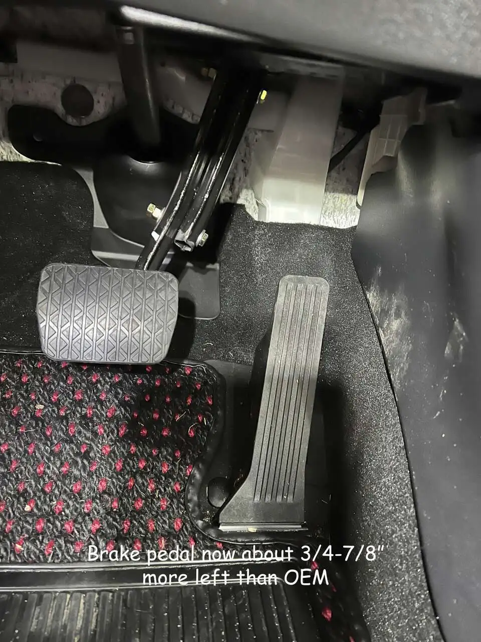

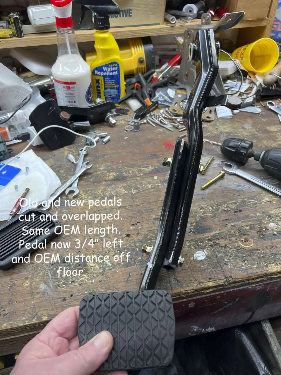

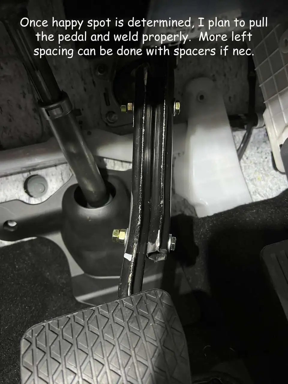

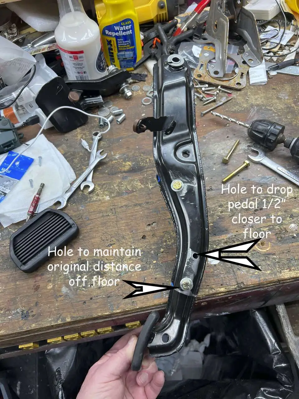

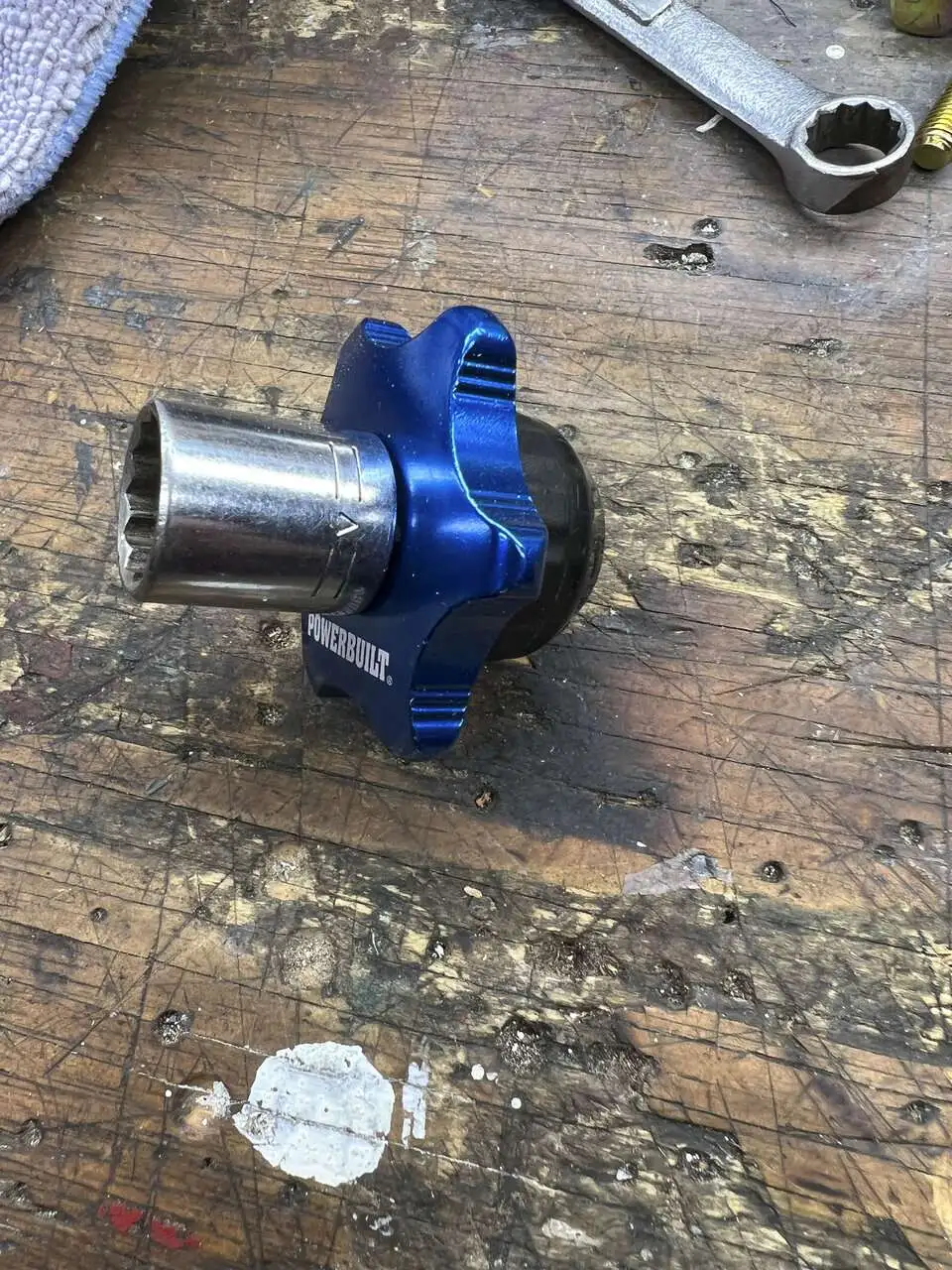

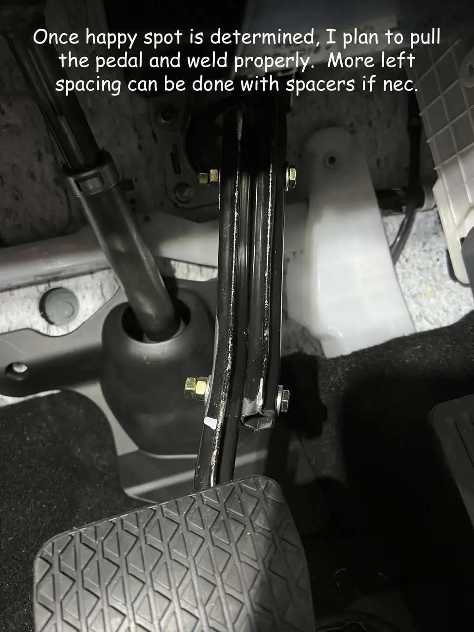

2023 CX-5. I found the pedal positions to be 'not to my liking' so as I have done to previous cars I modified the brake pedal position. I purchased a second brake pedal via ebay. Then removed the OEM pedal. Pull the clip and rod to the brake booster, remove the pivot nut and bolt and it pulls out easily. I cut both pedals appropriately, layed them side by side and drilled holes. I made two holes in the lower part to allow and easy adjustment that would lower the pedal foot pad 1/2" closer to the floor. I bolted all this together and reinstalled into the car. The brake foot pad is now 3/4-7/8" more to the left and the original distance from the floor. I drove it around the block and was immediately very pleased. I have moved the lower bolt to the other position which lowered the foot pad 1/2" closer to the floor. I have not driven it yet with this configuration but just sitting in the garage I feel I'm really going to like it lower. I'll drive it a couple of days to confirm, then pull it out and weld it properly. Pics should help. If you take your pedal out for any reason I very much recommend a finger ratchet for the pivot nut, once broken loose it does not spin off easily and a "good" LED headband light.
