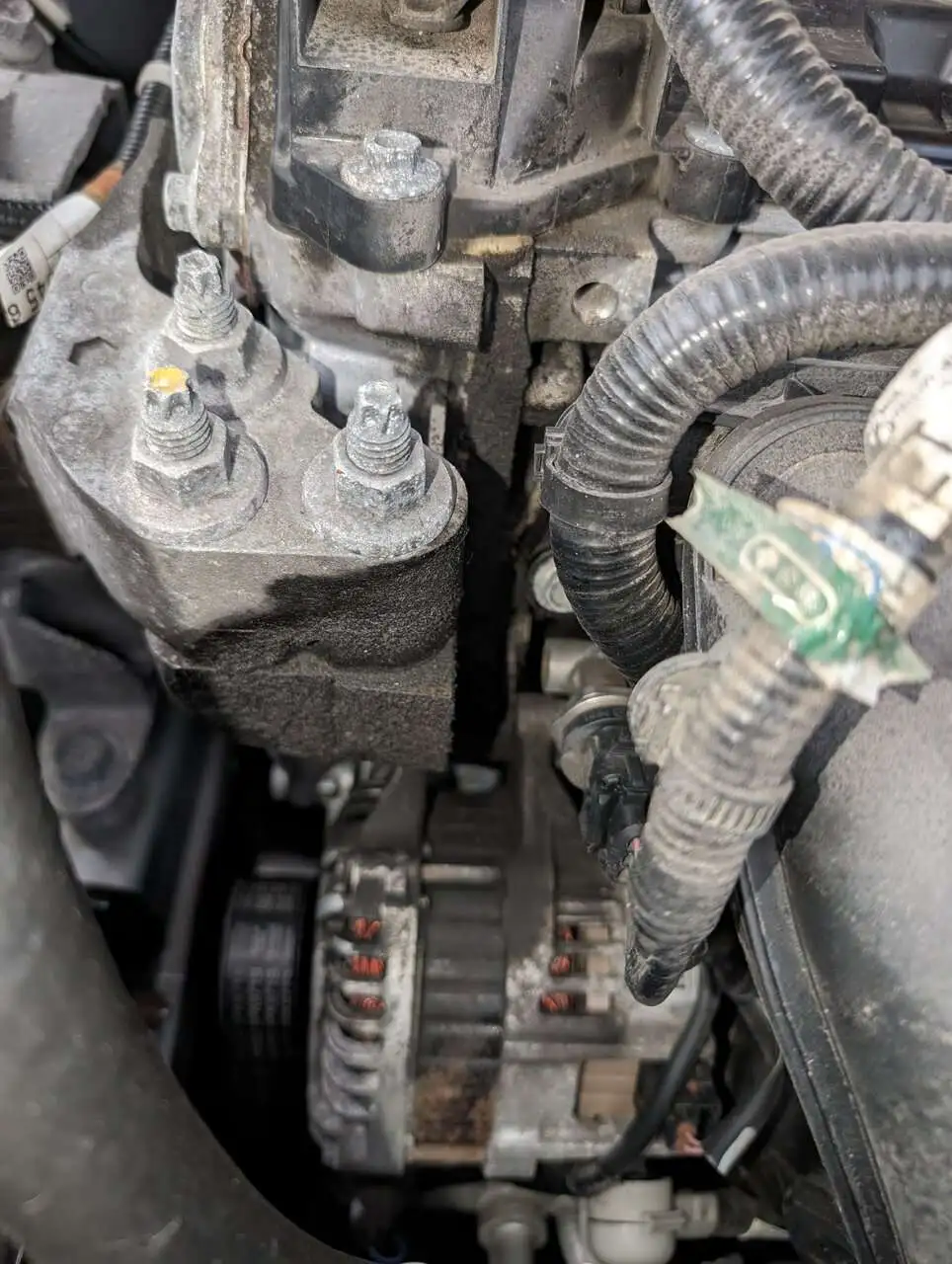

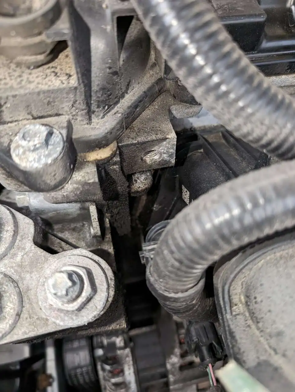

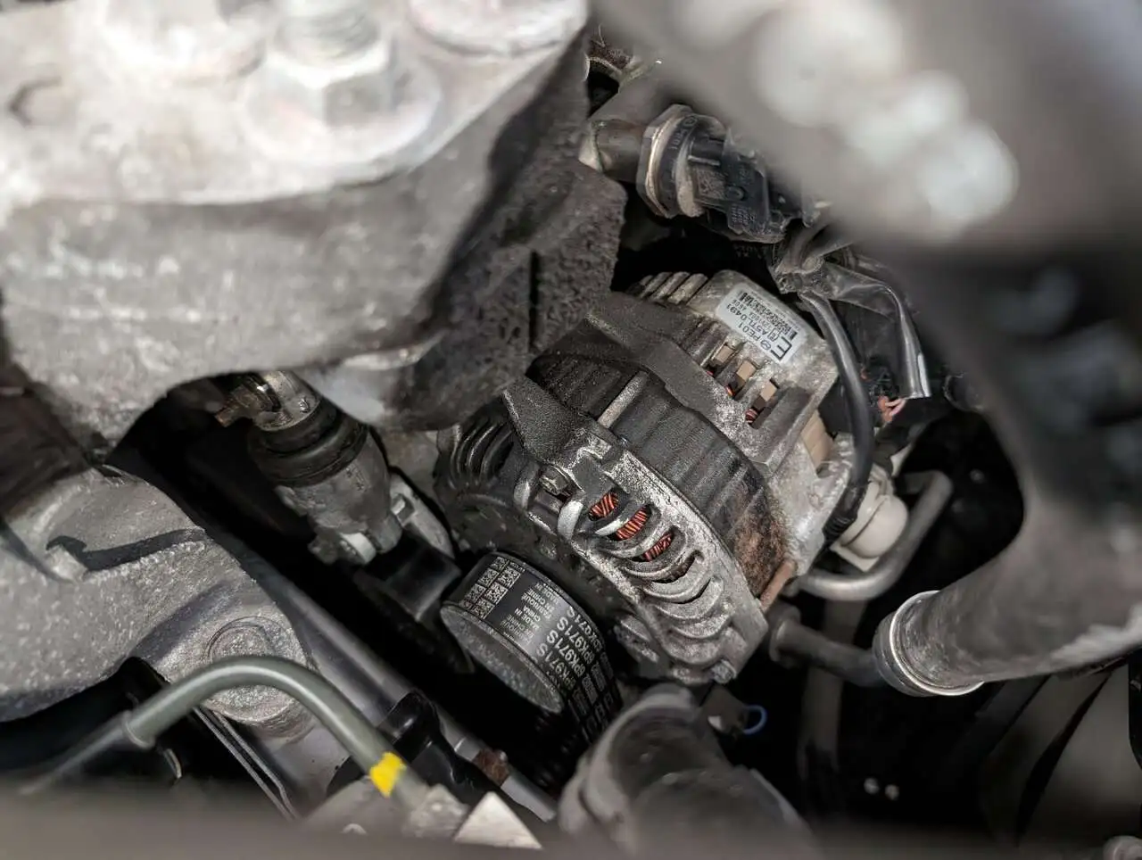

I just got a used cx5 with 125k miles on it. Wen poking around I noticed some oil built up on the engine. I have attached some pictures.
There was a similar post but it looked like it turned out to be his tensioner causing the problem? Or something like that. It was slightly different.
So what do you guys think it is from? The top by where oil would be put in is clean so I don't think it would be from someone missing when filling the engine back up after an oil change. Thanks for the help in advance!

The more I look around, that sounds correct. Would you (or anyone else that sees this) suggest wiping it up and seeing how fast it comes back? Or leave it and see what a shop says. I have a total warranty that should cover this so that makes me feel better.
I don't have much to say tbh. I personally have a difficult time chasing leaks unless they are obvious. Cleaning helps. I would clean up the area and buy something like a UV Leak Detection Dye. I would spend a few minutes and try to find the areas using the dye and a UV light to see where I think it is leaking from. Then I would take it in and have the warranty service to see what they say. I would also re-read over the fine print to see what they cover.
Seems like Timing Chain Cover issue to me also.
My '14 Mazda3 has this issue... Not fixed. Dealer wanted $1700 for it 2 yrs ago.
I just clean it once in a while and monitor it.
No oil on the floor. No worry from me.
My '14 Mazda3 has this issue... Not fixed. Dealer wants $1700 for it 2 yrs ago.
I have the same thing on my '14. Some seepage/greasy smudge behind the water pump. No leaks, not wet. Not worried.
You might want to closely check that "total warranty". They are not always "total" and have deductibles (maybe multiple for one job) and have the customer responsible for the difference between what the repair shop/dealer charges and what the warranty company pays. Not to mention exactly what is detailed out in writing concerning parts and labor covered.

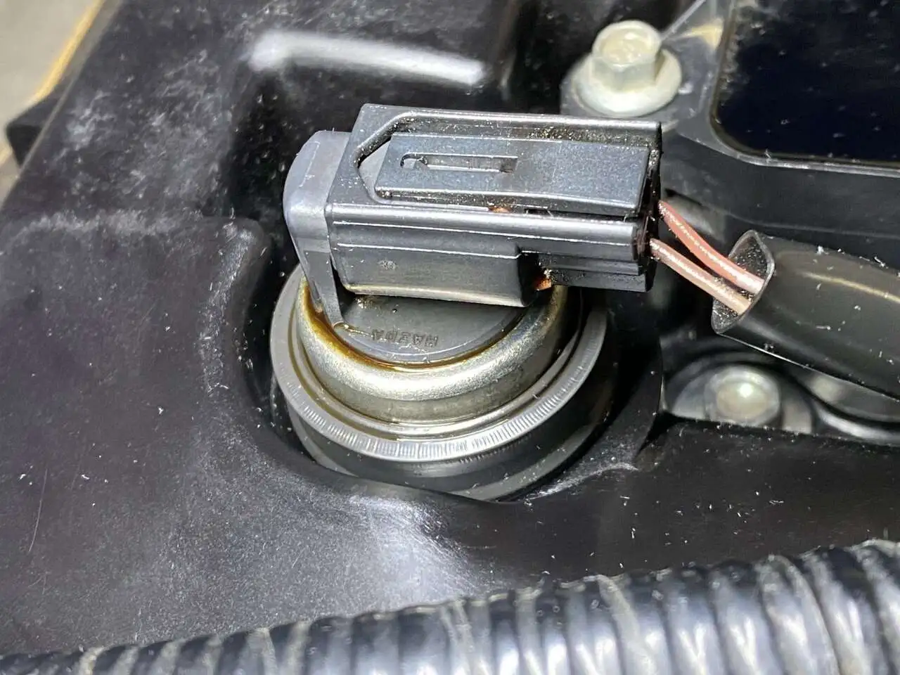

It could also be the problematic Oil Control Valve which is on top of the engine leaking:
⋯ also, after getting the ATF up to temp, my OCV looked like this. Guess I’ll look at getting a replacement. Would I need to change my brand new valve cover gasket again also?
Fortunately I haven’t been bit by the oil control valve leak and my tensioner is leak free as well
