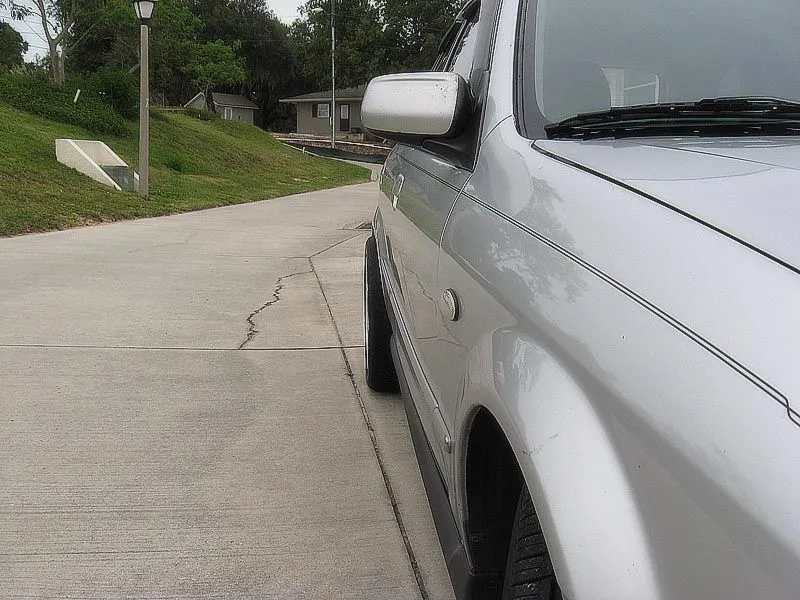

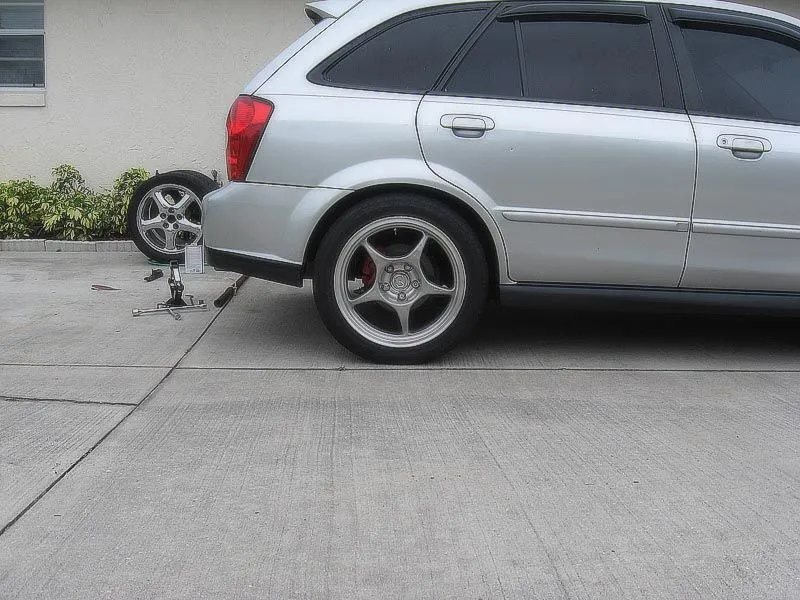

well, for the record, 17x9 ET38 rims DO fit on the MP5, even with 245-45-17 tires on them, at stock height, stock suspension.
there would definitely be clearance issues with the fenders though as they stick a good inch beyond the fenderwell.
with a 40 profile tire you could maybe get away without rubbing issues, but if your dropped even a little, chances are you would see some heavy rubbing without a very stiff suspension.

yea, they do stick out quite a bit.
Im not going to use them, too much work that Im not prepared to go through to get them on without problems.
probably
if I was to use them, Id get the widebody kit from DGM, and then Id have to get coilover's and run those much stiffer than Id prefer for a daily driver, Id also need to get either 40's or more likely 35's to make sure of no rubbing issues.
I bet they would make awesome trackday rims though.
